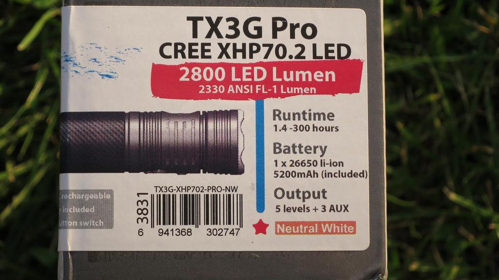

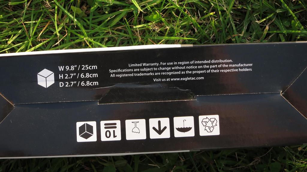

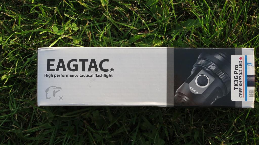

Packaging like this EAGTAC is sometimes quite minimal, with no splashes or unnecessary marketing "gibberish". The most important information - power supply, used diode or light color.

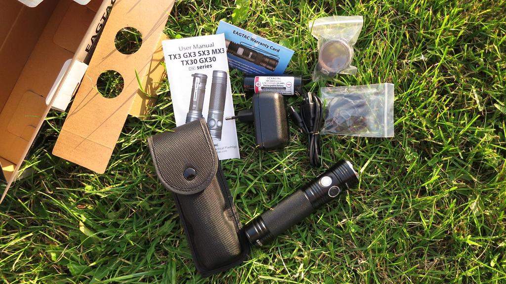

Included with the flashlight we get:
- link 26650 with a capacity of 5200mAh (I got 5500mAh, although the manufacturer has information about the cell 5200mAh)
- diffuser

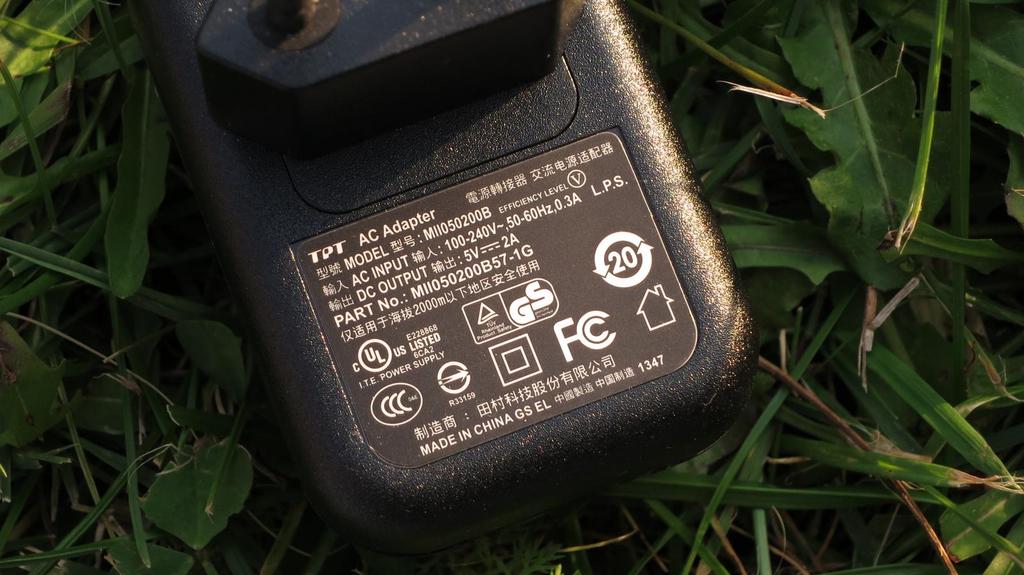

- 5V / 2A charger
- USB C cable
- spare eraser and O-ring
- leash on the wrist

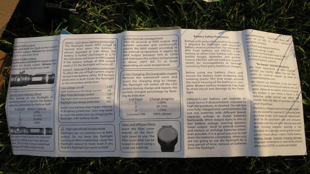

- instruction manual, warranty card
- very well made, additionally reinforced holster

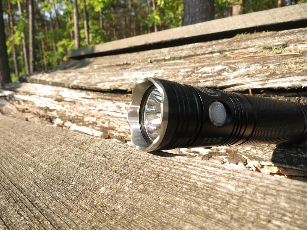

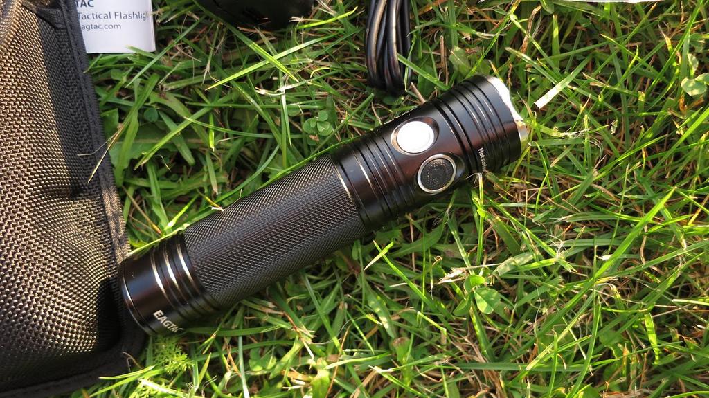

The TX3G Pro can be called compact. It is not the smallest flashlight in the 26650 flashlight class and it does not even try to be that way. It's just a well made flashlight, controlled by two buttons covered with shiny anodization.

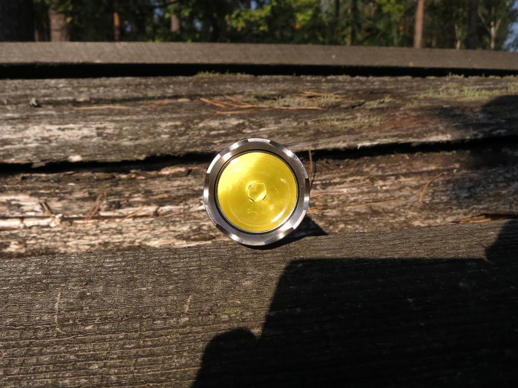

From the top metal lace, fast with AR coatings, SMO smooth reflector and XHP70.2 diode, there are two diodes to choose from: cold and neutral. I recommend the latter

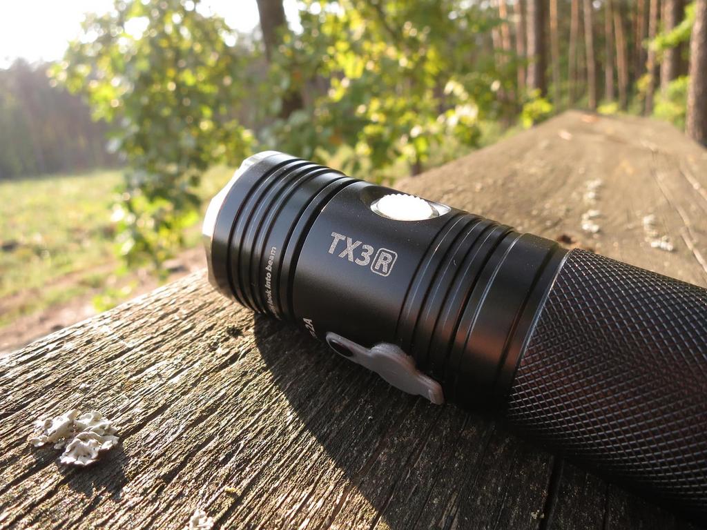

The head at the top is a bit wider, which can be seen even in the picture. Head with a delicate ribbing, well made, looking for buttons in the dark - almost imperceptible (ribbing).

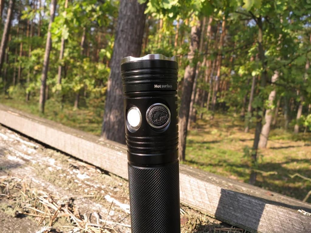

The producer has put a warning that the flashlight can be "hot" and ask not to turn on the flashlight (from above).
Sometimes you can go wrong looking at the EAGTAC flashlight markings. The tested model is TX3G, on a large bold case - TX3 and R in a border.

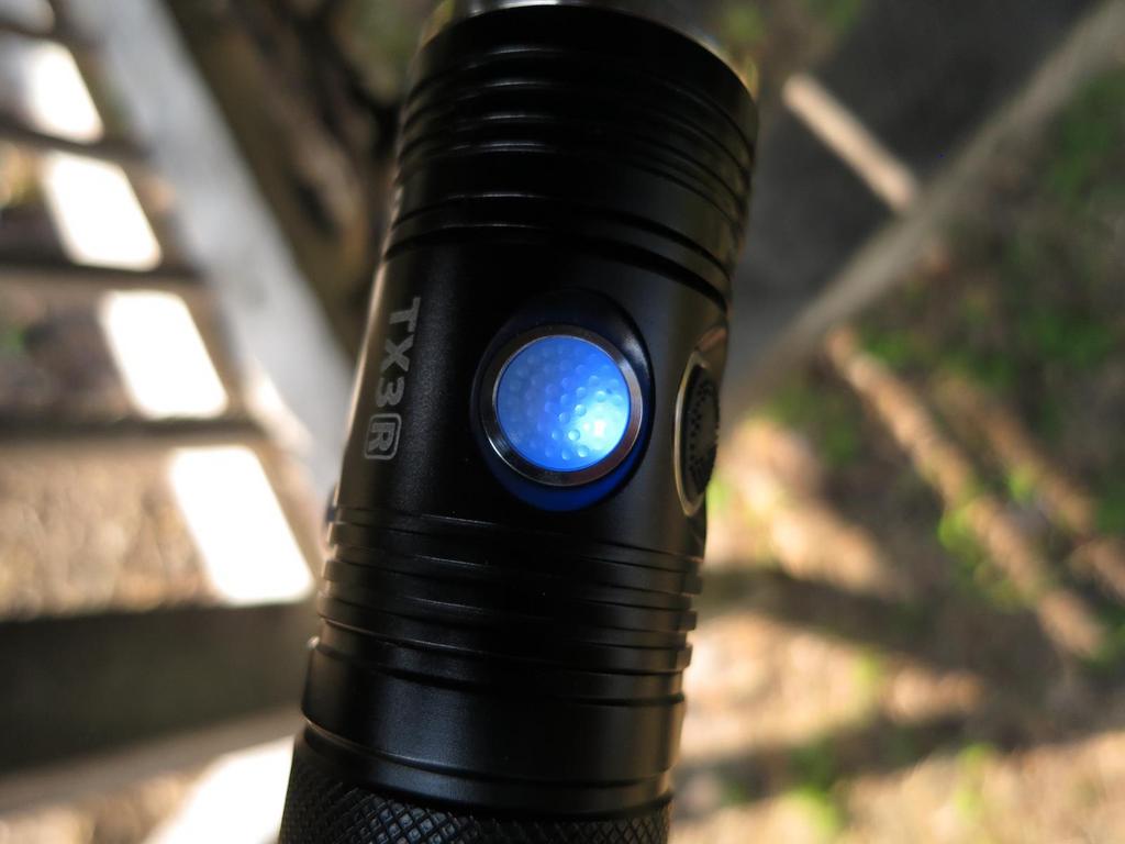

To control the flashlight we use two buttons - white (change of modes) and black (always activates the flashlight in TURBO)

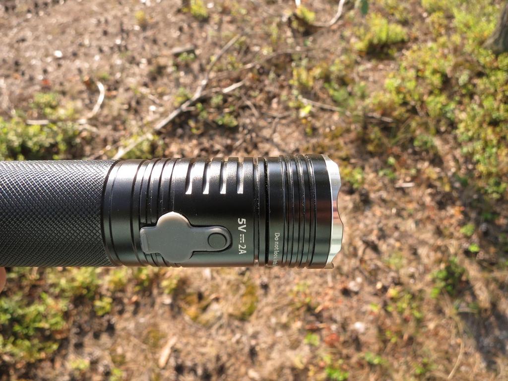

"On the other side" USB C port - performance up to 2A, while charging the white button flashes in blue. The blue color is very intense and if you want to charge the flashlight in the evening, it's better in a place where there is no one. When the charging process is completed, the blue LED starts to illuminate continuously.
And here is probably a small error in the software - even after disconnecting the charger, the blue LED will not stop lighting, we have to click one of the buttons, which is related to the inclusion of the flashlight.

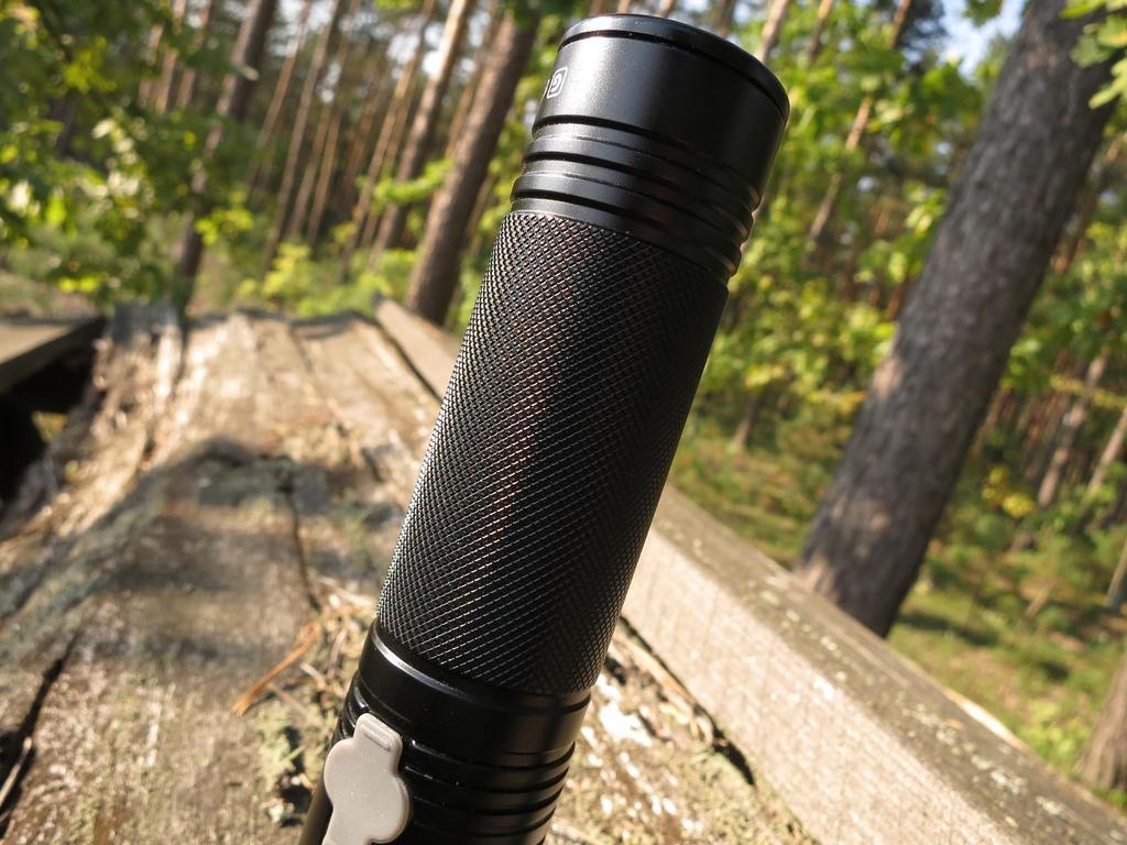

Knurling of the middle tube - delikane, hardly perceptible

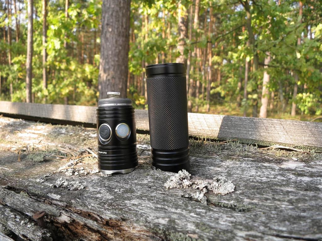

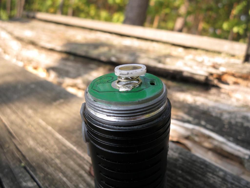

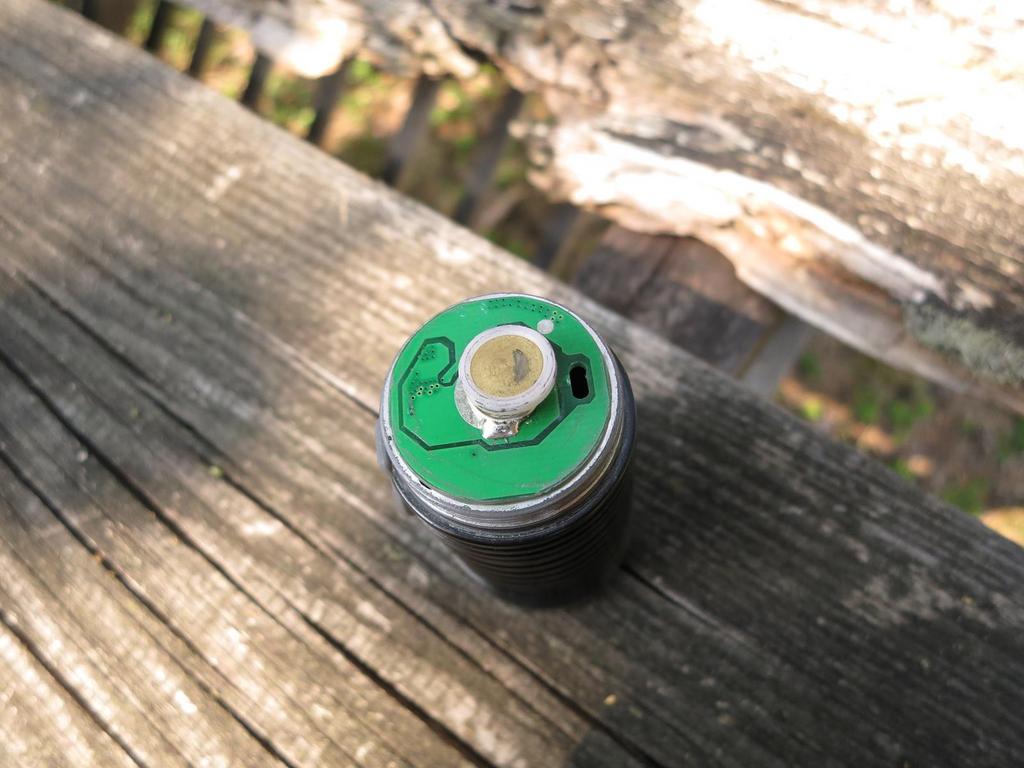

TX3G consists of two main parts - a head with a diode and a controller, and a central tube housing 26650 cells

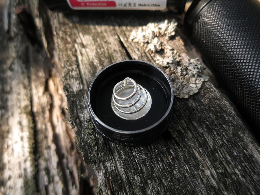

Cap with silver spraycan - EAGTAC standard

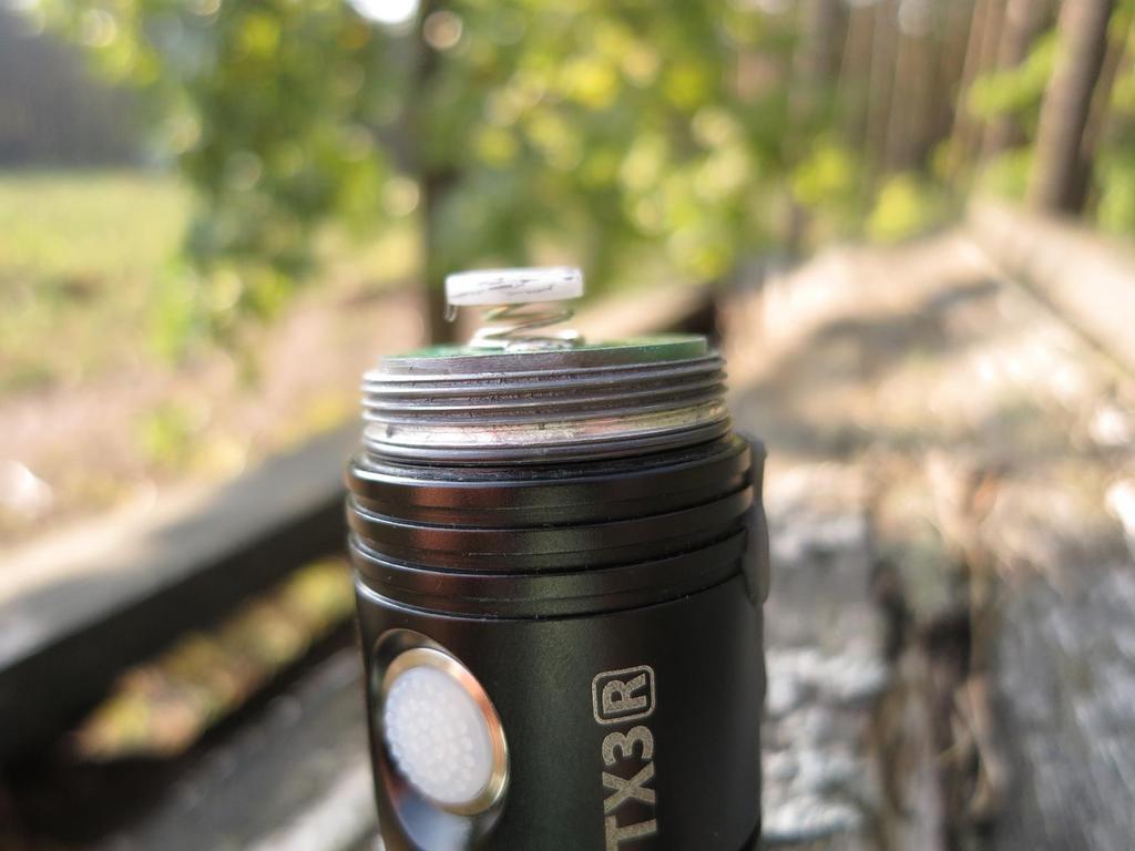

As a curiosity, the gwiny in the bottom of the cap was completely dry, without a drop of any grease, I do not know if this element was to be sealed?
Control spider - hmm, it's almost a tradition, again askew

I would like to write that the control offered by TX3G is "cool" - in a sense it is, but ... well, but what?
The flashlight is switched on with a single click (black button)
- always activates the flashlight in TURBO mode (always)
- turn off the flashlight with a black button (black only)
- double clicking black button and holding it activates momentary (as long as we keep the black button) strobo
And this is the whole functionality of the black button
With a white button, we turn on the flashlight:
- in the programmed mode, we can program the mode from moon to TURBO
And for example, we want to program to turn on in moon mode (very low), for this we have to switch the flashlight to TURBO mode, hold the white button for 3 seconds (during this time the flashlight will switch to Moon mode) and wait until the button flashes in blue from this moment the flashlight will start from the Moon mode. We must remember that for programming the mode we need to turn on the flashlight in one lower (earlier) mode.
- single clicks change modes in the loop (5 modes in total)
- to activate flash modes (strobo, beacon, SOS) we have to perform the sequence of fast 11 - clicks with a white button
Each time the mode changes after a few seconds, the blue LED of the white button flashes from 1 to 4 times. Theoretically, 4 flashes - above 70% charge, 3 flashes between 50 and 70%, 2 flashes - between 30 and 50% and 1 flash below 10%
Theoretically, because if the cell is about 70% of the charge in the lowest mode it will flash 4 times, while in the TURBO mode only 2 times.
The flashlight has protection against too deep discharging, if the cell will have about 3.5V, the flashlight will start to take modes, at about 3V it will already capture the lowest mode.
In a situation when the cell is discharged and turn on the TURBO controller, the timer will be squeaking until the moment of reducing the brightness from TURBO to, for example, moon.
The controller has a place for intelligent energy (unloaded cell), USB port, instant TURBO mode, informing us about the charge status of the cell, but did not something?
YES!
The protection against accidental turning on the torch !!!
I wrote to EAGTAC, they said that the buttons are hidden in the case so much that the flashlight "should not turn on". Interestingly, the holster is designed in such a way that the buttons are hidden in it, and the holster itself is reinforced, that without using a large force (perhaps large enough to destroy the holster) we will not push it.
I forgot to write about the operation of the buttons.
The left button (white) works lightly, each click is audible, while the black button requires using at least twice the strength and its work is much more pleasant for the ear.
The white button works lightly, and it already compresses the TX3G with a safe carrying in a backpack without a holster, which is a pity ...

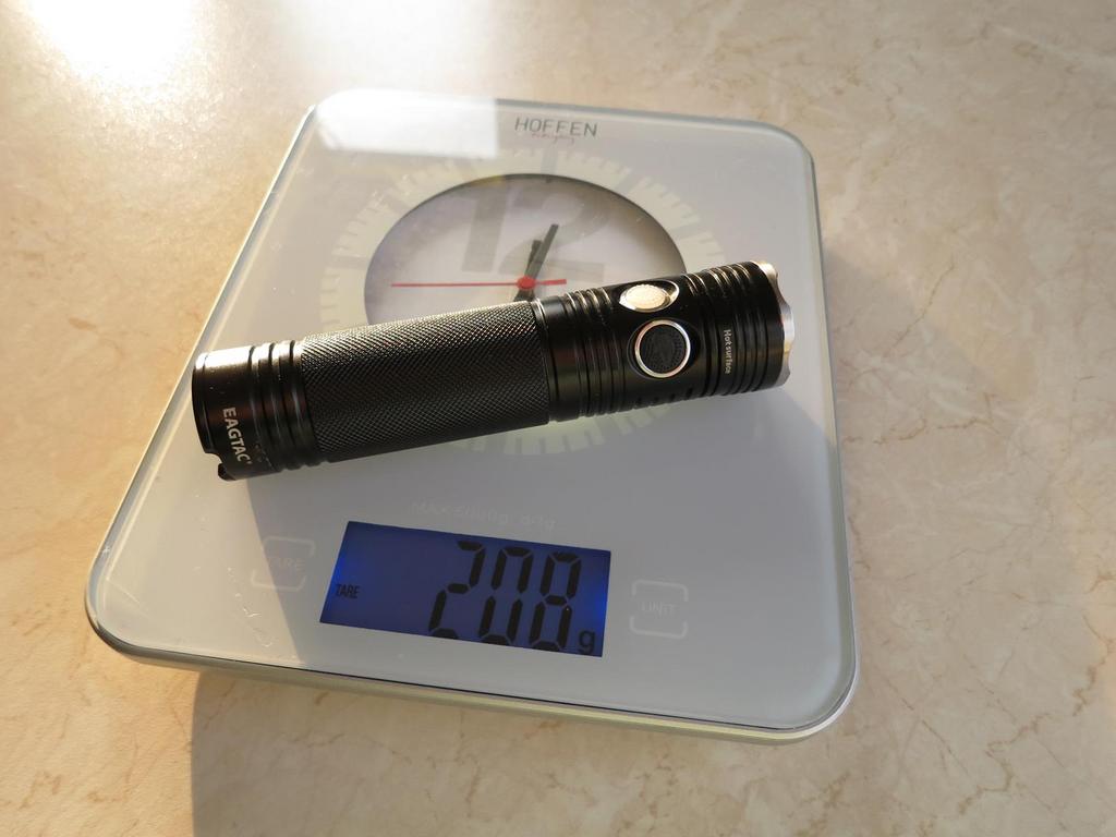

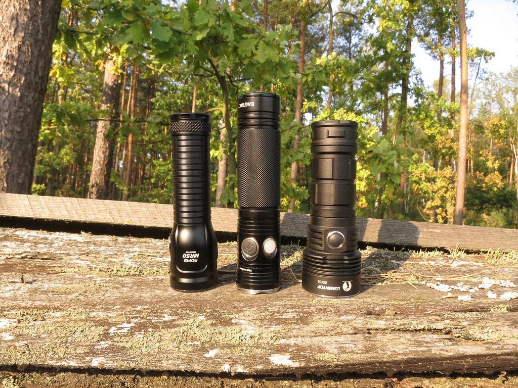

TX3G among Rofis MR50 and Lumintop ODF30

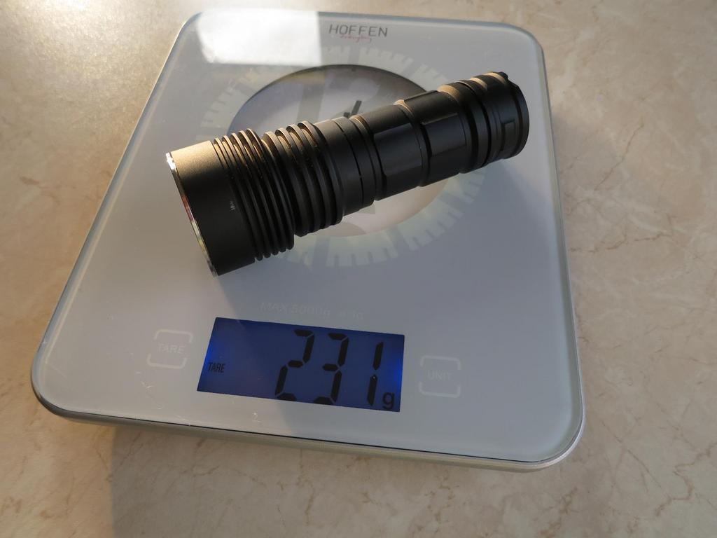

Despite its size, the TX3G powered from 26650 cells weighs only 208 grams per cell
Lumintop ODF30 powered with identical cells is already 231 grams with a cell.

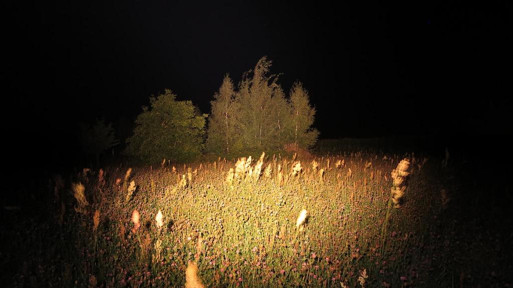

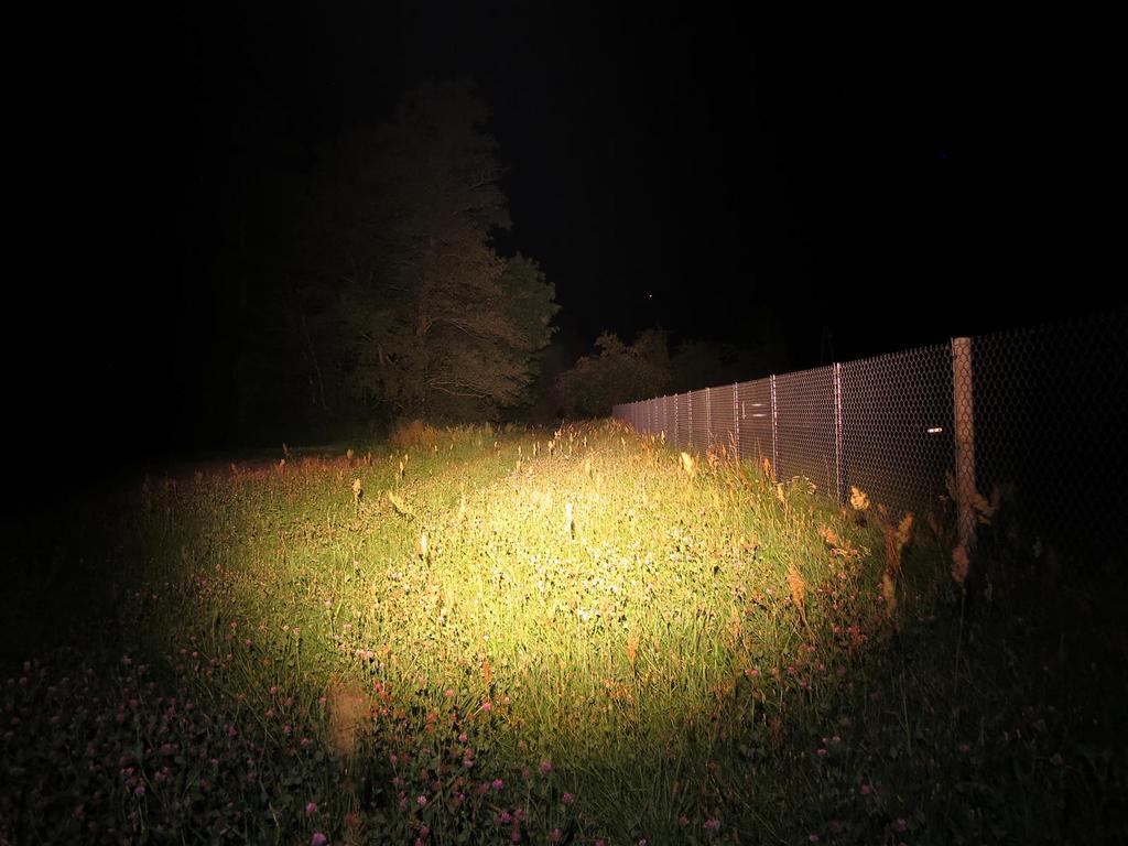

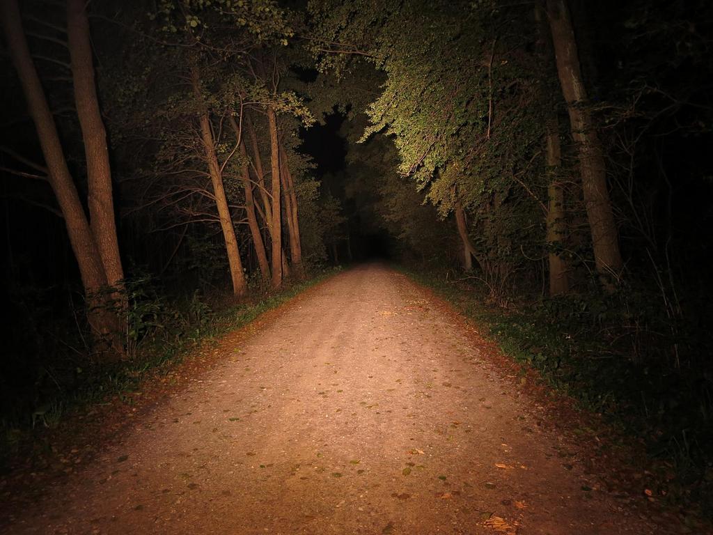

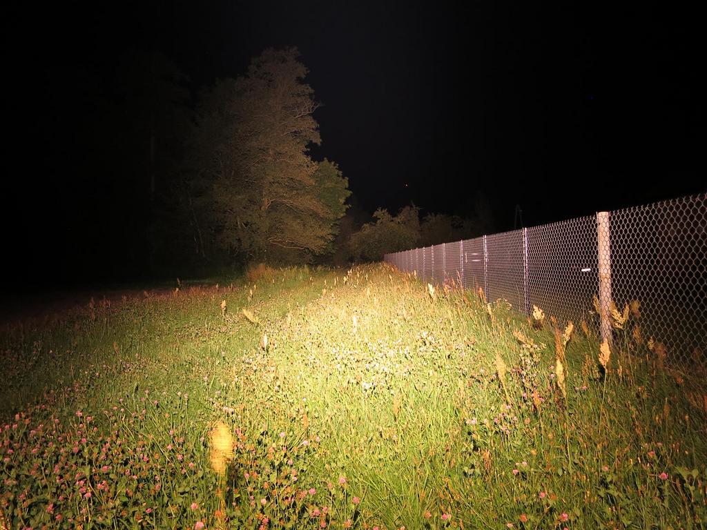

Field shots, camera settings ISO-200, f / 2, 1s, white balance - Fluorescent H
EAGTAC TX3G Pro - TURBO
Emisar D4 - TURBO
Rofis MR50 - TURBO
Fenix UC52 - TURBO
Wuben A21 - TURBO
EAGTAC TX3G Pro - low
EAGTAC TX3G Pro - medium
EAGTAC TX3G Pro - high
Emisar D4 - "medium"
Emisar D4 - TURBO
EAGTAC PX30LC2-R - TURBO
Rofis MR50 - TURBO
Emisar D4 - TURBO
Wuben A21 - TURBO
Fenix UC52 - TURBO
Rofis MR50 - TURBO
