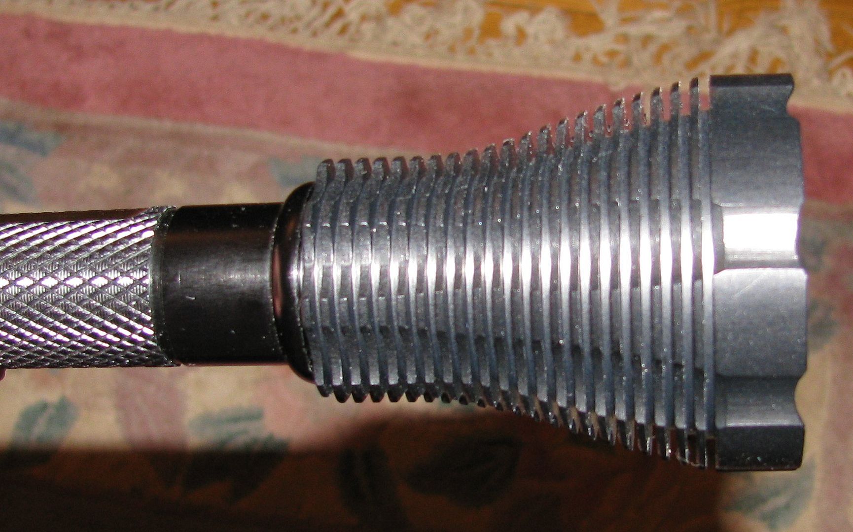

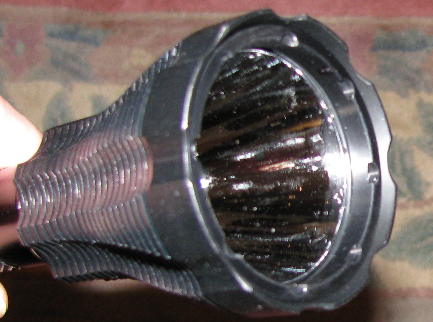

First thing you notice is how far FM has come in the craftsmanship and sculpturing. When I screwed head down over FM's D26 reflector, the edge between the two reflectors, nearly vanishes. I was not sure what to expect with essentially a "double reflector" but the fact that I am taking my time to post this review and ordering a second one shortly should tell you.
I have the FiveMega custom Carley 1794 bulb in this baby, and which Nite is generously selling in his thread here. (Sidenote, PLEASE MAKE SURE TO USE EYE PROTECTION WITH THESE). Anyway, I took some shots which I am posting below.

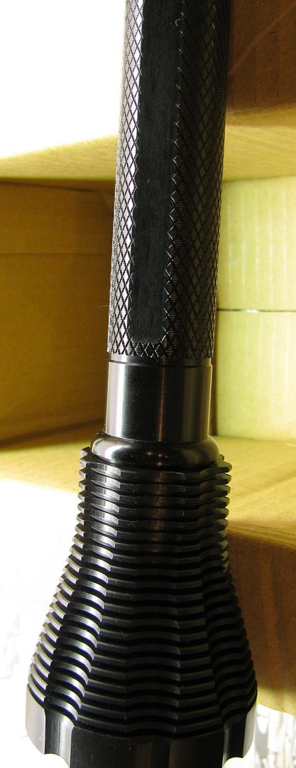

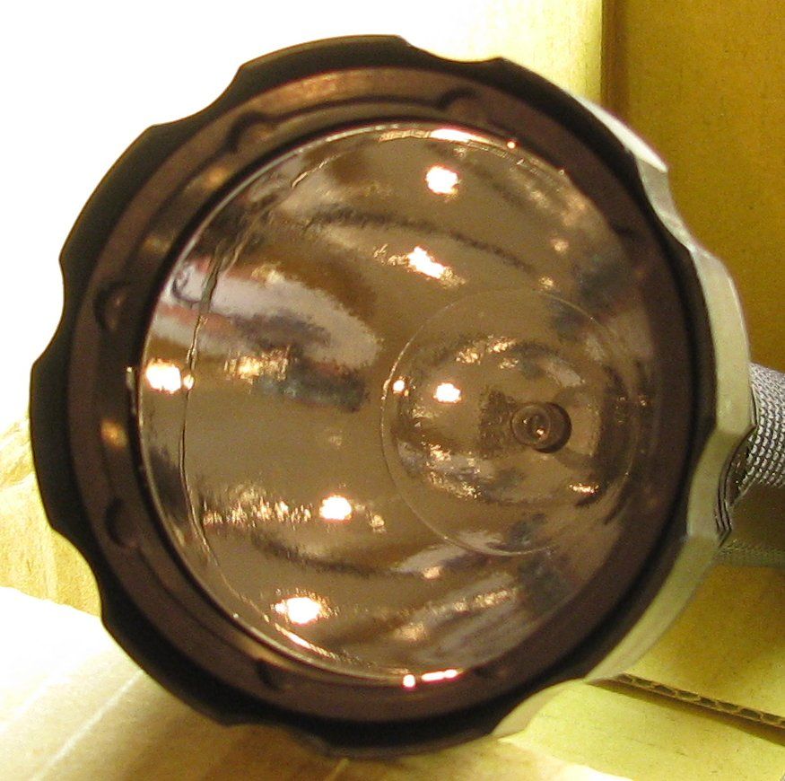

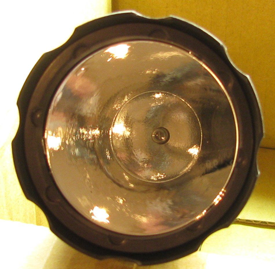

Here are some more thumbs you can click on to see other closeups I took.

Perfect color match, although the new Turbo head is not the shiny black as Nite's bodies. I had not even noticed it with the fins and grooving breaking it up until you asked.
  • Length of my Nite 2 x 18650 with "stock" head is 8 1/8"
  • Length with new Turbo head is 9 1/4" (including AW push button cover)
The Turbo Head looked to be much taller than the standard SF head. A difference of only 1-1/8in is not bad at all.

Reflector view of the P61 in the FM Deep Turbo C Head
