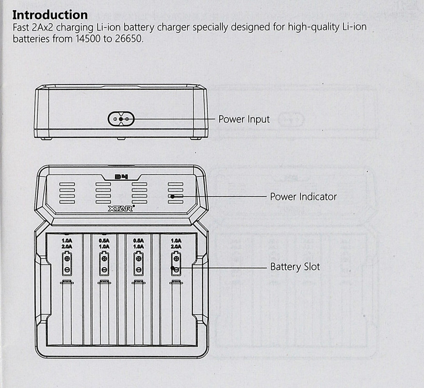

[FONT=&quot] If you leave Slot 2 Empty , Slot 1 can charge up to 2 amp depending on the battery . If you leave slot 3 empty then slot 4 can charge up to 2A . After this it gets a little vague , but I think ... Slot 2 and 3 charge at 0.5A and if slots 2 and 3 are populated then slots 1 and 4 charge at 1 amp . So the D4 does give you some options . Just need to remember what slots to populate .

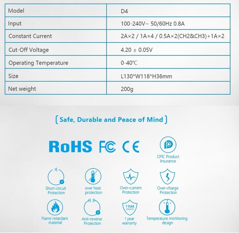

Seems to me it doesn't fully charge the cells , you could allways put them on the skyrc to top them off , it seems odd to me that most chargers don't charge to 4.2 volts , the only one I know of is the sky rc also my opus will charge to 4.2 but only after modifying it.
old4570
Feb 15, 2009
2,820
Melbourne - Australia
If you demand 4.2v , you demand 4.2v ...
But this is a smart charger , it does not force 4.2v into old batteries with high internal resistance .
It may do this to avoid flaming out the battery , and possibly increase longevity .
Also dont forget , resting voltage VS charge or discharge voltage ..
So the charger , even if it does terminate at 4.2v turns off the charge process .
The battery then normalises to a resting voltage .
Depending on the condition of the battery , will make the resting voltage a variable .
This charger terminates and leaves good batteries at 4.19v , but the results shown is for the tail end of my 18650 collection ( older batteries ) .
Also having a clue to the condition of your batteries ( high internal resistance - diminishing capacity ) , might be important to some people (?) .
