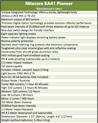

Manufacturer's Specifications
Price: 75 USD

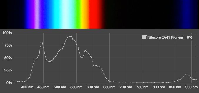

Spectral Analysis
All light that we see as white is actually made up of several different colors put together. The relative intensities of the different colors in the mix are what determine the tint of the white we see. For example, cool white LED's have a lot of blue, and warm white LED's have more red or yellow. This measurement was done on a home made spectrometer. The plot below the picture is corrected for the spectral sensitivity of the human eye. Note: the peak in the 900nm region doesn't really exist, it's a piece of the second-order spectrum that's showing up here because of the high intensity of the light source.

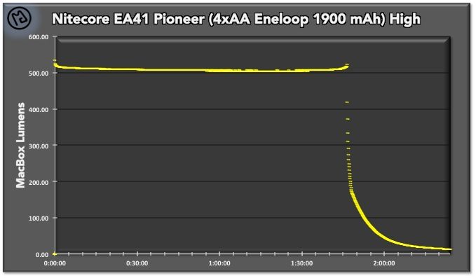

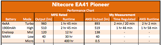

Output and Runtime
***Updated Turbo output from second review sample.***
ANSI FL-1 runtime ratings are the time it takes for a light to fall to 10% of it's original output (counting from 30 seconds after turning the light on).
The vertical axis of the graphs below represents a relative brightness measurement using a home made light box. The horizontal axis is time in hours:minutes:seconds. Runtimes are stated in hours:minutes:seconds. These graphs may be truncated to show detail.
Mode Comparison
Turbo
***Updated chart of the first few minutes of Turbo, based on a second review sample. The rest of the plot carries the same shape as what you see above.***

Unfortunately, the Turbo mode is a bit disappointing. I've run the test several times, and each time get about 800 lumens on Turbo, which is only a few lumens higher than what I got for the EA4. I'm not sure if Nitecore tested this number, or just calculated it from spec sheets. Here's what I could find: the EA4 had an XM-L emitter with a U2 bin, and the EA41 has an XM-L2 emitter with a T6 bin. Now, the Cree datasheets claim that "The XLamp® XM-L2 LED builds on the unprecedented performance of the original XM-L, increasing lumen output up to 20%" (XM-L2 Datasheet). So, it seems you might just multiply the previous output of a light that upgraded from XM-L to XM-L2 by 1.2 to get it's new output. However, when you take into account the different bins used it becomes a bit more complicated. Cree states an minimum output (at 700mA and 25 C) of 300 lumens for an XM-L U2 (see the XM-L Datasheet) and 318 lumens for and XM-L2 T6, which is only about a 6% increase in brightness. In this case, assuming both the EA41 and the EA4 drive Turbo at the same current, the output range covered by a single bin could easily account for the identical brightness I measured (if I had an EA4 with a brighter than average XM-L U2 and a dimmer than average XM-L2 T6). Whatever the explanation, the EA41 is still going to be on average more efficient than the EA4, but I do wish they had actually upped the brightness more.

8.7.14 - Nitecore sent me a second sample of the EA41, because the first one could only get up to 800 lumens instead of the claimed 900 (very unusual for Nitecore in my experience). Not sure what was wrong with the first one, but the second one hit 900 lumens no problem, and was at 893 by the 30 second mark. You can see the data in the Performance section above.

Ok, I've received the second sample from Nitecore and it's output is up to what's expected (893 lumens at 30 sec), you can see the data updated in the review above. :thumbsup:
