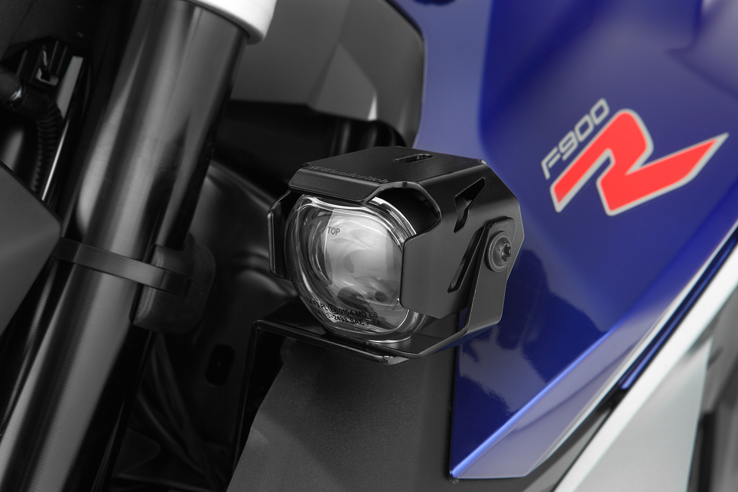

I made brackets that fit on the forks of the bike, and now I am trying to decide which lights to actually install. Before I pull the trigger on a set of fog beam lights, I am trying to see if there are small aux low beam lights available. I found these two, anyone have experience with them?
