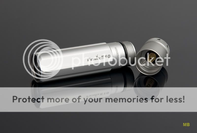

The tint is fantastic, lovely Vanilla white. A bit of a revelation compared to comparable Cree's. The Luxeon Rebel LED in the E10 is nicely centered and I am not getting the ringy beam as posted elsewhere in this thread. Sure there are some artifacts and there is small 'halo' around the outer edge of beam but it is nice and smooth and has a great tint. Did I mention I liked the tint? 🙂
I'd urge anyone to give this a go. Here are some pics:
http://i624.photobucket.com/albums/tt322/matthewjbass/Fenix-E10_Luxeon_Rebel_03.jpg

@Bass, those are some of the nicest E10 pictures I've seen... :thumbsup:

Thanks rookiedaddy!
