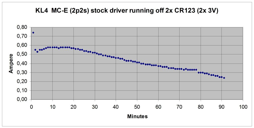

Before I actually started modding this L4 the 2p2s wired MC-E with stock driver was tested using my bench supply, primary – and rechargeable cells.
First I tested the setup with my bench supply. The MC-E lit up starting from ~ 4.8V (I out = 40mA). At 6V output current measured 780mA (I in = 1010mA). So, when run in regulation each die of the led sees 780/2 = ~ 390mA. The led is producing plenty of lumens at this level! It also means the 2p2s needs 2 cells. One cell even can’t fire it up.
Then I ran the light off two CR123 (primary) cells. As you can see in the graph primaries aren’t able to run the light in regulation. Output dropped below 500mA after 32 mins. At 500mA the light is still pretty bright but of course not as bright as when it runs in regulation. After about one hour output drops below 400mA. The conclusion is that you’ll get good output for about 1 hour on primaries.

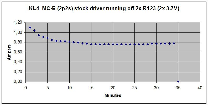

Next I ran the light off two R123 cells (3.7V blue jacket cells from AW). This setup really shines! As you can see in this graph these cells ran the led in direct drive for about 10 mins (because input voltage was > forward voltage of the MC-E). From then on the light runs in full regulation until the protection circuit kicks in. In total I got ~ 32 mins of bright output and was quite impressed! The driver survived the torture of this test without any problem.
It’s a pity I didn’t have any of AW’s LiFePO4 cells (safe chemistry 3.2V) to test with the same setup. I guess these will be better suited because of their lower voltage (but unfortunately also less capacity).

I didn't try this light with one CR123A but given the results of my experiments with two primary cells I guess it won't.
yeah...primaries looked a bit :shakehead:
I presume 17670s won't have an affect either
I was wondering about your graph for RCR123A...I was told that running 2xRCR123A will damage the KL4 head...I guess they meant burning out the LED, not the driver:ohgeez:

I also tested the L4 with 2*Rcr123 and it was friggin bright, but as
Freddy already told, it could damage the driver. And using 2*Rcr123 (with 3.0V)
its very very bright, much more than any little SSC P7 lights i have...

I'm confused, so is the stock driver safe to use with two li-ions? I've always been scared to use two li-ions & still am. :green:
I think its not safe...even not for longer use. I tested the L4 with
2*Rcr123 (8.4V), for some minutes, it works fine and gets not to hot.
But i will not try it for longer...:grin2:
Will, the driver survived the test with two 3.7V li-ions but someone will have to do an endurance test to know if it is safe. In the meantime I advice to use 3.0V li-ions only 🙂.
