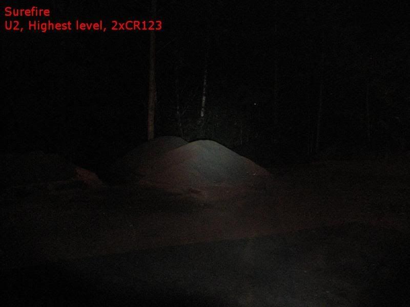

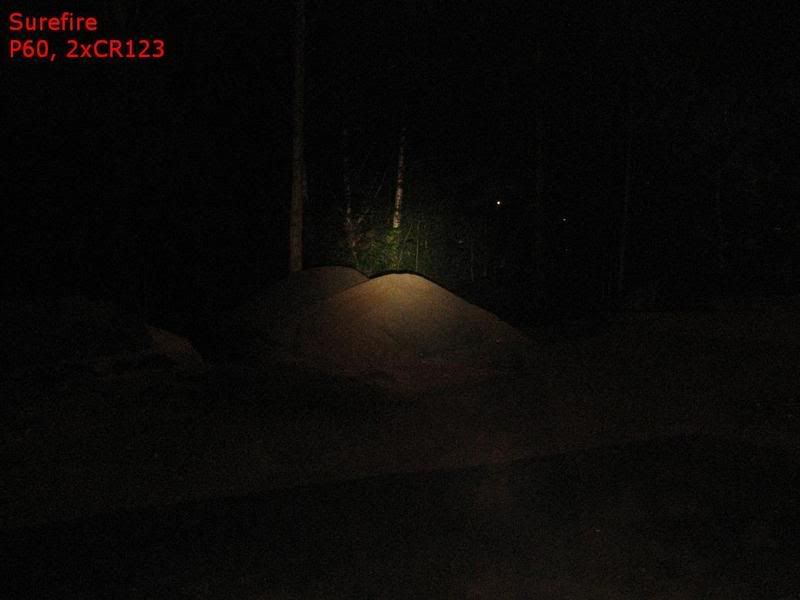

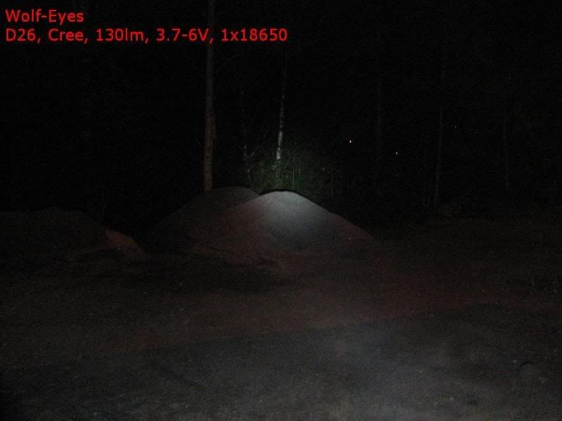

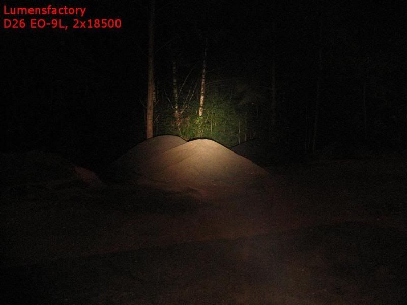

Beamshots!
Thumbnails, click on them to enlarge.
Lumensfactory EO-9, 275 lumens
Surefire P60L, 80 lumen
Surefire, P60, 80 lumens
Surefire U2, 100 lumens
Wolf-Eyes Cree drop-in, 130 lumens
And a .gif showing all of them:
http://i11.photobucket.com/albums/a197/softfeel_one/Bp60lcomp.gif
