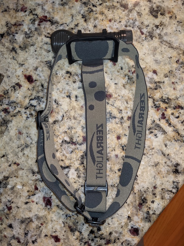

I have a H600 Mark IV and the strap came undone. Is there a video or decent tutorial on how to thread the headband through the buckles. I tried doing it intuitively but it never tightens and is always to loose. BTW I’m not even using the top strap as I never do them on any of my Zebralights
Duster1671
Oct 16, 2017
111
Here's a photo of mine that might help you decipher. It's upside down here:
