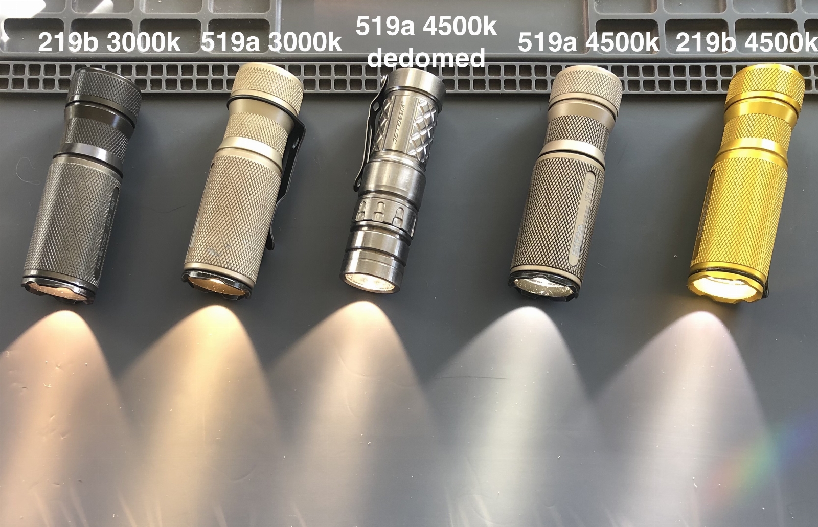

How does the 519A compare to other Nichias?
519a is up to 50% brighter, has equally fantastic 9080 CRI, without the pink tint, unless dedomed, which produces a color that I cannot resist. They are the same 3535 footprint size, same solder pads, the dome is larger on the 519a (larger hotspot, like LH351d and XPL).
I have been carrying a dedomed 4500k 519a since I got it (it is now 3500k), the middle light:
3XYaraE
You can get a Zebra w dedomed 519a, and experience it for yourself:

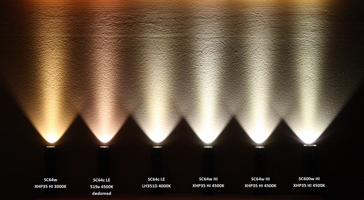

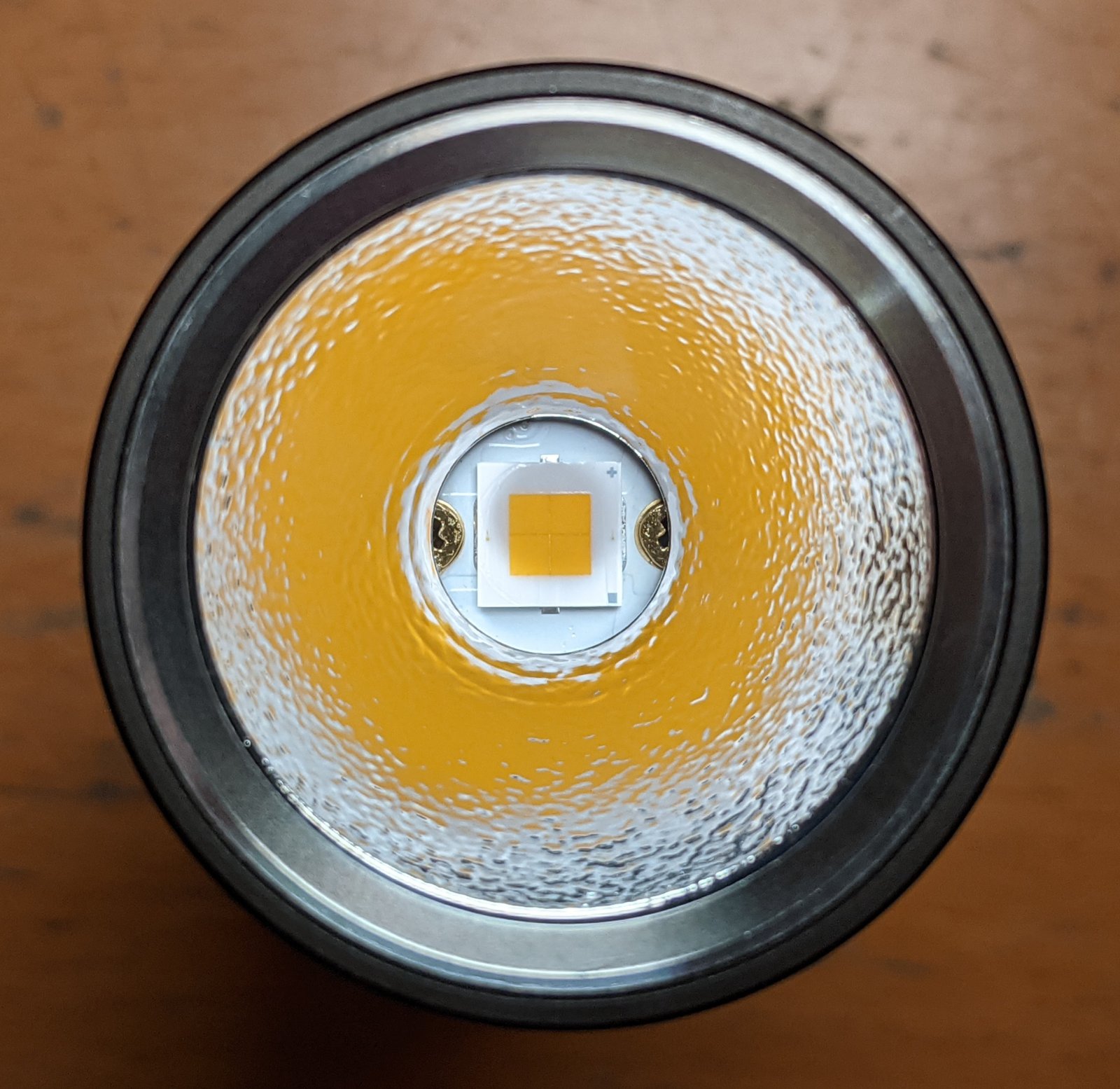

In the mail today came a SC64w modded with a 3000K 90+ CRI XHP35 HI. This essentially turns the otherwise unappealing (to me) SC64w into a warm white high CRI SC64w HI.
Really incredible beam on this. ~850 lumens on level 12 with quite neutral tint that has almost no shift across the beam. Color rendering is not at 219b level, but a respectable Ra of 90 and R9 of 60.
I'll add some beamshots later...
Edit: "level 12" was "level 10". This makes 850 lumens max...

Zebralight Beamshot Copy 2
This photo was taken with WB at 5000K and is reasonably close to what I see by eye.
As with any comparison of this nature, the differences are magnified by comparing lights side-by-side. This is true for the photo and what I see in person.
