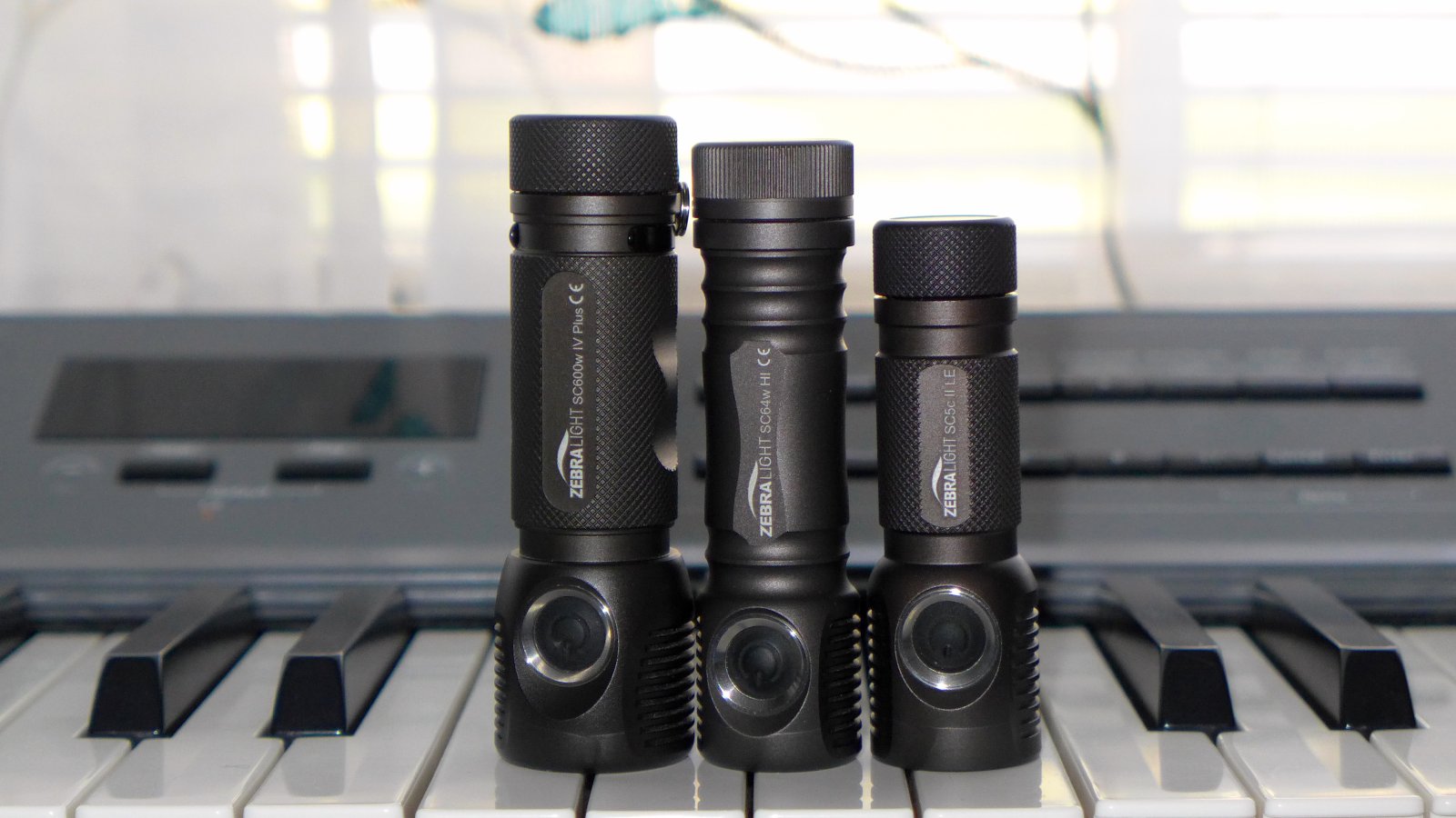

Difference in size between these three diminutive Zebralight flashlights:
SC600w IV Plus - Single 18650 - 2300 Lm
SC64w HI - Single 18650 - 1300 Lm
SC5c II LE - Single AA - 475 Lm

Which is your favorite for edc?
Both the SC64w HI and the SC5c II LE slip into the coin pocket on jeans, plus their screwed on pocket clips hold/grip much better than the removable one on the SC600w IV Plus, so much less chance of losing them. So to answer your question, these are the two I carry the most. I only recently purchased the SC5c and thrilled with the amount of light it puts out.
I didn't need the SC5c but have so many eneloop AA batteries that I used that excuse to justify my purchase. Anyway, does anyone really need a reason to buy another flashlight?
