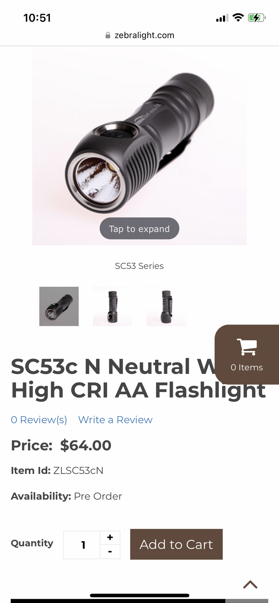

There’s no easy way into the bezel without special tools is there (shaved down pry tools, etc.) for access to de-dome this new SC53n 519a without marring, scratching the light up or breaking something trying to press fit the head back together? Better to buy this already done from Bob_McBob if we want that? One “as-is” may be nice too = )

Wow that is a seriously nice flashlight.
Seeing that ZL suggests using Eneloop Pro inside.
Dedoming that emitter is going to make a very warm color temperature. Anyone have a number on that? 2000K CCT?
