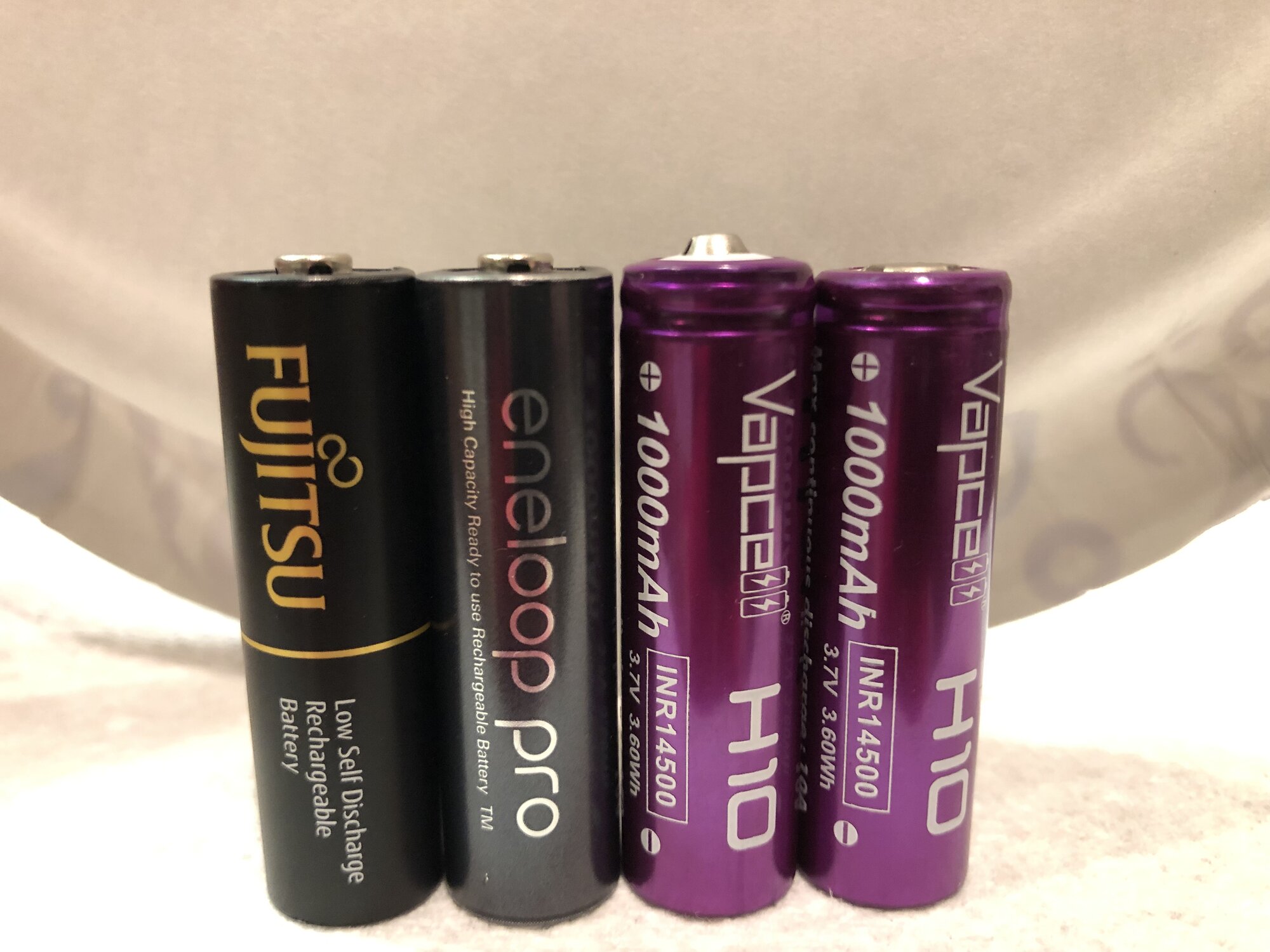

Cranked the Vapcell H10 button-top really tight and no joy on my SC53w. Probably could grind the button down a little and it would work...
Just a guess given the SC53w not getting overly warm on H1 using a Li-ion it's running close or around 2 amps for the SC53w on Li-Ion. It auto ramps down at one minute like the SC52 so that's a good thing...
I think the driver/light was originally designed for Li-ion (like SC52) and it had the slight problem when changing battery chemistries. Too much money to fix the problem and too much confusion to add a line in the manual to push the button when changing battery chemistries for the general public users...
I put a little solder on the one H10 flat-top I have that wouldn't make contact and it works fine...
For me the SC53 is anemic (to dim) on an Eneloop - Fujitsu battery. I'm gonna be sending it back, promptly, if it doesn't take the Li-ion!
