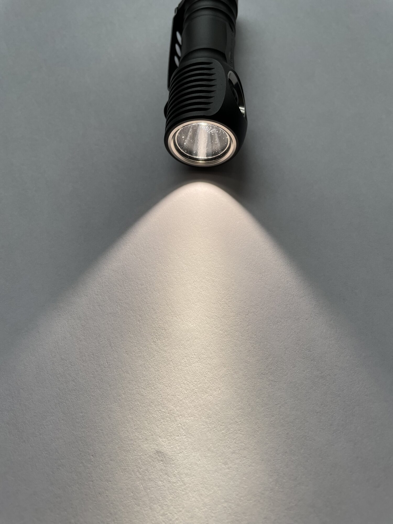

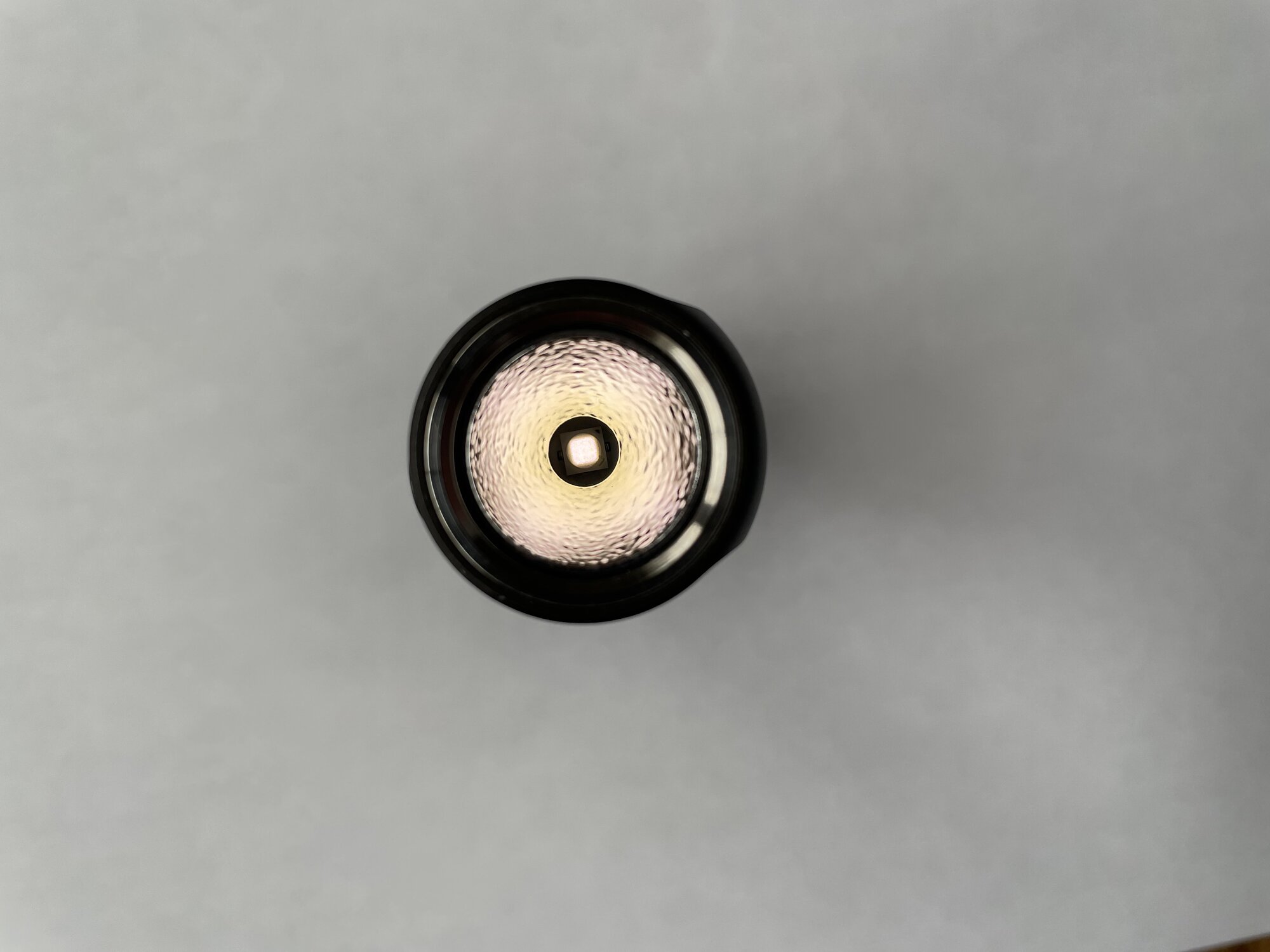

Got my SC53c back from Bob_McBob. New emitter swap SW45K D220. Beautiful!

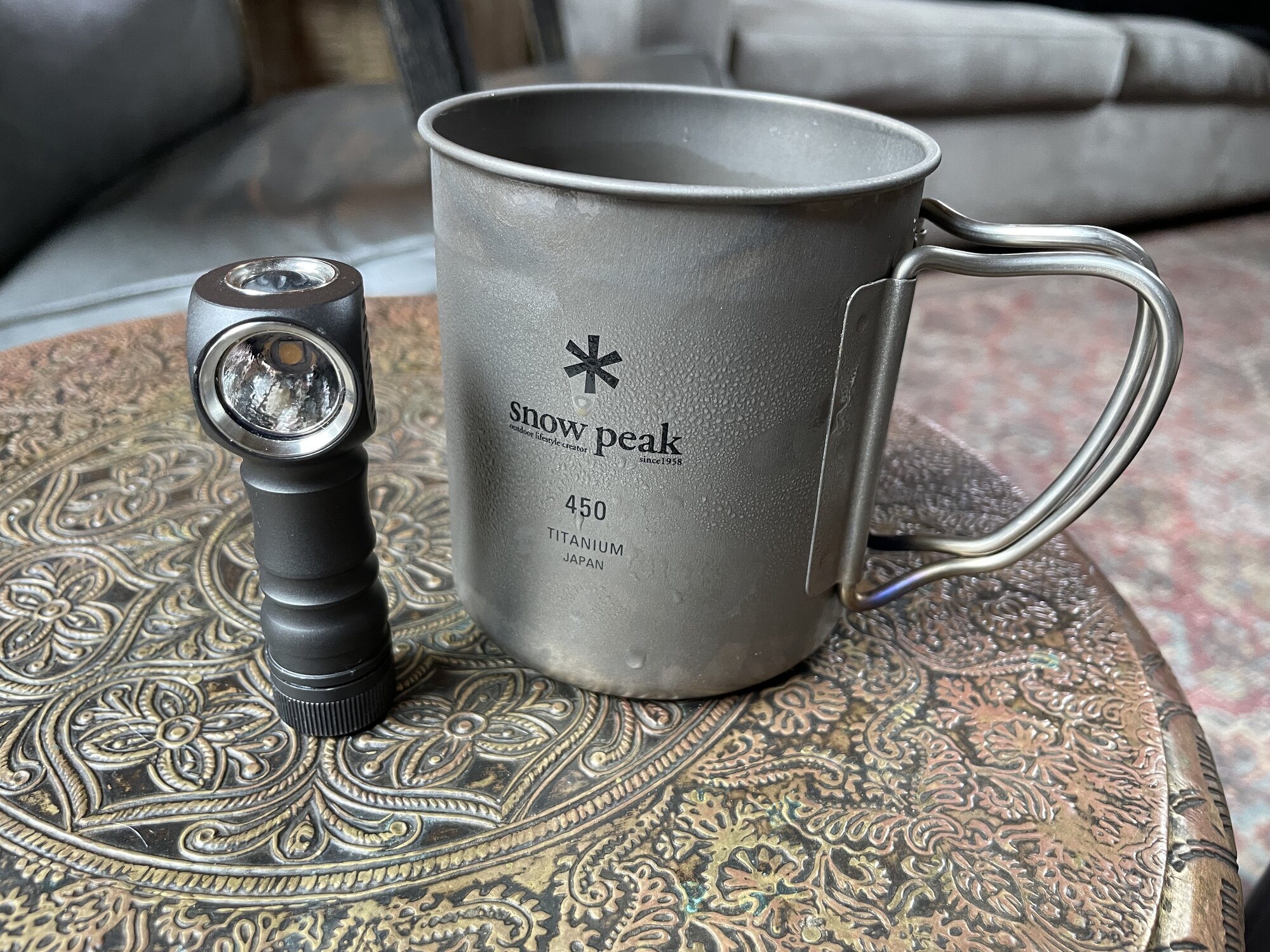

Actually, Zebralights look like fire hydrants….
