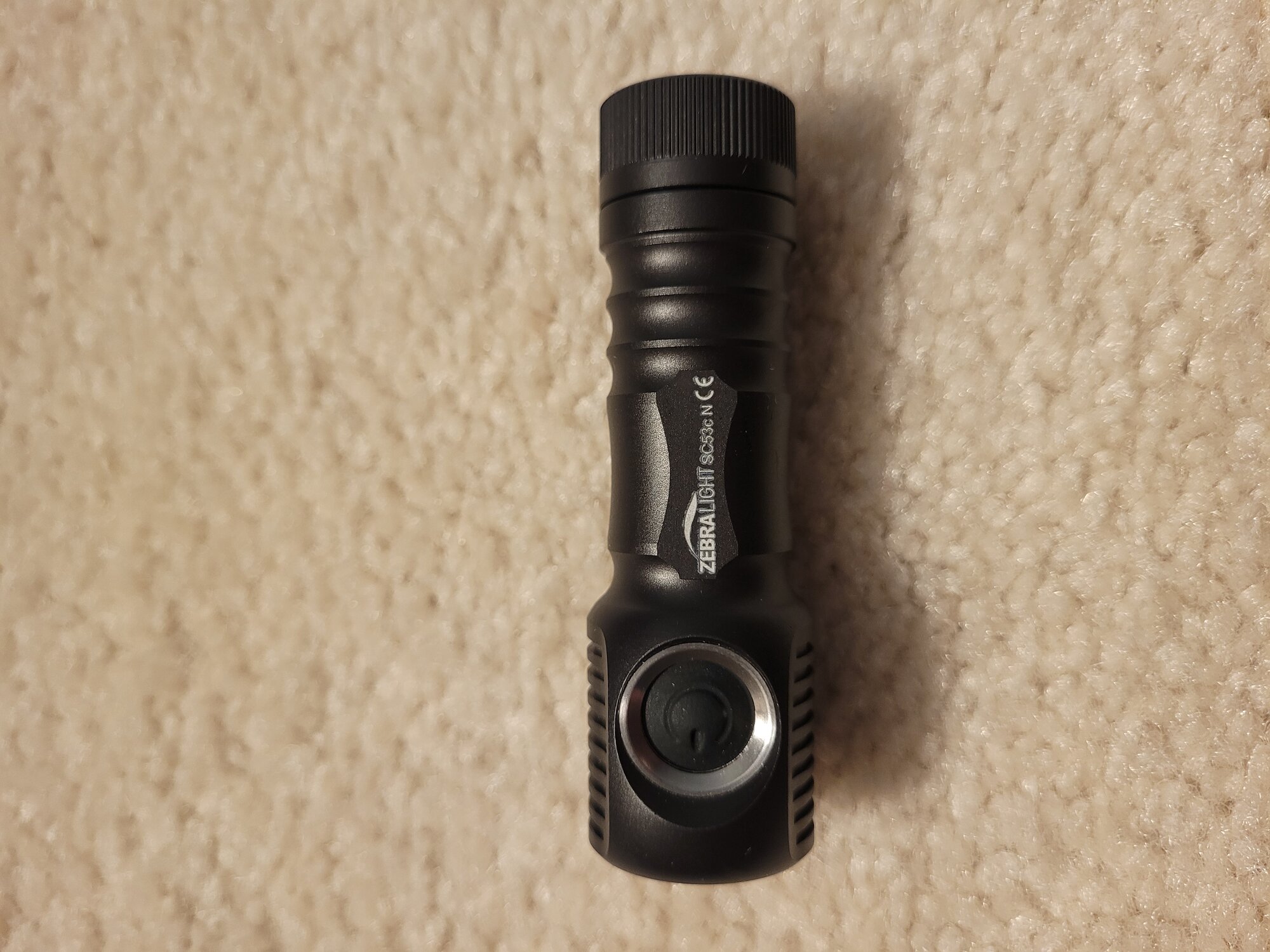

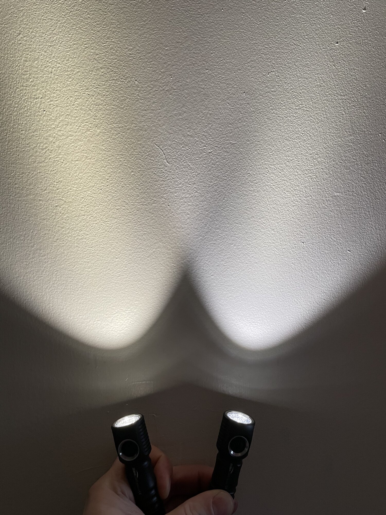

New Zebralight sc53c N
519a 4000k left. 219b SW45K right
Mar 8, 2022
503
PA
I don’t have much to compare it to. But from my past experience with the AA models I’d say output on H1 is around 275 lumens on a primary. Similar to the previous models. It’s a nice upgrade from what was offered in the past. Definitely a win for Zebra going the 519a route. However, I’d rather it be 4500k-5000k but that’s just my personal preference
