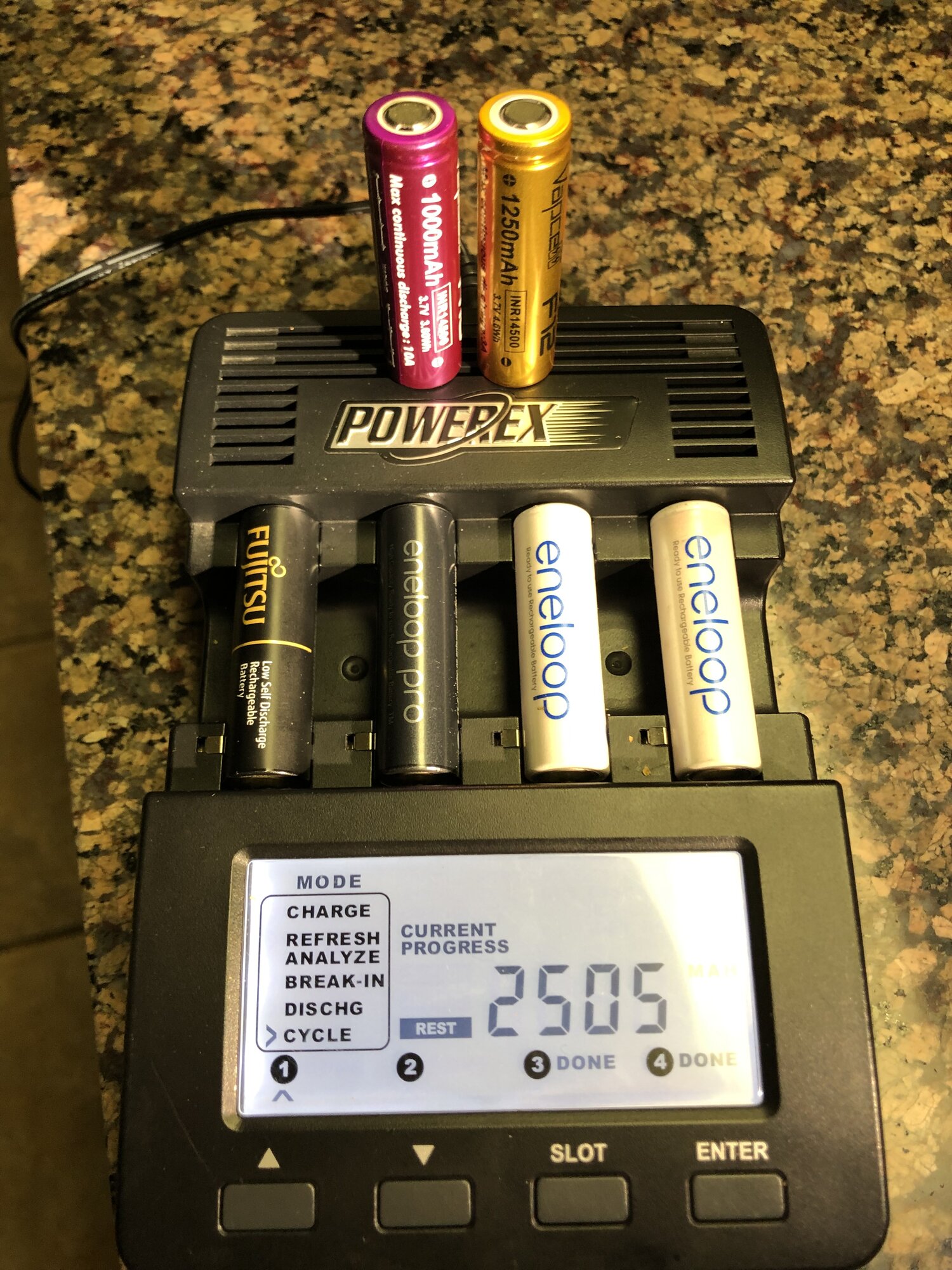

Tonight I'm gonna run a simple test of one SC53w at H2b-198 Lumens.

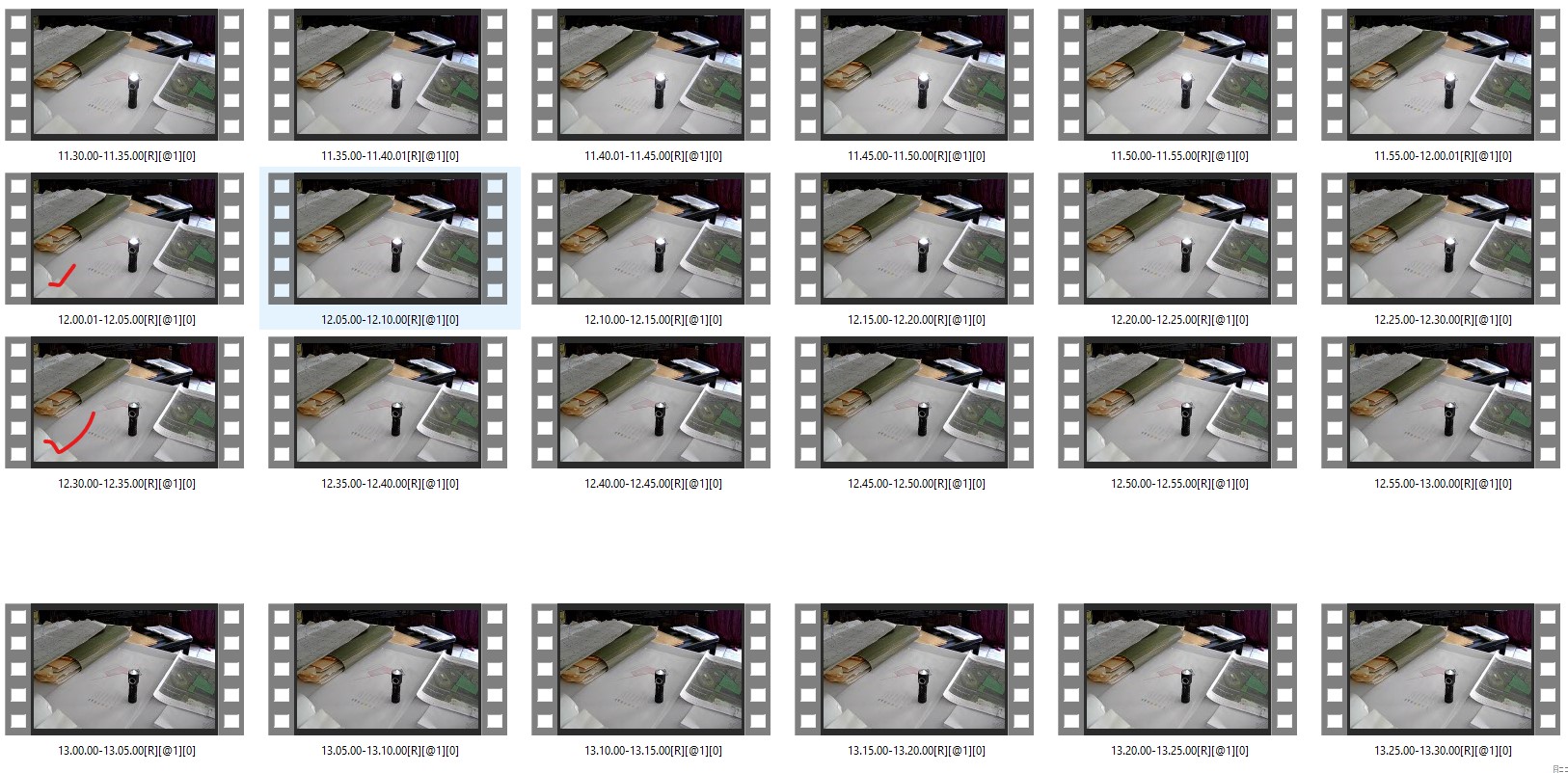

Gonna see which battery chemistry will run the longest using a DHSS recording security Camera to capture step-down for each battery chemistry. Turn the light on and let the camera do its everyday thing!
Fujisu 2450 mah ------------------- All refreshed and charged.
Eneloop Pro 2450 mah
Enloop White 2000 mah
Vapcell H10 (10amp) 1000 mah
Vapcell F12 (3amp) 1250 mah

Ran 5 batteries through full run-time test using SC53w.
Low Voltage Protection FAILED on all but one test.
Claimed 2.3 hrs at 198 Lumens on Eneloop Pro is correct if you divide it by 2! That had to be a fantasy. Claimed 10-20% remaining after step-down is a fantasy too on an Eneloop.
Need to re-run Vapcell F12 as it ran a very long time with no step-down but drained the cell down to 1.58v. Need to be around to watch it...
Going to re-run Eneloop Pro with a fan blowing right on light to see if that helps to get the run-times Zebra is claiming as I ran all the test no cooling. Light might have go a little hot at 130 F and gave problems to the LVP.

Only run that acted correctly Vapcell H10 ending at 2.98v. Stepping down to lower levels with around 7hr total runtime... Red check marks you can see some step-downs...
