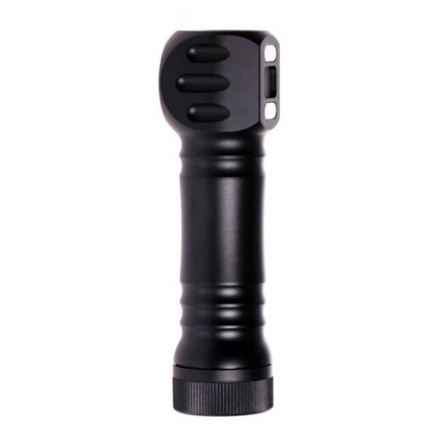

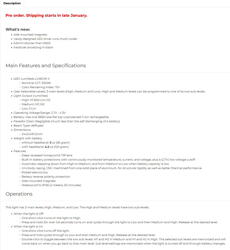

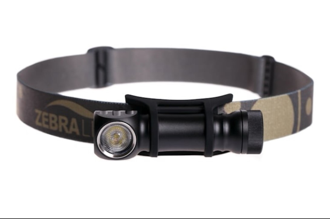

Surprised nobody is talking about the new Zebralight A6 Headlamp that is up for sale on their website. There are pictures and everything. Unique magnet placement on this one. I don't know much about the Luxeon led. Is it any good. Price looks good too.
jon_slider
Mar 31, 2015
5,183
word on the street is that is going to be used for magnetic charging
you may want to wait for the other shoe to drop, before being an early adopter
not for my tastes
it is Low CRI, but if that does not matter to you...
maybe wait for others to report whether the Tint is Green or not
Monocrom
Aug 27, 2006
20,393
NYC
Well, looks like I'm not buying ANY future Zebralight products. I despise magnetic charging. Honestly, it's being different just for the sake of being different. The charging cables are not common as dirt. You can't just simply go to the nearest hardware store and pick up a new charging cable if the old one becomes de-magnitized.

The new A6 looks great…I'd love magnetic charging in such a compact ZL headlamp personally. Hope they introduce that feature at some point. Unsure if magnetic charging would require a proprietary battery but for now it specifies unprotected flat top and I'm guessing any proprietary cell would be longer and unable to fit without changes to the body design.
Thanks ZL for taking some risks and introducing some new models recently!

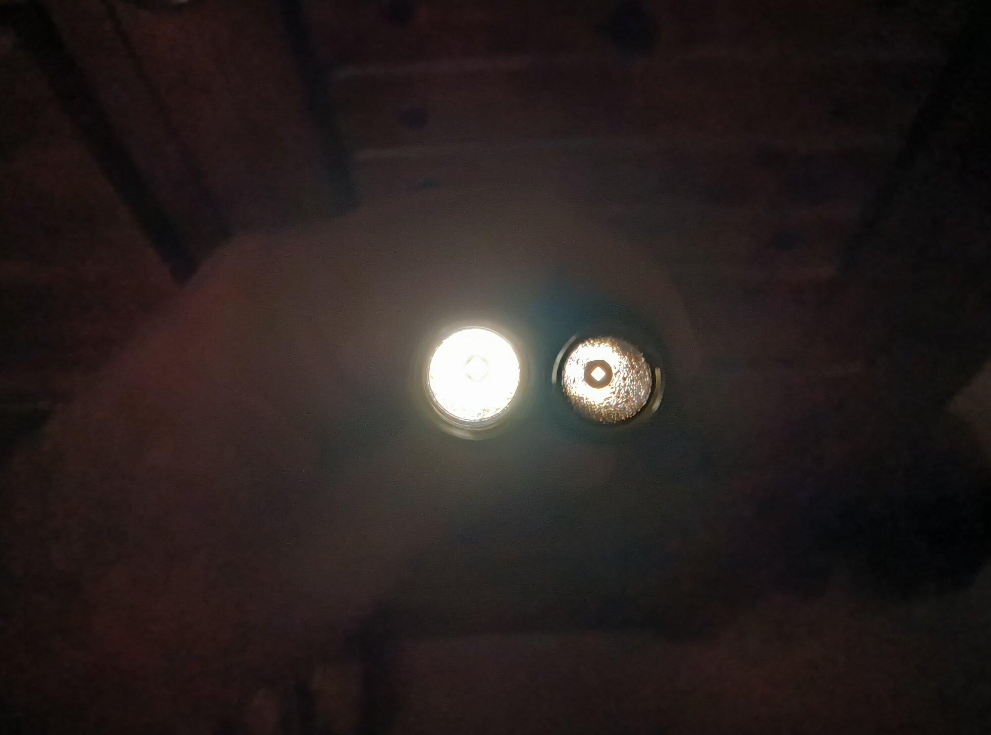

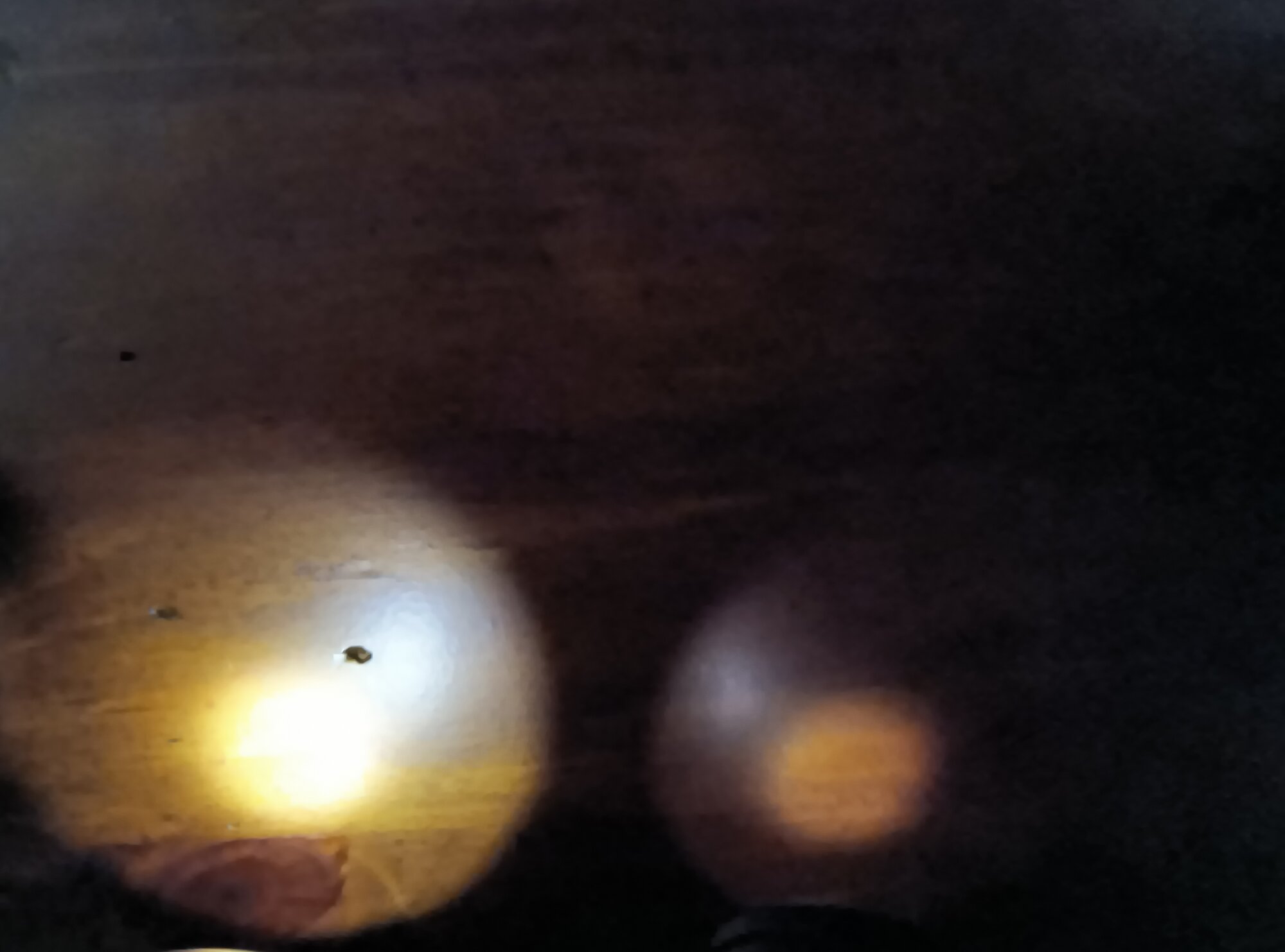

This is what I'm talking about. The SC65 on the right and the SC64 on the left. I really can't believe the difference in dimness on the lowest level. The SC65 has the dimmest lowest level of all my ZL. It would be OK to keep track of the light at night, but really not enough for navigation.
The SC65c HI is low enough, but still far from the lowest of the current AA lights and older 18650 as well. SC64w HI is too high for my taste.

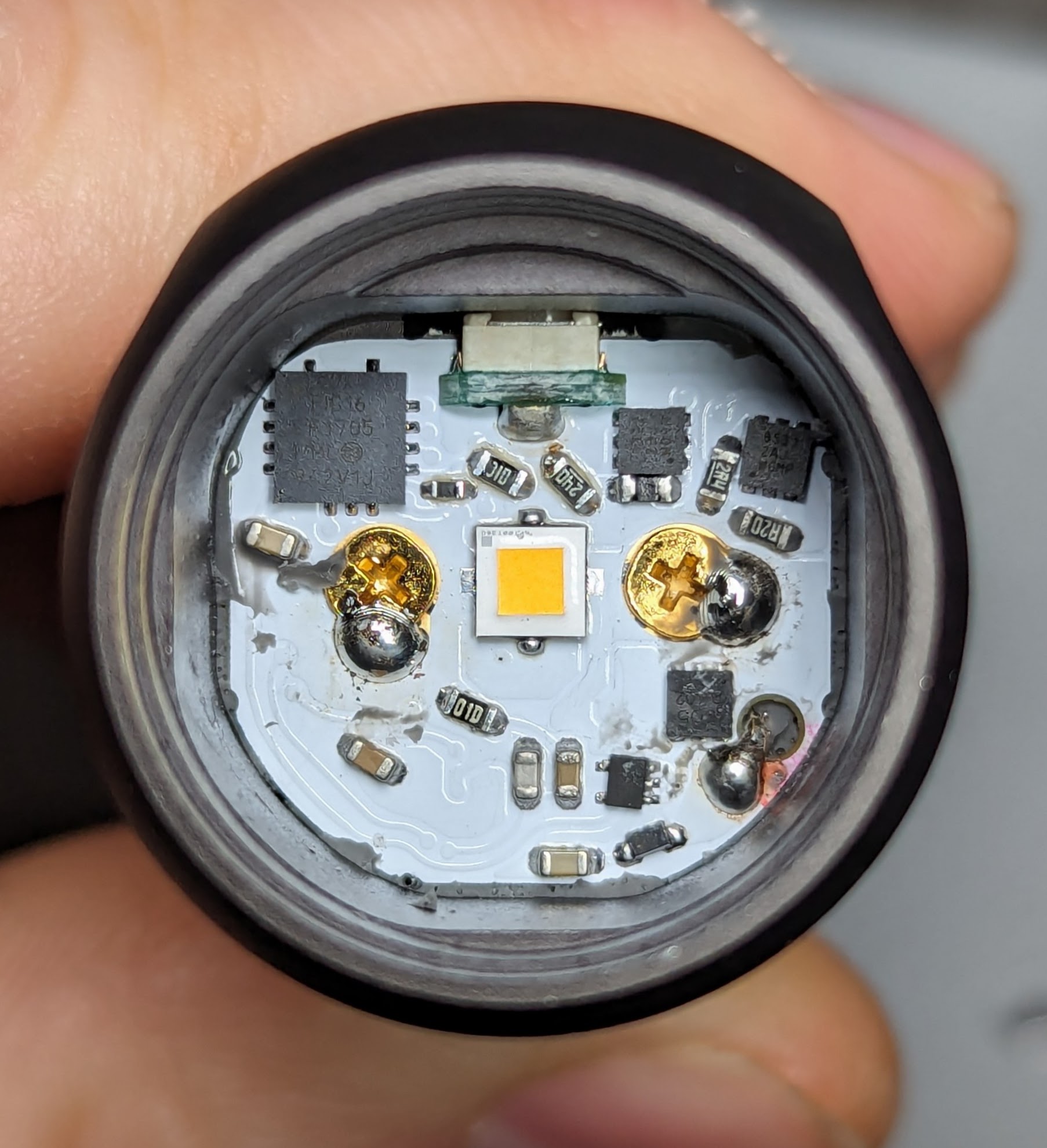

I can confirm that the SC65c HI driver has been updated to add the missing comp passives. This should give a bit of an efficiency bump over original production lights, though I doubt most people will notice anything in typical usage.
(reposting this because I just realized CPF's image uploader inexplicably does not remove EXIF data)
Mr. LED
Mar 27, 2011
723
Anyone else noticed that the lowest moonlight on the SC65c getting dimmer after some use? I noticed this in two different flashlights, one from the early batches and one with the updated driver. When I bought them, L4 was equivalent to HDS (200 lumen Nichia 219B 4000k) fourth level. After some weeks of daily use, both are now lower than HDS level 1 (0.02 lumen), which means that the SC65c HI is the advertised 0.01 lumen.
The question is, why did it happen only after a few weeks of use? Circuit burned in? Am I crazy?
