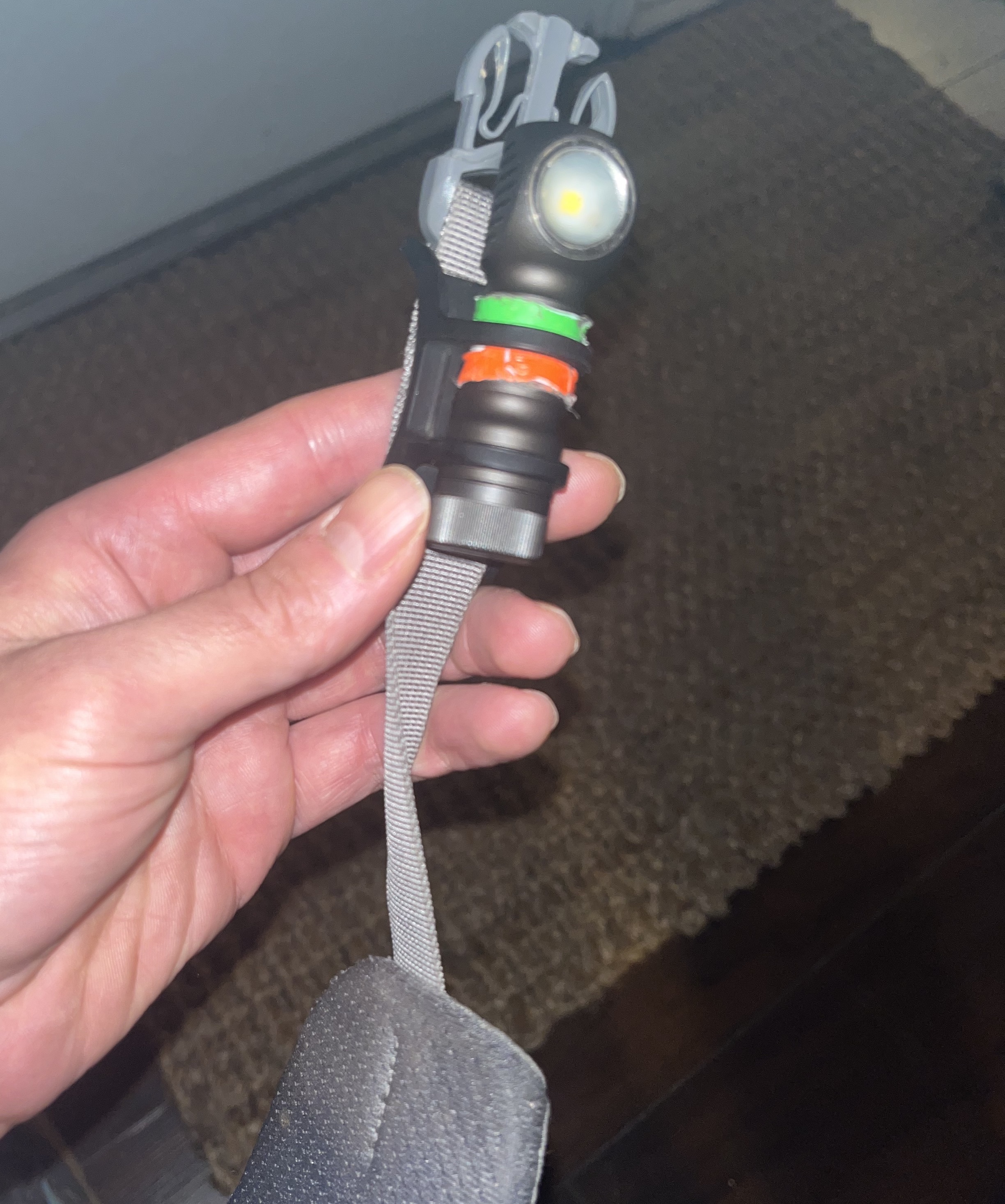

As for a waist mounted light, I keep a silicone holster attached to most backpack waist belt straps. Throw an AA mule on it when walking for a long time. Works great!

Instead, I dug out this Olight headband I bought for $2, and swapped my H53FcN into it. So far, I think I like this setup better. It's easier to turn, but MAYBE too easy. So far, though, this seems like a great $2 upgrade to the ZL headband.
i just wanna see the local weather report but this trump thing is going on all day they should pause for local news they say we are geting a first time ever storm here i wanna know if its still comeing and what to expect

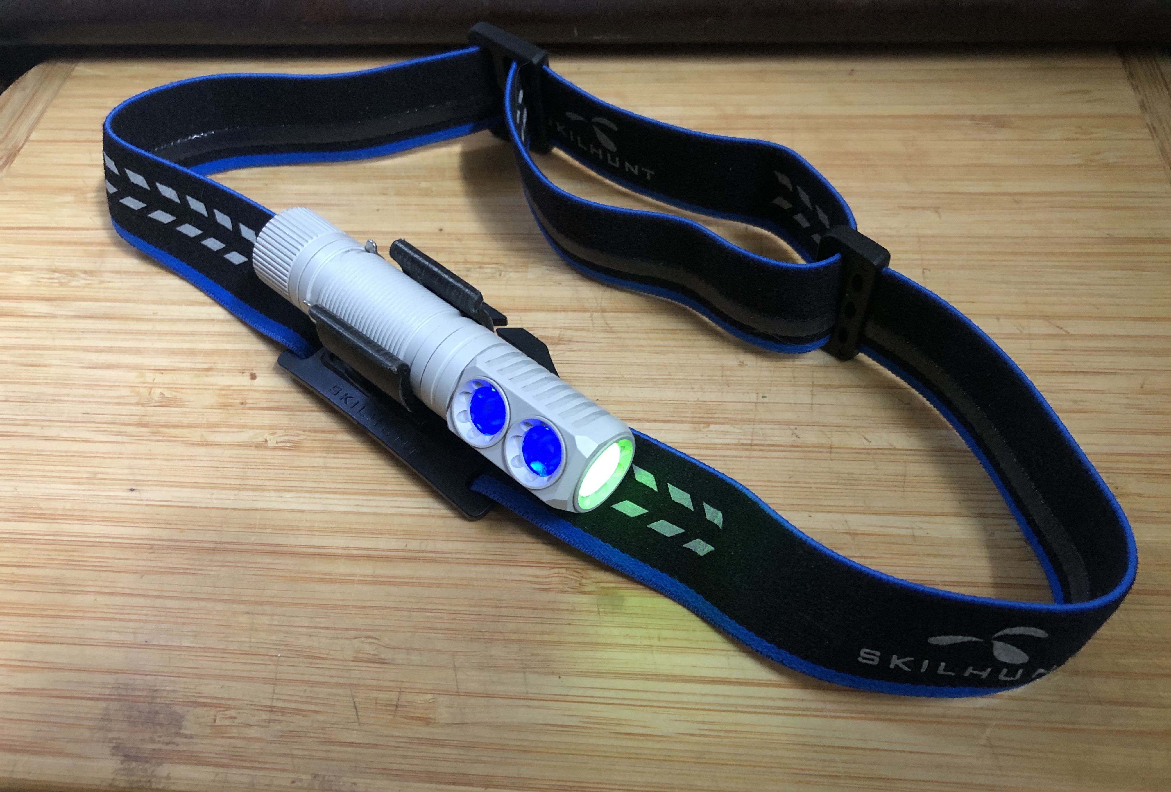

For my AA lights, Im a fan of the Skilhunt HB4 Small headband. It uses a clamp instead of a pair of loops (the jaws are tighter than necessary, I sand them a little):
this is my Emisar D2, uses 14500 LiIon..
I use the same headband for my AA/14500 Skilhunt H150, and when my AA only Zebra H53Fc N arrives, it might go in a Skilhunt headband also
I do think the Skilhunt headband is, by far, the best, but the little pull tab system on the Olight one means it works for all kinds of lights.
