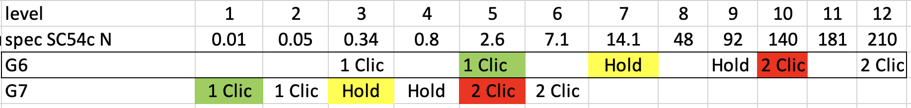

my G6 is
1 Clic from Off for Lows (level 3 or 5); because I want the light to turn on to my lows, for use on my nightstand with 1 Clic. This avoids preflashes and mistaken high outputs.
Hold for Medium (level 7 or 9); because after 1 Clic for On at Low, Hold steps up in brightness. Or from Off, Hold gives me a useful Medium (after preflashing Low).
2 Clic from Off for High (level 10 or 12); because 2C is the common command to reach the highest level in other lights
G7 is all the lowest modes, still 1C Low, Hold Medium, 2C High.
I use this G7 to test which 2 modes I want to program to G6 at 1 Clic. The lowest useful level for middle of night walk to bathroom, without stepping on the cat or her toys. My second lowest for enough light to walk through the house after I turn off the lights at night.

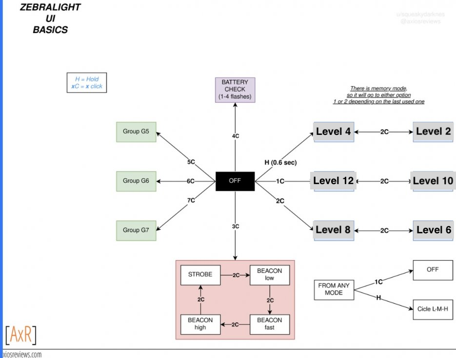

This thread has the original inputs from @Lips regarding how to program, I found it very helpful.

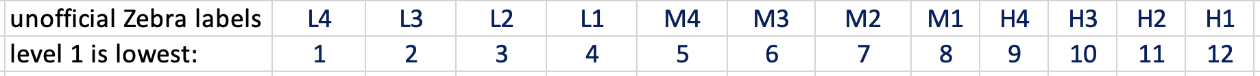

Great chart but it uses terms like L1, L2 which are very confusing, they actually mean Level 4, Level 2, so I changed the notation in this copy of that chart for clarity:
here are two types of notation:
but Zebra uses L2 to mean levels, 1, or 2, or 3, so even more confusing. I find using level numbers 1 - 12 makes the most sense.
