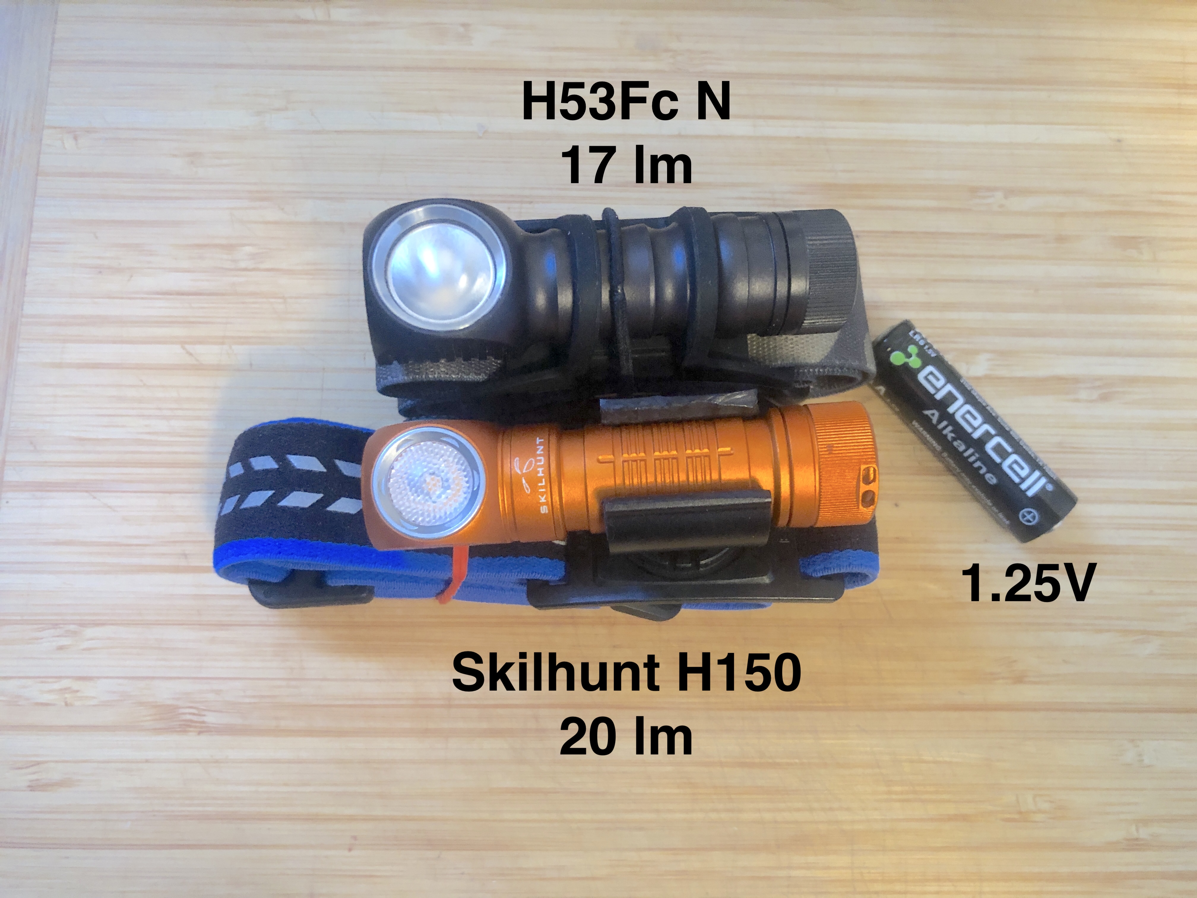

I just tested my 2023 H53Fc N on an old tired Alkaline, maximum output is 17 lumens. My Skilhunt H150 gives 20 lumens maximum on that same battery.
That battery in my 2023 SC53c N gives 25 lumens maximum, and in my Emisar D3AA gives 9 lumens maximum.

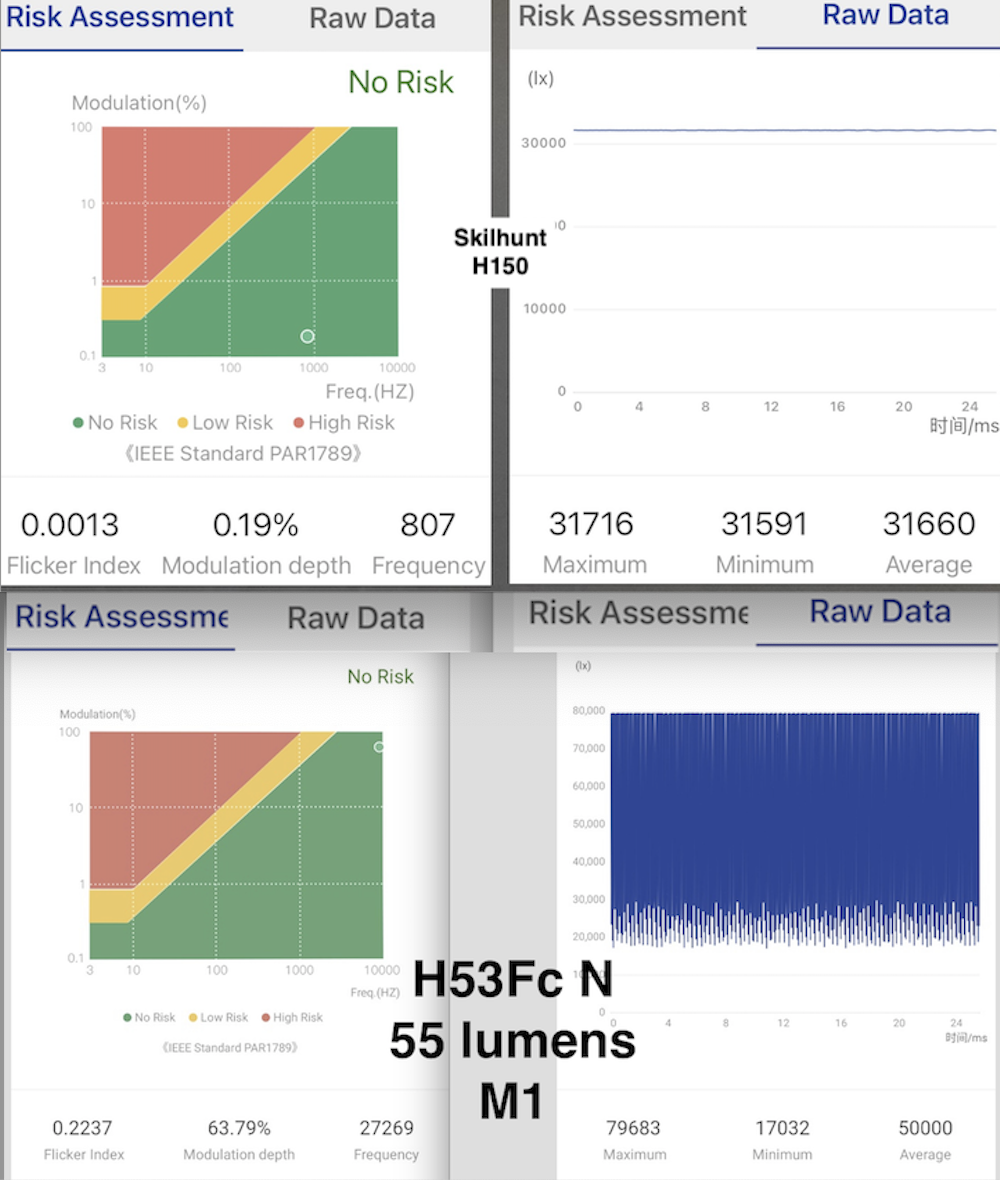

11. Very steady Lux, much lower Flicker Index, no Deep Modulation:

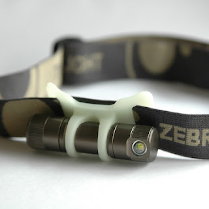

Was Zebralight the first manufacturer of angle lights?
possibly one of the first Right Angle LED Headlamps in Tube format.
I think Petzl had other headlamps before that, but they were not Tubular bodies w right angle heads..
a Headlamp was Zebralight's first product
the Zebra spreadsheet says the H50-P4 (first entry at bottom of sheet) was:
"The very first ZebraLight product. World's first "cylindrical with rubber loop" headlamp ever invented"
This ZebraLight H50 headlamp was indeed
the VERY FIRST light which I ever ORDERED from China ! ! !
Still have mine.

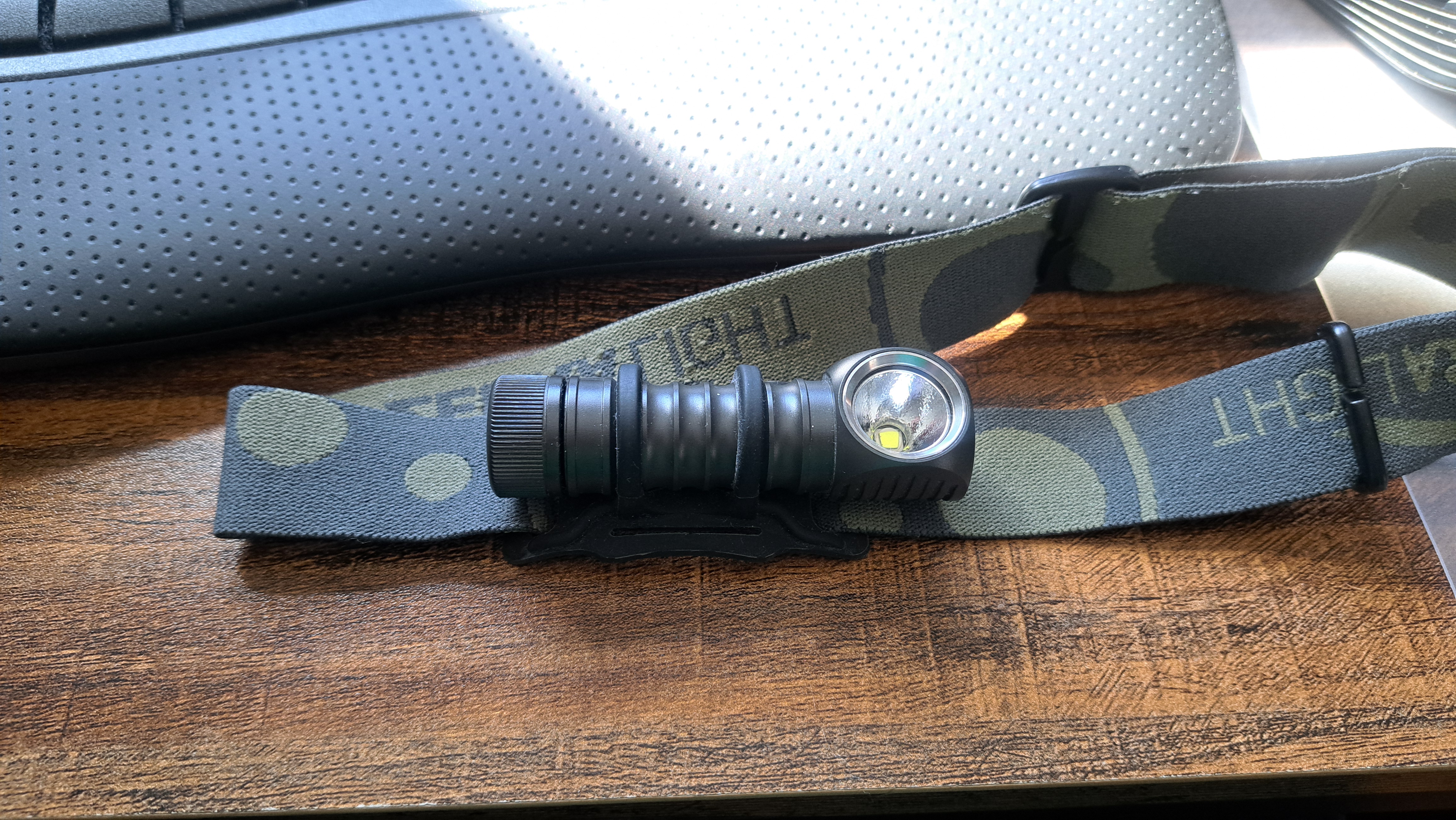

I bought some of the first zebralights that were offered a bunch didn't have any markings I will have to get together some pics. Is this one an H52? Not an early one.
