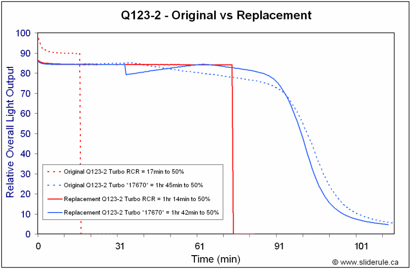

IIRC in Selfbuilt's review the Q123-2 17670 ran something crazy like 1 1/2hrs or so to 50% and was the best light/battery combo in the Quark series, the 2xRCR123 in the Q123-2 only lasted like 15min.
It was a defective Quark. With a correctly working replacement, the runtime was 1:14 for RCRs and 1:42 for 17670. I think that the 17670 dropped out of the regulation after ~35 minutes (hence the sudden drop in the output) but the output remained close to the 2x RCR one.
You are seriously going to tell me that little burp in the graph make a lick of difference? A TEMPORARY ~6% drop? Give me a freaking break... :crackup:
http://i243.photobucket.com/albums/ff97/selfbuilt/Q1232-Replace.gif
The original sample didn't even have that burp, and plenty of people are using the 123^2 in the 17670 setup and are EXTREMELY happy with the superior performance...
Same output, longer runtime, and no sudden shutoff.
That graph shows it out of regulation for much of the runtime. What might be very impressive is this: Quark 123x2 head, 2AA body, 2 x 14500 cells.
Where did I say that it makes a practical difference?
I wrote previously that the 17670 will hold the voltage much better than an RCR. I think some of them may even stay in regulation for the full runtime. I'm also not disputing that a 17670 is a better practical choice. This drop is just an interesting artifact on the graph that I thought may be caused by the light dropping out of the regulation, that's all.
For easier reading, here is the selfbuilt's graph:
