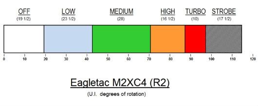

Not sure I would call it a mechanical switch. With the ring off of the flashlight, you have a metal tab on the inside of the ring that, when on the flashlight, is stopped in its 90 degree travel by tabs machined on the flashlight head. With the ring off, you can activate modes by placing the ring near the correspond area on the flashlight head to turn on the flashlight. So if you glued some thin material on the the plastic tab on the inside ring you could prevent the metal tab from being able to ride above the area that activates strobe.
Make sense.
This shows part of the reason for the UI manipulation problem between the turbo and strobe modes. The separation between modes is NOT uniform! The combined high and turbo modes are LESS THAN the single medium mode.
It's understandable why users tend to overshoot the high and turbo, into the strobe, if they are not careful.
Disclaimer: This chart is based on a sampling of one. Accuracy is approximately + 3/4 degree.
EDIT: CORRECTED ERROR IN DEGREE SPREAD CALCULATION.
There's a magnet embedded into the selector ring. It will be easy to lockout Strobe by filling the last amount of the threads the selector ring travels in. Silicone caulk would be more reversible than epoxy.
