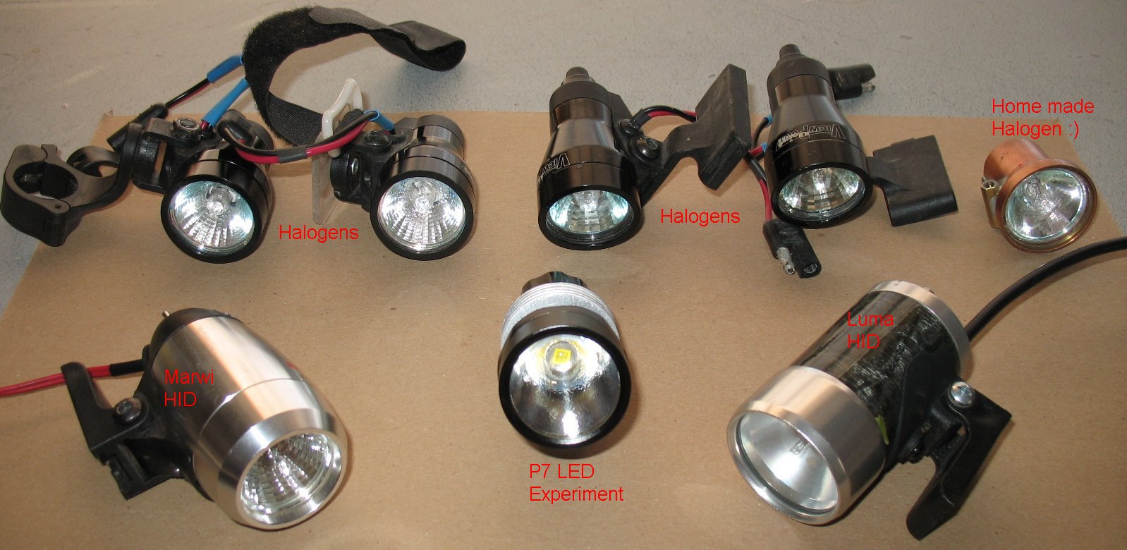

I converted a P7 LED flashlight from deal extreme and a Marwi View Point halogen light.
Both now have P7 LED's installed.
Still waiting on several of the 18650 2400mah lithiums from deal extreme so I can put togther battery packs. Been testing them with 4000 mah NiMh batteries.

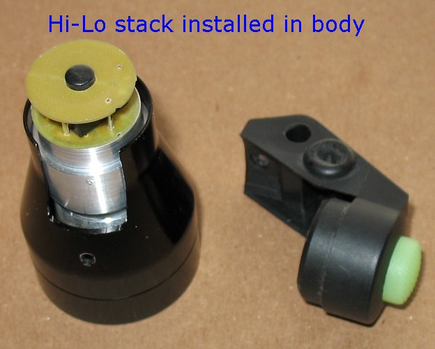

That black plastic piece bolts to the light and then slides onto the marwi handlebar mount.
I just did not have it bolted to the light in the pictures.

Also, I forgot to mention in the post above that I have ordered some of the 1400ma driver boards and the 5 mode boards from DX.
I am going to install these boards in both projects to get some current regulation and to be able to have a low light mode for long uphill climbs
