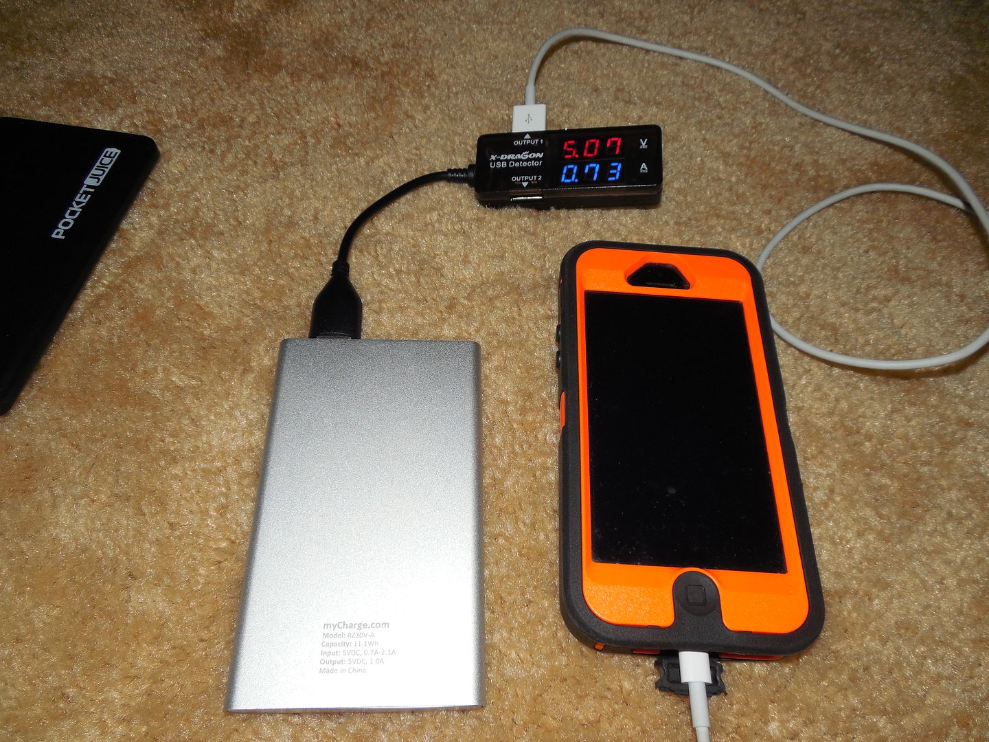

Voltage and amps when charging off a wall USB.
I think the power function is the voltage times amps.

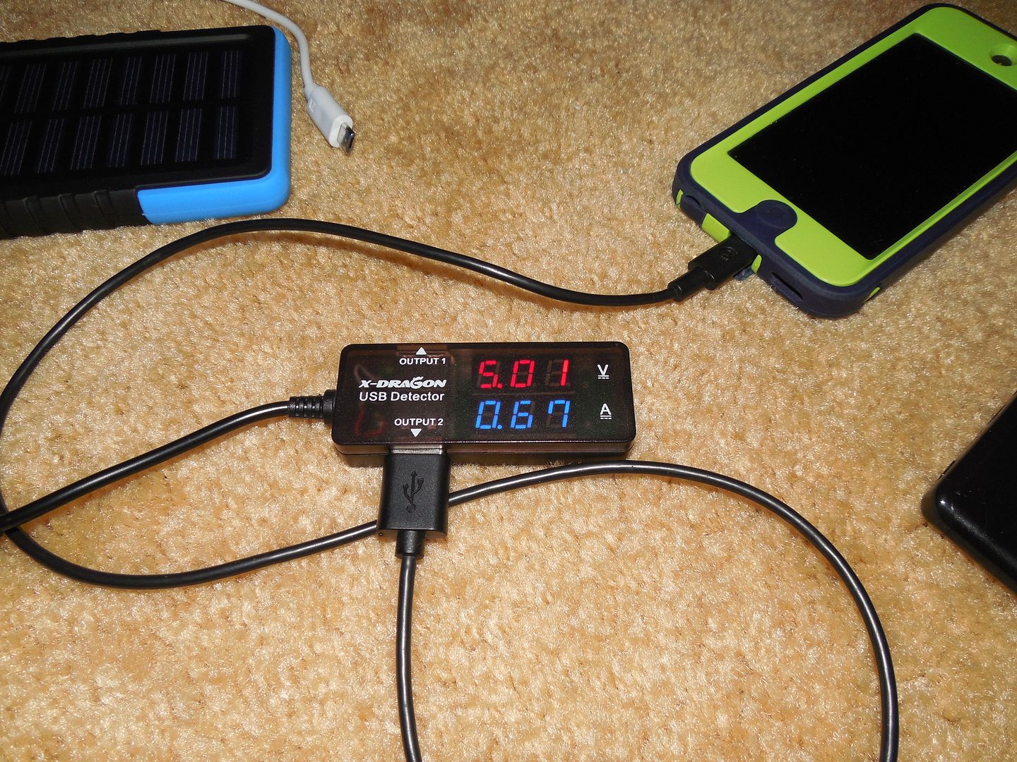

Charging an Ipod. The 5.24 turned into 4.8ish then crawled up to 5 volts. The yellow solar power bank had a bit harder time stabilizing. Then again it was 7.80 shipped.

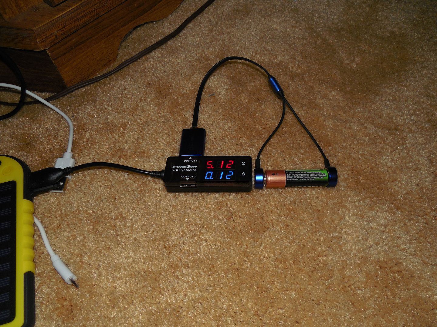

1XAA.
iPhone SE being charged from powerbanks.
Charging from a powerbank.

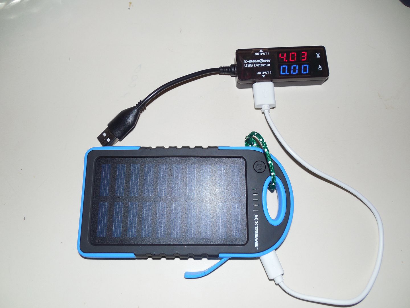

I noticed something unusual when solar charging (with a larger 14w panel) this solar powerbank. It turned on the controller voltage/power red LED light from the larger panel without any sun from the input. I never seen any voltage from an input from a powerbank so tested it. Zero amps but it is showing voltage. It is showing the battery voltage. The yellow solar power bank nor any others I own does that. Any guesses? I am thinking some kinda short but have no clue. That said without the detector I wouldn't know it was the battery voltage and not from the USB 5 volt step up.
