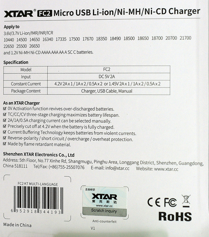

Xtar FC2 Charger - Made available for review by Xtar
A) Uses USB input ( 5v 2A needed )
B) Can charge one battery at 2A or two batteries at the lower 1A and 0.5A settings . ( dependent on USB power supply )
C) Starts charging at constant current till ( at or close to ) 4.2 volts it switches to constant voltage ( 4.2v ) and begins to drop the charge rate .
D) LED's flashing indicate the battery is being charged - when they all go solid the battery is charged .

What is TC/CC/CV three stage charging process? What TC stands for?
old4570
Feb 15, 2009
2,871
Melbourne - Australia
Re: Xtar FC2 Charger Review / Preview
• TC phase: cells discharged below 2.9V are "woken up" by a lower current.
• CC phase: after reaching 2.9V, the cell is charged with 0.5A DC.
• CV phase: when the cell is almost charged, the charger switches to charging with decreasing current until it reaches 4.2V on the cell. After reaching 4.2V, the charging process is completed - the battery is fully charged.
Normal circumstance = Constant current and increasing voltage / followed by Constant Voltage and decreasing current . =/
http://www.premiumestore.com/08-technology/p-001-1ef73.html?id=33 / Better description ..
