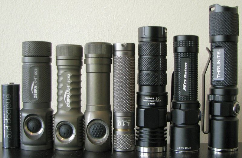

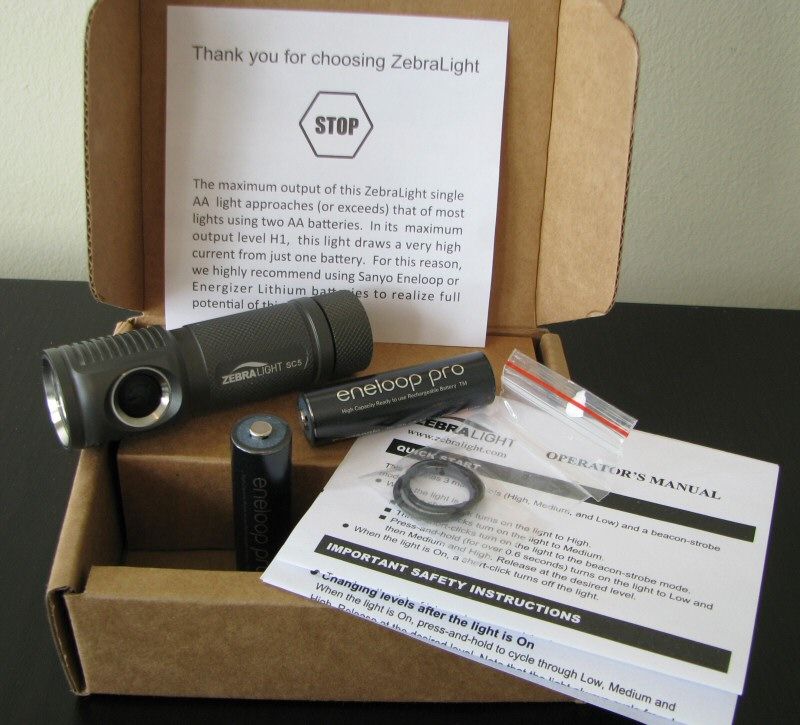

The SC5 came in the standard "eco-friendly" packaging that has been standard on Zebralight for some time now. Included in the simple (but firm) cardboard box was the light with removable clip (attached, with screws), two extra o-rings, a one-page instruction sheet and battery warning. My review sample came with a couple of Eneloop Pro AA NiMH batteries, but these are NOT included with the shipping lights.
From left to right: Panasonic Eneloop Pro AA NiMH; Zebralight SC5, SC52, SC51; L3 Illumination L10; Skilhunt DS15; Olight S15; Thrunite Archer 1A V2.
Zebralight SC5: Weight 58.3g, Length 81.5mm, Width (bezel): 22.6mm, Width (max) 27.0mm
Zebralight SC52: Weight 39.5g, Length 79.0mm, Width (bezel): 22.6mm, Width (max) 25.4mm
Zebralight SC51: Weight: 37.4g, Length 80.5mm, Width (bezel) 21.1mm, Width (max): 22.6mm
Fenix LD12: Weight: 52.3g, Length: 99.9mm, Width (bezel): 21.6mm
Nitecore MT1A: Weight: 54.6g, Length: 104.6mm, Width (bezel): 22.7mm
Olight S15: Weight: 46.4g, Length: 87.0mm, Width (bezel): 23.1mm
L3 Illumination L10: Weight: 20.7g, Length: 79.4mm, Width (bezel): 17.1mm
Lumintop ED15: Weight: 59.7g, Length: 100.2, Width (bezel): 21.9mm
Skilhunt DS15: Weight: 52.0g, Length: 92.1mm, Width (bezel): 24.0mm
Thrunite Archer 1A v2 CW: Weight: 66.9g, Length: 109.6mm, Width: 23.1mm
Thrunite Neutron 2A 2014 (1xAA form): Weight: 57.6g, Length: 95.6mm, Width (bezel): 25.6mm

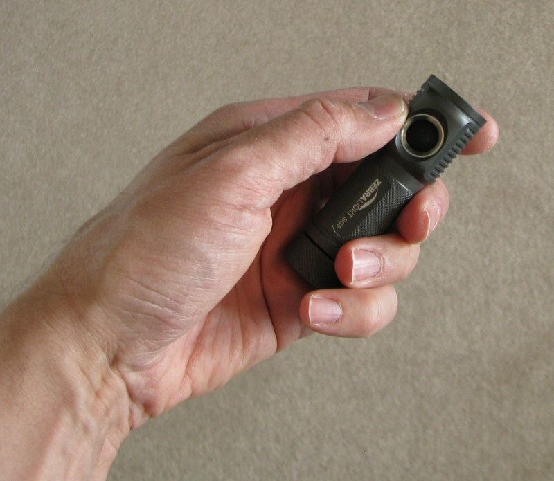

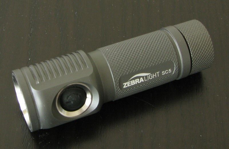

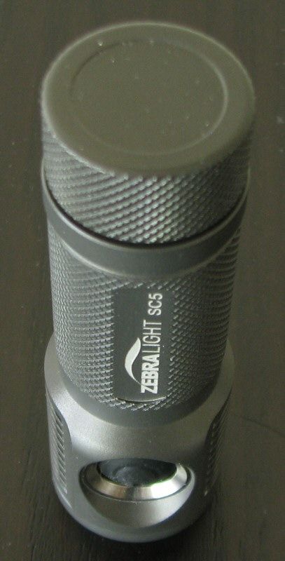

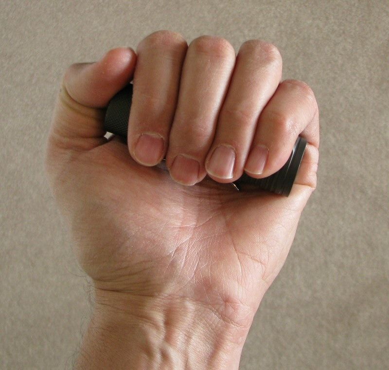

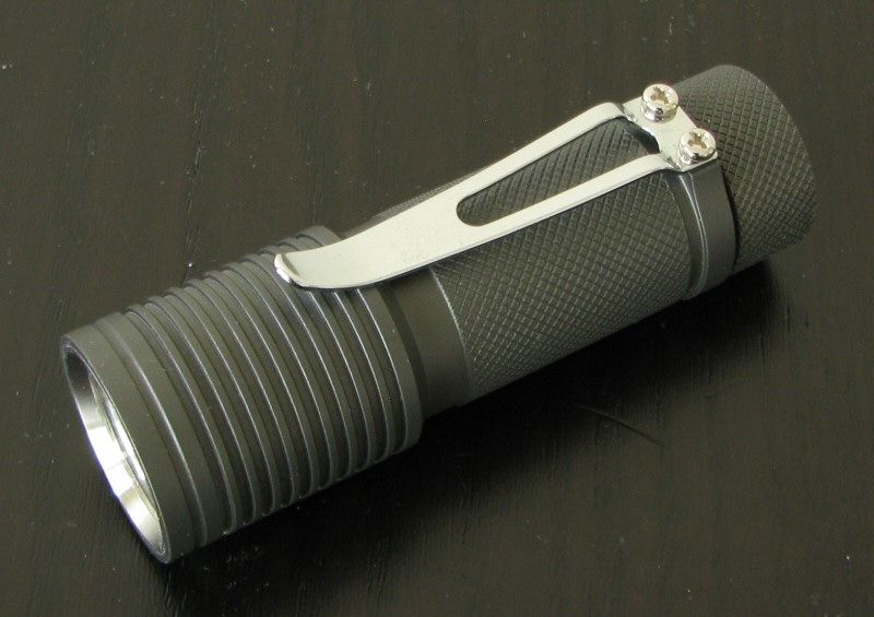

The overall build of the SC5 has been updated from the earlier 1xAA Zebralights, and is now a bit larger and heavier. It also has actual knurling over the whole body, of reasonable aggressiveness. I understand the extra space was required for the circuit, to add additional functionality (and I'm guess more heatsinking as well).
Anodizing (on my sample) has returned to the more traditional Zebralight gray "natural" finish. Previous lights were a bit more gray-green.

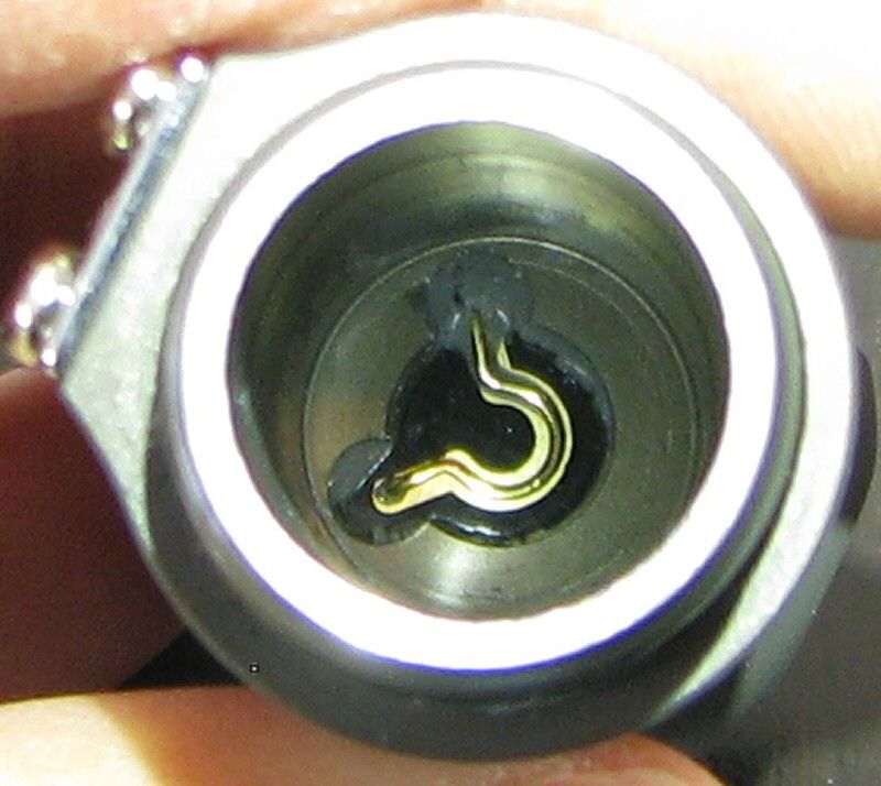

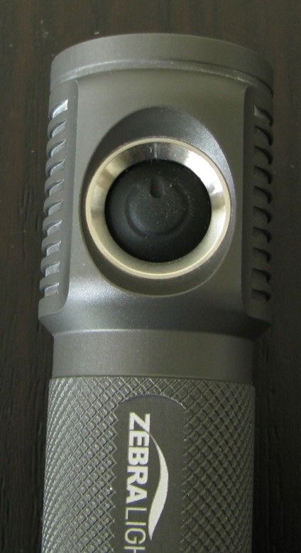

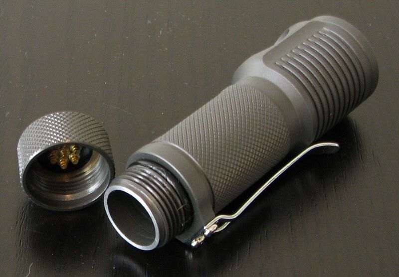

Switch is an electronic switch, recessed to reduce the risk of accidental activation, as before.

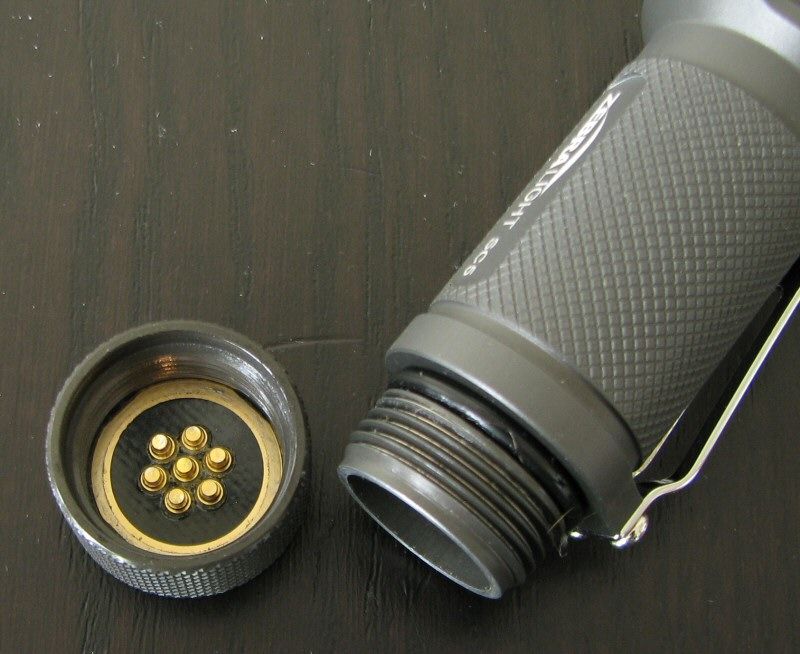

Tailcap now has a number of small raised buttons, with some spring action underneath each one. These are apparently known as "pogo-pins", and help save some length. Contact in the head has changed as well – please see my video for more details.
Tailcap threads are anodized as before, allowing for tailcap lockout. The light can both tailstand and headstand.

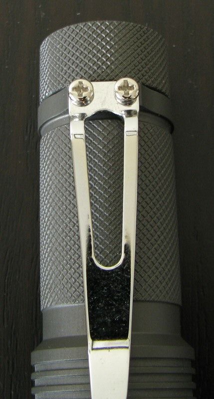

The light comes with a removable metal pocket clip, held in place by two regular Phillips head screws, as before.

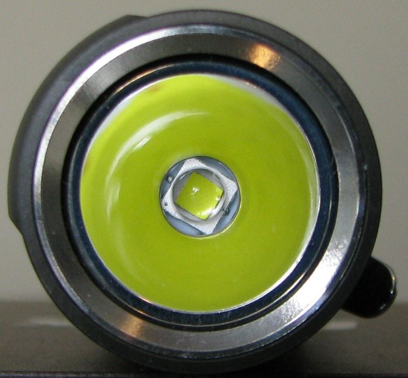

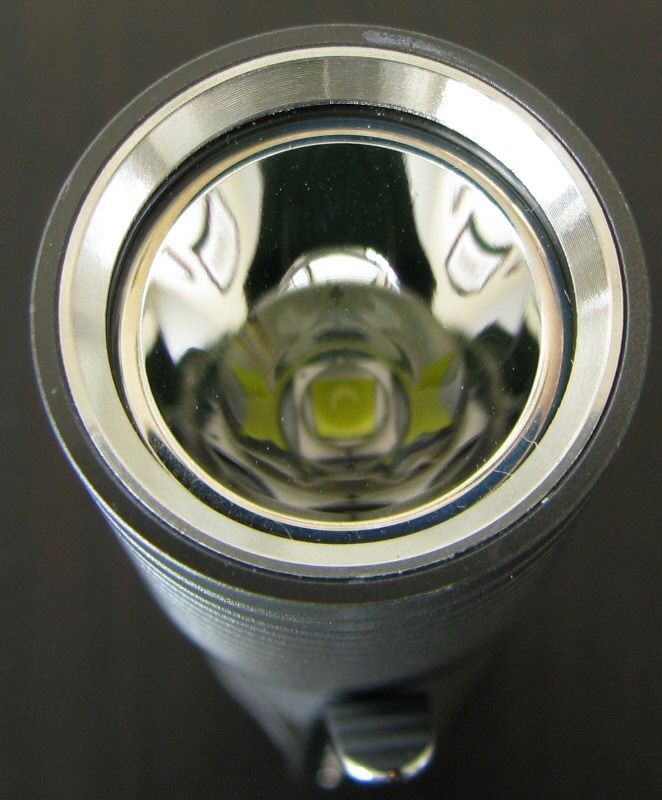

The head is wider now, with a wider and deeper reflector on the SC5. Reflector is smooth now on my sample (was lightly textured before). The cool white XM-L2 emitter was not perfectly centered, but was more than acceptable.

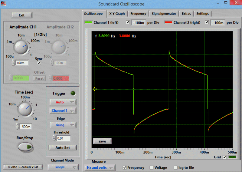

PWM/Strobe
As with my other Zebralight lights, I don't see any signs of pulse width modulation (PWM) on any the lower output modes. The light appears to be fully current controlled at all levels. :)
Fast Strobe:
The fast strobe mode is a disorienting ~15Hz tactical strobe.
Slow Strobe:
The slow strobe is 3.9 Hz on my sample.

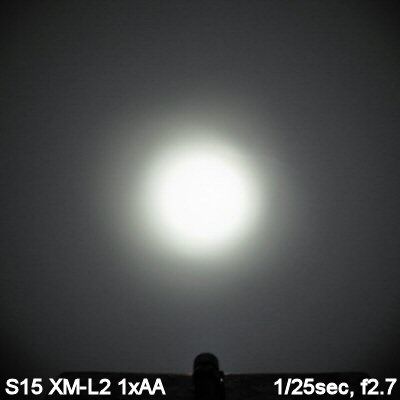

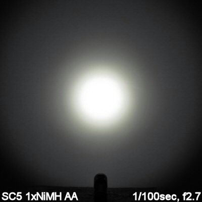

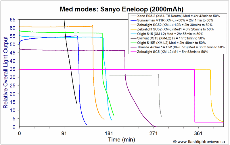

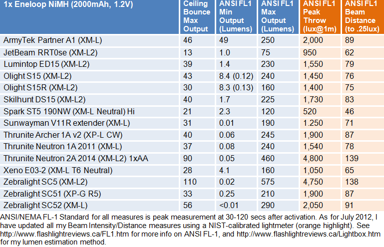

All lights are on Max output on Panasonic Eneloop Pro AA NiMH. Lights are about ~0.75 meter from a white wall (with the camera ~1.25 meters back from the wall). Automatic white balance on the camera, to minimize tint differences.
As you can see, that's a stunning amount of output from single NiMH AA battery! :eek:oo: Scroll down for testing results.
That is a remarkable max output increase on NiMH – nearly double the max output of the SC52, which had been the previous class champ. :eek:oo:

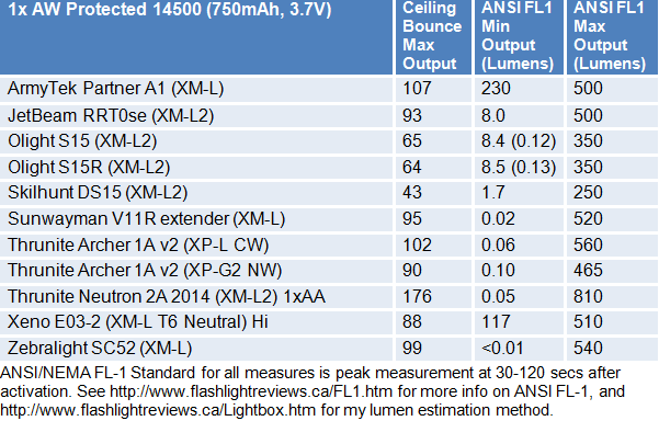

To put that in perspective, here is how it compares to typical 1x14500 lights (including the older SC52):

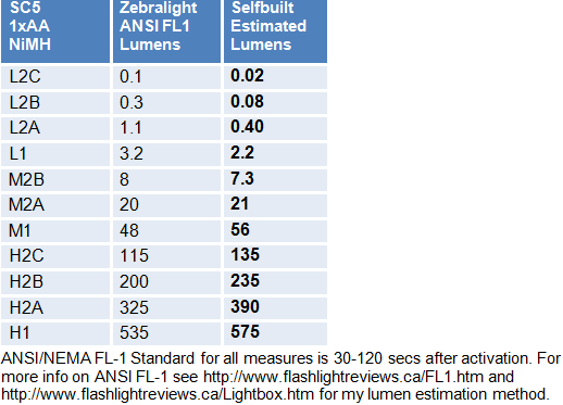

No doubt about it, Zebralight has managed to produce the first 1xAA light that can reach output levels previously only attainable by 1x14500. Given the increase work capacity of current NiMH batteries, 1x14500 has been rendered completely obsolete.
As you will see above, my lumen estimates are pretty close to Zebralights specs (at least for non-moonlight modes). But as always, note that my lumen estimation method is just an estimate based on the calibration of my lightbox. As such, don't get caught up on the absolute difference between lights or levels, as I can't guarantee absolute accuracy. Focus instead on the relative differences, as that is internally consistent across all my reviews.

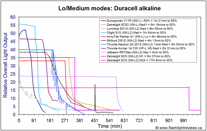

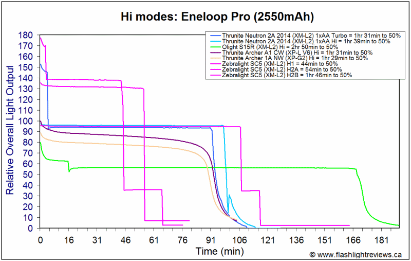

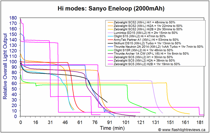

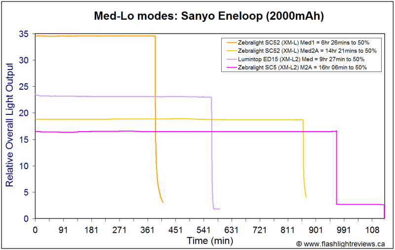

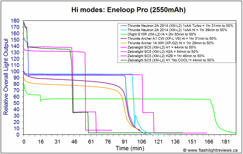

Output/Runtime Graphs:

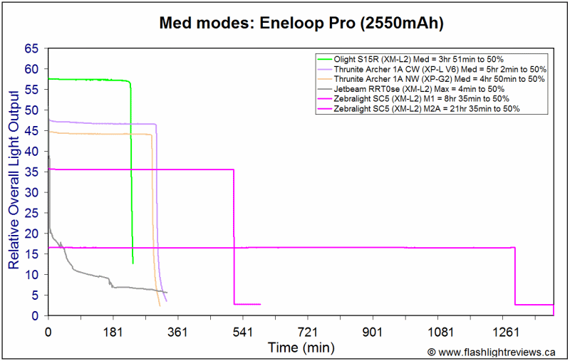

Fortunately, I have been moving my NiMH AA testing to the newer Panasonic Eneloop Pro NiMH anyway (2550mAh typical capacity). :) Below I will show results for both these cells and the older Sanyo Eneloop 2000mAh capacity cells.
Note that all my standard runtimes are done under a cooling fan, as always.
The performance of the SC5 is simply outstanding. Overall efficiency and regulation are comparable to the SC52 on the lower levels (which was always best in class). But at the highest levels, the SC5 blows away anything in the class in terms of output. :eek:oo:

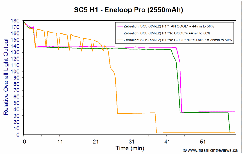

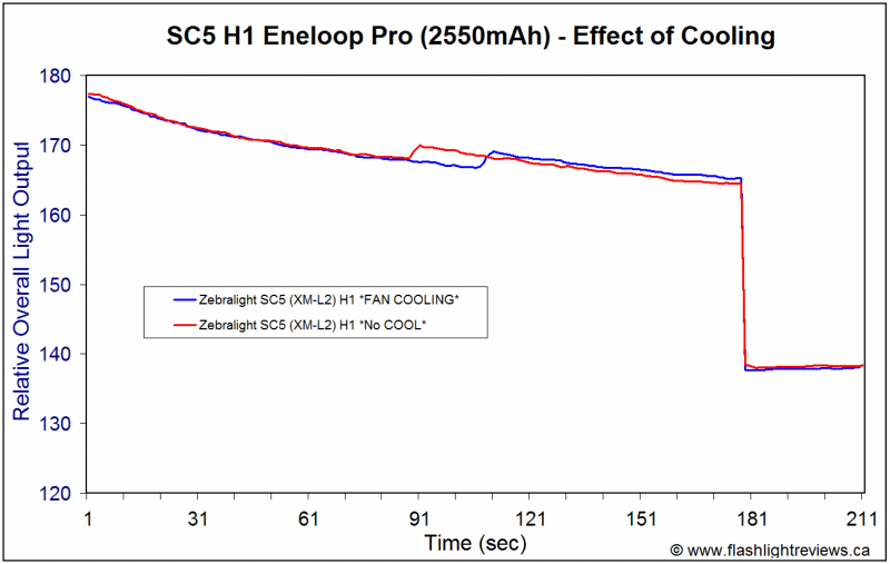

UPDATE JUNE 28, 2015: For those of you wondering how the SC5 on Eneloop Pro compares to the SC52 on AW 14500:
UPDATE JULY 1, 2015: For those of you wondering if there is an undocumented and uncalibrated PID that could still kick in on non-cooled run, here is a comparison:
Although there is a slight drop-off in output over time (after timed step-down), the light never triggers a typical PID step-down in my testing. Since it is hard to see the initial difference on the graph above, here is blow-up, on a 1-sec scale resolution
Basically, there is no difference. I've done a couple of re-tests, and the small jump up can occur at variable times (i.e., doesn't seem to be heat related).
UPDATE JULY 2, 2015: Repeated re-starts on H1 are compared below:
As you can see, there is no evidence of a PID being engaged at any point. The eventual step-down to lower levels occurs as normal. Note that I got just under ~25 mins on my Eneloop Pro before the light dropped to the lower levels (with only a few seconds for each step-down before re-starting). Note that I do NOT recommend you force repeated restarts of the H1 level on the SC5. This is clearly not what the manufacturer intends, and it is not good for a NiMH to be driven to those kinds of levels indefinitely.
The voltage limit has been lowered to 2V, so 14500 is NOT supported. But given the incredibly high output level on NiMH, there would be no point anyway. Newer NiMH cells have a greater capacity to do work than 14500. Do not attempt to use 14500 cells in the SC5.

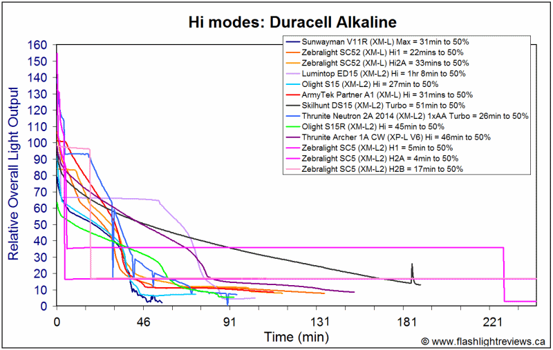

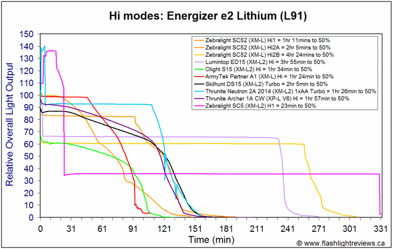

Given the heavily-driven nature on the highest levels, stick with good quality NiMH. Alkaline batteries will not perform well at all on these levels. Fresh L91 lithium shows a lower H1 max output initially (likely due to the low resting voltage), but it rises over time as you drain off some capacity.

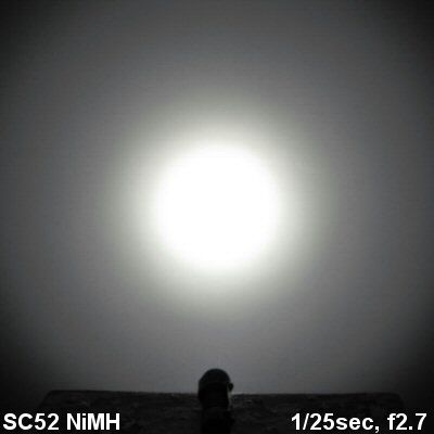

Due to the larger head and smooth reflector, the beam pattern of the SC5 is slightly "throwier" than the earlier 1xAA models. It's not a huge difference - although the greater max output also helps to further extend the max reach of the light.

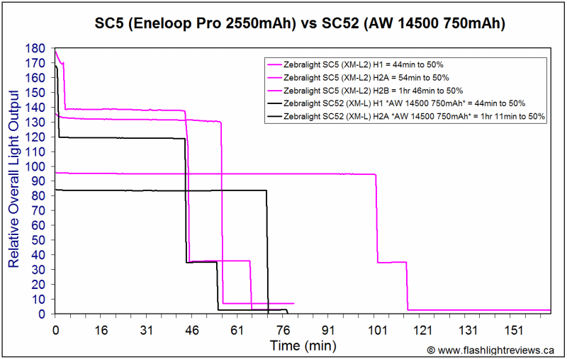

Is there any way you could show a graph comparing a sc52 on 14500 compared to this on one of the enloops? To us sc52 owners that is the comparison we are after.
selfbuilt
May 27, 2006
6,999
That's a good idea - here you go:
Pretty conclusive to me as to the advantage of Eneloop Pro on the SC5. And not just for the efficiency and output gains, but also the ability to keep the low voltage warning by low mode step-downs is very helpful.

I suppose it's just my imagination since I believe your test results, but I think I'm being influenced by the way the voltage meter on the SC5 seems to read less then 4 flashes after just a short usage, as opposed to the 14500 powered SC52's which shows 4 flashes much longer and after more lighting duty?
I suspect this part might be heavily affected by the chemistry differences in the two battery types. The best reference I could come up with at short notice are two bookmarks on HJKs site:
http://lygte-info.dk/info/ComparisonOfAABatteryChemistry UK.html
http://lygte-info.dk/info/BatteryChargePercent UK.html
If you pay close attention (I guess the 0.1A NiMH discharge curves are the best ones to compare with the resting voltages on the second lithium ion related URL) you'll observe that Lithium ion is a lot more linear until it finally drops off, NiMH drops a lot initially and then very fast again towards the end. Also in my own experience lithium ion rechargeables recover faster to their resting voltage than NiMH, so after using the torch give your sc5w's battery some time to recover and then do the 4x click maybe this'll make the indications more consistent?
I remember back when I used my sc52w a lot more that at times after a fair period on high 4x click would reveal 1 flash, but given some time to rest it'd either do 2 or 3 a minute later.
Voltage is not a good indication of remaining capacity for NiMH.
Hope they send you a SC5w to test too
Yup..battery voltage sag with loads this great are present in both chemistries, but higher voltage Li-ion's seem to sustain it better. I run most of my lights with Li-ions and rarely use Eneloops other than in remotes, cameras, etc. And you're correct...that when some time passes after using each light (SC5 & SC52), the flash count goes up one or two "flashes" sometimes, with the Li-ion recovering much quicker...and it had seemed, perhaps incorrectly by me, that the Li-ion pwr'd SC52 lasted a few days longer in general use.

Jebus, 500+ lumens off a NIMH. Was only a few years ago we were like, "500+ lumens off a single li-on is insane".
Not just any NiMH though. The eneloop has revolutionised high drain in a regular consumer market. The specialist cells like the elite 1700 and 2000 were always able to deliver big current but had limited itself to the hobbyist.
That said, SB, are the cells you have the Japanese or Chinese made eneloops? I think the north American market is a mix of both.
