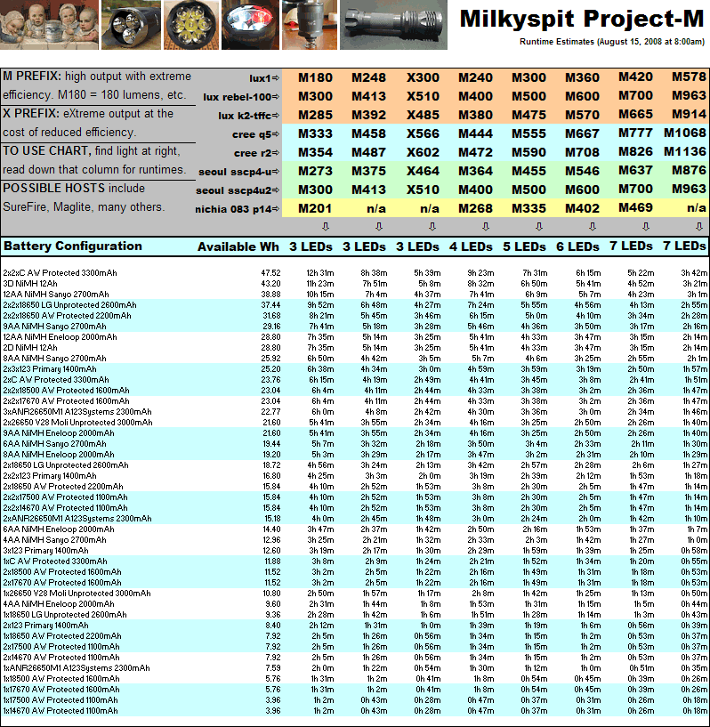

If I were in your shoes, I would buy a Milkyspit Project-M light.
They are custom made mods which are available in a number of configurations. You can choose a host, and output up to 876 lumens.
Have a look at the possible configs here: http://www.milkyspit.com/i/img-m-runtimes.gif
Their build quality is reputed to be second to none.
You also could go the mag mod route (including black bear mods) if you wanted.
BurkStar
Dec 6, 2004
97
Those do look impressive! Quite a few different configurations, but how do you figure out the Lumens from that chart?
