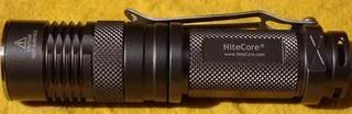

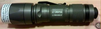

    As you can see, the extreme comes in the same sort of packaging as the other EDGETAC lights. Included in the sturdy box (with foam inserts and metal closing clasp) are the warranty card, manual, and spare parts (including two extra forward clickies, mini-Allen key and some o-rings).
    Overall design is similar to the NDI, although bulkier and more substantial. This extra mass (and heatsinking fins near the emitter) should help to dissipate heat fairly well. The light features the same “anti-roll” rings as the NDI around the head and tailcap, but the attached clip is really the most useful anti-roll device. The bezel-pointing clip is a new feature on this light, and feels quite substantial. It is removable, attached by a couple of hex screws (mini-Allen key wrench included with the spare parts).
    Build quality is top-notch on my sample – no visible machining marks, anodizing is flawless and smooth. Anodizing is a very dark slate gray natural finish (HA-III), almost black. There is diamond pattern knurling around the main body portion of the light. Lettering is clear and sharp (I'm guessing laser etched). Note the general lack of identifying labels (early version NDIs and RaidFire Spears were a little over the top ).
    Like the NDI, this version of the Extreme features a crenelated bezel with 3 points, allowing you to tell if the light is on when standing face down. Note that this introduces something of a “triangulation” of the spillbeam pattern up close (i.e. looks like a rounded triangle at close range). An alternate version of the light is sold with a smooth stainless steel bezel ring that doesn’t produce this pattern.

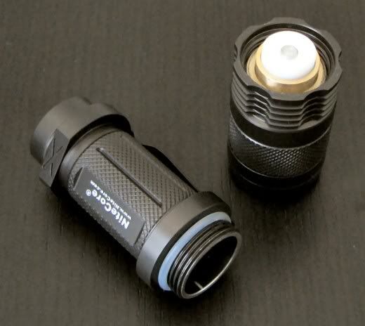

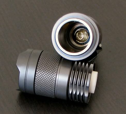

    I haven’t tried accessing the head yet, but you can see it uses a fairly substantial heatsink below the emitter (I’m guessing brass). This is very reassuring given the very high output the light is capable of on max.

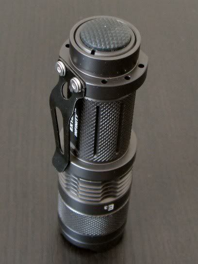

    There is no separate tailcap portion to this light, so no tailcap lock-out is possible (switching occurs through the head, so no lock-out is possible there either). So, you may ask, how do you change the forward clicky switch if you need to? There’s an exterior switch retaining ring located around the switch boot cover. An interesting design I haven’t seen before.
    One issue with this design is that there is no way to “push” a tight-fitting battery out of the tube – you need to “pull” it out by the positive end. It would therefore be ill-advised to force a protected battery down the body tube. All of my black-label AW protected RCRs fit fine (although the earlier ones are a bit snug). Unfortunately, my blue-label AW protected RCRs seem to be too thick to fit down the body tube. I’d recommend those with blue-labels consider upgrading if you want to use RCR in this light. My gray Ultrafire protected also seems to be too tight a fit. YMMV…
    The forward clicky has the exact same feel as on my NDI, although I haven’t disassembled yet to confirm whether or not they are identical.

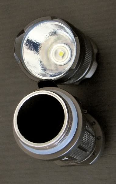

    As you can see above, the Extreme uses the new “silver” version of the Cree Q5 emitter (i.e. the area outside central die is silver in color, instead of the standard Cree yellow). My understanding is that there are no output differences between the silver and yellow versions, and these simply reflect different manufacturing plants. Light uses an aluminum reflector with modest texturing (i.e. I’d consider it a medium orange peel, MOP).
    The lens supposedly has a “diamond coating” exterior and anti-reflective interior coating. Obviously, I have no way of testing that, but it looks clear and clean, like all my EDGETAC lights.
    The o-ring between the head and body is fairly thick, making it stiff when tightening the head all the way to the body. Resistance is higher than any of my NDIs, and definitely requires use of two hands to switch modes (scroll down for a discussion of the interface). This may be done on purpose to improve waterproofness. Note the light ships quite “dry” – little or no lube on the threads and o-rings. I know from experience with NDIs to avoid getting any lube on the threads in the head, as this can cause contact/mode-switching problems due to the interface.

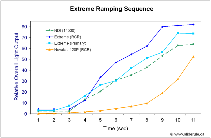

    Variable Output ramping time
    Update: I've just done the ramping sequence analysis for the Extreme. As you can see, performance closely matches the NiteCore Defender Infinity (NDI). On primaries, the Extreme seems have a virtually identical ramp to the NDI on 14500. On RCR, I would say my Extreme ramps up about ~1 sec faster. Note that the EDGETAC offerings are lot more visually linear than the Novatac 120P (although that is intentional - the Novatac steps through half-values of 120 and 85 lumens as it ramps).
    Note that unlike some makers, the ramping sequence is very linear in EDGETAC lights.

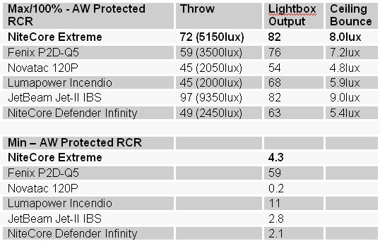

    Testing Method: All my output numbers are relative for my home-made light box setup, a la Quickbeam's FR.com method. My relative overall output numbers are typically similar to his, although generally a little lower. You can directly compare all my review graphs - i.e. an output value of "10" in one graph is the same as "10" in another. Ceiling-bounce tests are done in a small windowless room, with my light meter on the floor near the base of the light (which is shining upward in candle-mode). Throw values are the square-root of lux measurements taken at 1m using a light meter.
    Summary Chart:
    In terms of estimating max total output, I believe the ceiling bounce numbers are the most accurate (my milk carton lightbox tends to underestimate at the really high-end of outputs). As you can see, max output of the Extreme on RCR is considerably more than the NDI.
    The Extreme is in fact one of the brightest 1xCR123A/RCR lights in my collection – second only to the continuously-variable JetBeam Jet-II IBS. FYI, note that output of the Jet-II is underestimated slightly by my lightbox, since it doesn't like really strong throwers. The Extreme is also slightly brighter than the direct-driven Fenix P2D-Q5.
    In terms of minimum output, the Extreme is unfortunately a bit brighter than the NDI, but close to the continuously-variable Jet-II. Note that nothing compares to the Novatac for a truly low low mode. The Extreme also has greater throw than most of the other lights here (except for the Jet-II, of course). I will need to play with the Extreme more at night before I can make any judgements about the usefulness of its beam (typically, I don’t like a pronounced hotspot on low-output lights).

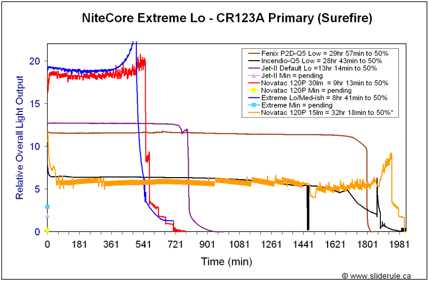

    Runtimes:
    Note:Like the NDI, the Extreme does NOT have defined medium/low modes – rather, the light uses a continuously variable digitally-controlled brightness level. For the purposes of this review, I’ve manually set the Extreme to a number of output levels for comparison purposes. I’ve labeled these as “-ish” settings, since they are only approximate.
    Note as well that there can be a pronounced difference between RCR and primary CR123A on any one specifically-set User Defined mode. At the higher end of the range, CR123As are just a little dimmer than RCR. But at the low end of the range, CR123As show quite a bit less output.
    *NOTE: Although the Novatac 120P run was started at 15 lumens (level 16), the light output quickly dropped in half to 7.5 lumens (level 14) for the entire run. Not sure why this happened, but I've left the trace in since it gives you a good comparison to the Incendio low level.

    UPDATE June 17, 2008:
    EDIT: Just completed the Min output mode runtimes, and my results seem low on primaries. I've checked this EDGETAC, and they are looking into whether its an issue with my specific sample or the final circuit in general. Once they get back to me, I will update this thread with the results. Stay tuned!
    UPDATE October 28, 2008:
    The low mode runtime issue has turned into a rather complicated problem, and one that goes far beyond Edgetac and this one light. Please see my post #216 in this thread for a detailed commentary.

    Quick question / request:
    How low is the lowest low? How does it compare to that of the NDI? How about compared to the Lightflux LF2X? Could you post some beamshots comparing the NEx's lowest low with that of the NDI (and maybe a few others - LF2X hopefully?)?
    Thanks,

    Quote Originally Posted by sb_pete View Post
    Great review Selfbuilt! (as always).
    Thanks,
    -Pete
    Hi Pete
    From the first post
    At lower output levels, the Novatac is again the best performer – but the Extreme is still excellent and at least as good as the other regulated competition.
    In terms of absolute lows, unfortunately the Extreme doesn’t go quite as low as the NDI, but it is pretty close to the continuously-variable JetBeam Jet-II IBS.
    Also in the first post, take a look at the Summary chart.
    The second chart has the minimum outputs for all five lights.
