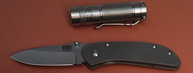

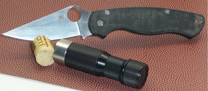

    My daily EDC is a Para2 with the HDS along with a Lamy Swift.
    My dress EDC right now is a Vagnino P-38 EDC with a Ti D25C (neutral XM-L) and a Stainless Jotter.
    I have backed Jason's Ti Alpha pen on KS to replace the Jotter. As such, I really want a craftsman-quality, wonderful custom Ti light to complete the set.
