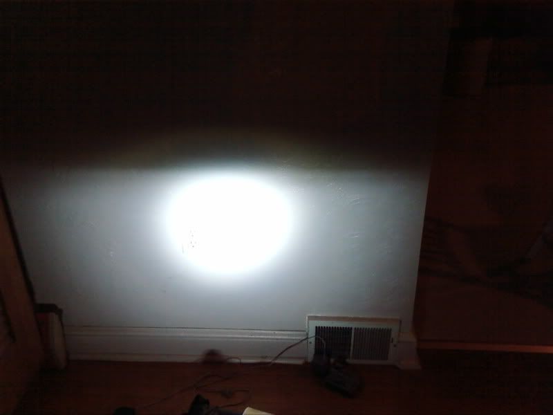

    I'm getting what I think are pretty good results with a simple and inexpensive system.
    Low beam:
    High beam:
    Light with proto paper cutoff device: (low beam is 3+3, high adds the middle 4)
    Light w/o paper (less blurry and overexposed):
    A slightly more complex design could achieve an ECE-type right side to the beam that would light the non-traffic side of the road better. But that's for version 2.

    Quote Originally Posted by LukeA View Post
    Low beam:
    The low beam is similar to what I was seeing with a sheetmetal hood. The difference I think is that your paper hood bends down and blocks the light from the upper part of the beam. If you just kept it as a straight, flat hood and angled it down into the beam, it would reflect the light downwards at an angle, lighting up the area immediately in front of the light. I noticed that with the smooth sheet, there was an obvious hotspot in the reflected light - maybe sputtering the reflective surface would even out the reflected light.
    Along the linesof what Alex said w.r.t. offsetting the optic mount on LED, I wonder if you could just use a reflector and modify the rear of if so that you can mount the LED at an angle. It seems that putting the LED onto the optic at an angle would result in losing a lot of light to reflections off the rear of the optic, while a reflector might still get all the light going out the front (albeit at different angles). The guys playing with the MCE boomerange reflectors seem to have to do this anyway just to get it to mount right:
    That reflector/LED gives an interesting pattern with a bright center hotspot and lots of spill. Could be very useful for a road bike light if you could recover the light that goes shooting off into the trees and clouds and direct it onto the pavement in front of you.
