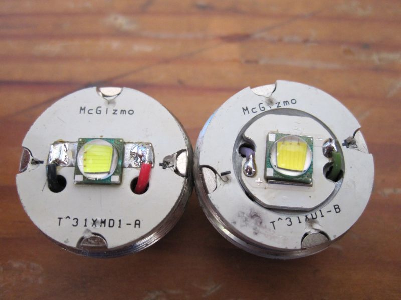

    I posted this in the photos of your lights thread.... but also seems appropriate here
    My new Haiku Light Engine!
    Custom built by DatiLED - Neutral XML LED with custom light engine from
    http://theledguy.chainreactionweb.co...oducts_id=1291
    I think the levels that I chose went 10 , 500 1200 mA
    It does get hotter than the original one on the left but is brighter!
    Of course the downside of such a mod will be significantly reduced runtime...... as well as the heat .
    Probably best to have two heads (one with the original Light Engine setup and one with some mod!)

    Btw, the gdup circuit you linked fits in the standard McGizmo light engine if you just want custom levels. I have them in my lights.

    Default The Titanium "Haiku"
    Yep it has been placed in a standard mcGizmo light engine box and then a new led on top.

    Default Re: The Titanium "Haiku"
    Stoli,
    Why did you not just remove the LED from the McGizmo board and then reflow the new LED onto it? Or did the modified board start life as something else other than XML based?
    Ah I left it to datiLED to do the mod... the XML started life on a different board... and the drice from the sandwichshoppe..
    I think it turned out nicely though.
    It works well.

    My new light engine is definitely a little brighter than the stock XML one but not by a lot and it heats up a lot !
    Unfortunately I do not have another head with the right reflector to directly compare them ... My other haiku has an xpg ... I may need to get another head to compare ...
    Currently I am edcing my new haiku XML and an upgraded titanium RA clicky with a neutral XML ... Hard to go wrong with these two but I must say the haiku is getting more carry time!
    So simple to use and always works!
