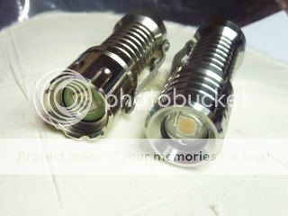

    I have the SunDropB 3S (w/ Nichia 083B LED) from the MAN himself. It is very very useful as a reading light, or walk around the yard at night to search. It is definitely brighter than the SunDrop with 083A.
    My UV light and SunDropB:
    I put a Nichia UV LED behind the sapphire lens and mounted them in Aleph McClickie Mule. The UV beam is much more useful now.
