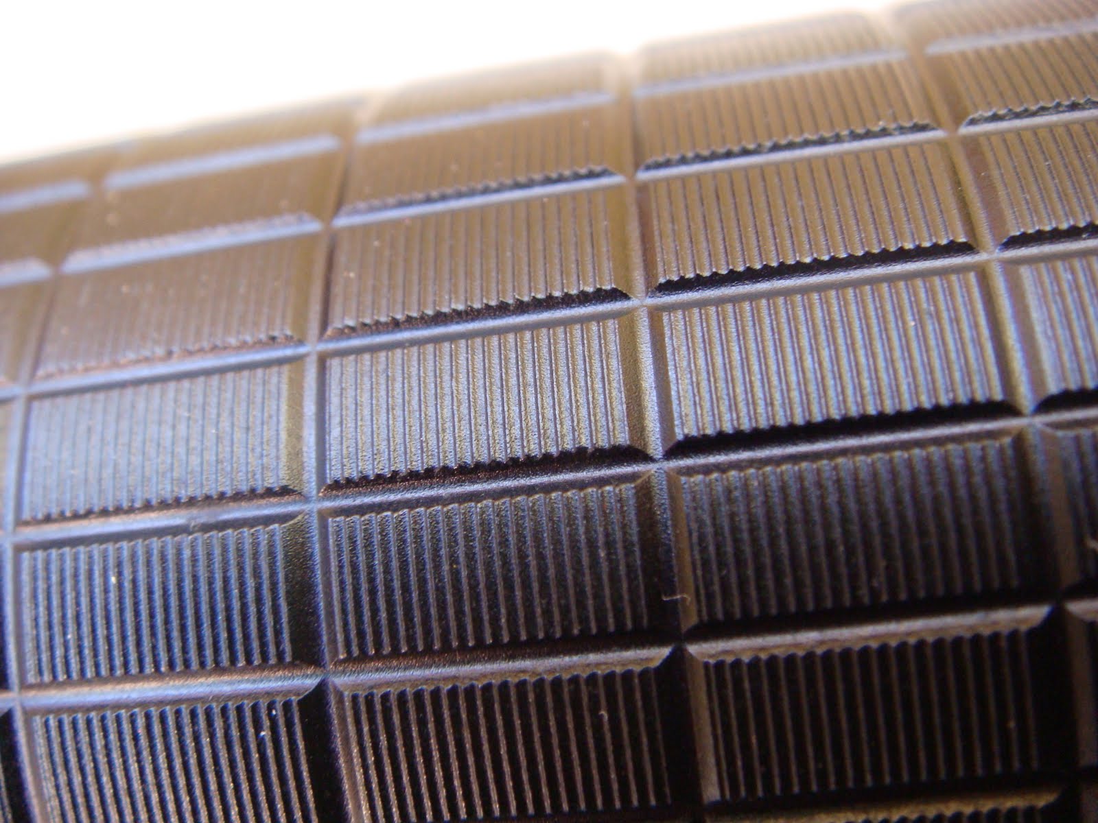

The battery-tube eschews traditional knurling for an array of rectangular cuts, with each individual rectangle being further ridged longitudinally.
This provides a very nice amount of grip and feels very nice in the hand.
Note the excellent machining. This is a great way to provide grip in my opinion. I did not notice any reduction in grip while my hands were wet or dirty.

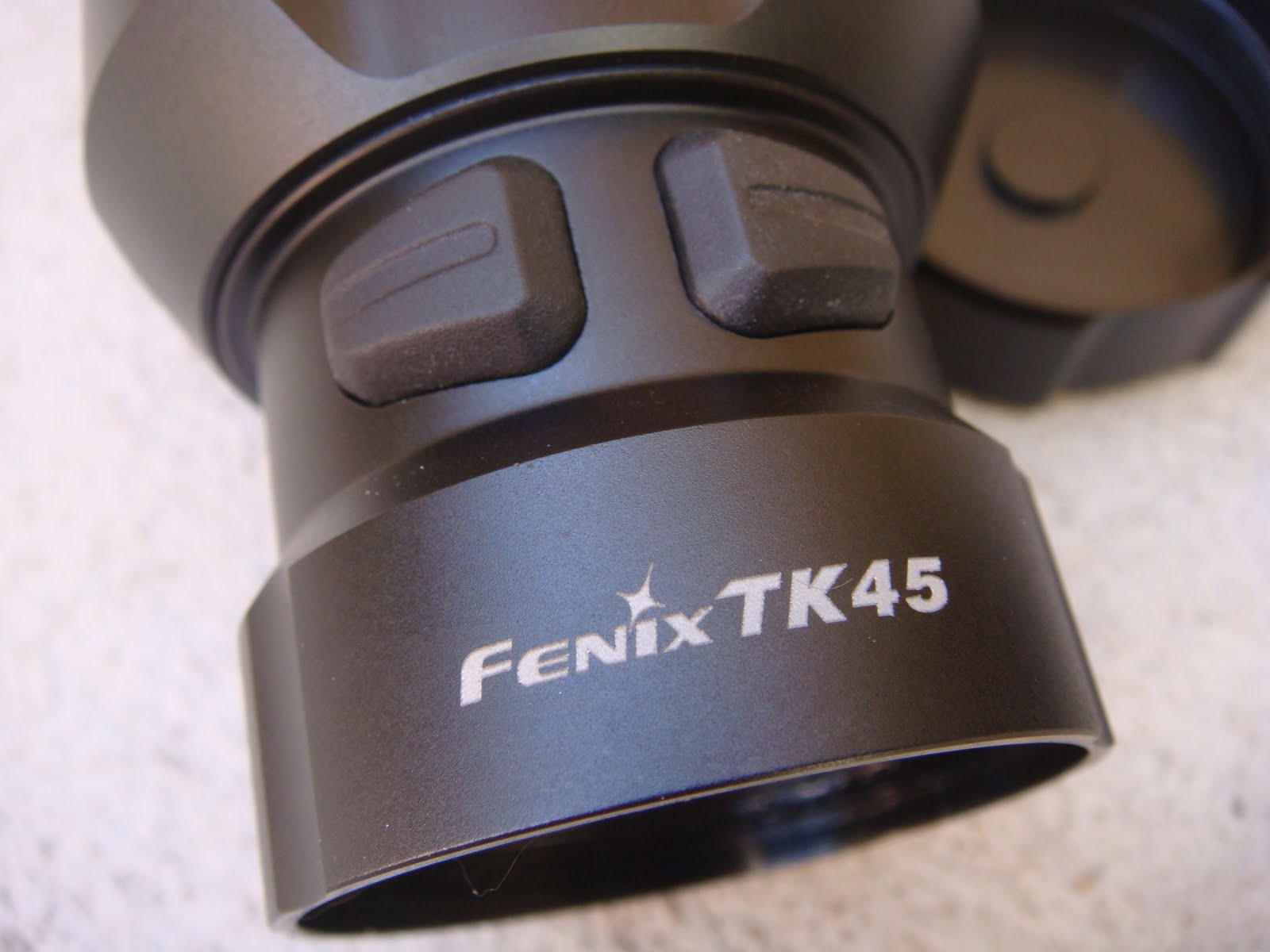

The two switches located below the head are rubber-covered and while almost silent, provide a nice tactile feel.
The switches. Left handles levels and the right is on/off/strobe mode. This setup is very easy to use in the dark as well. Assuming you can remember what left and right is...

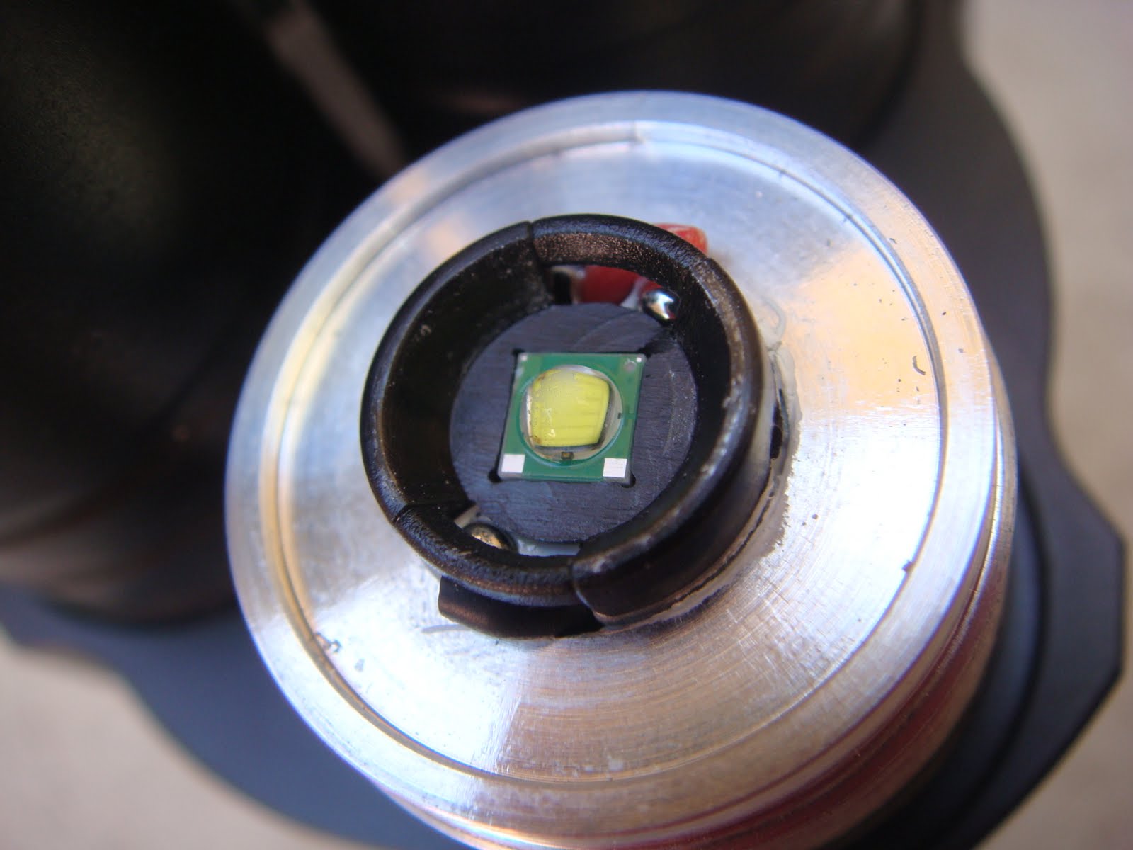

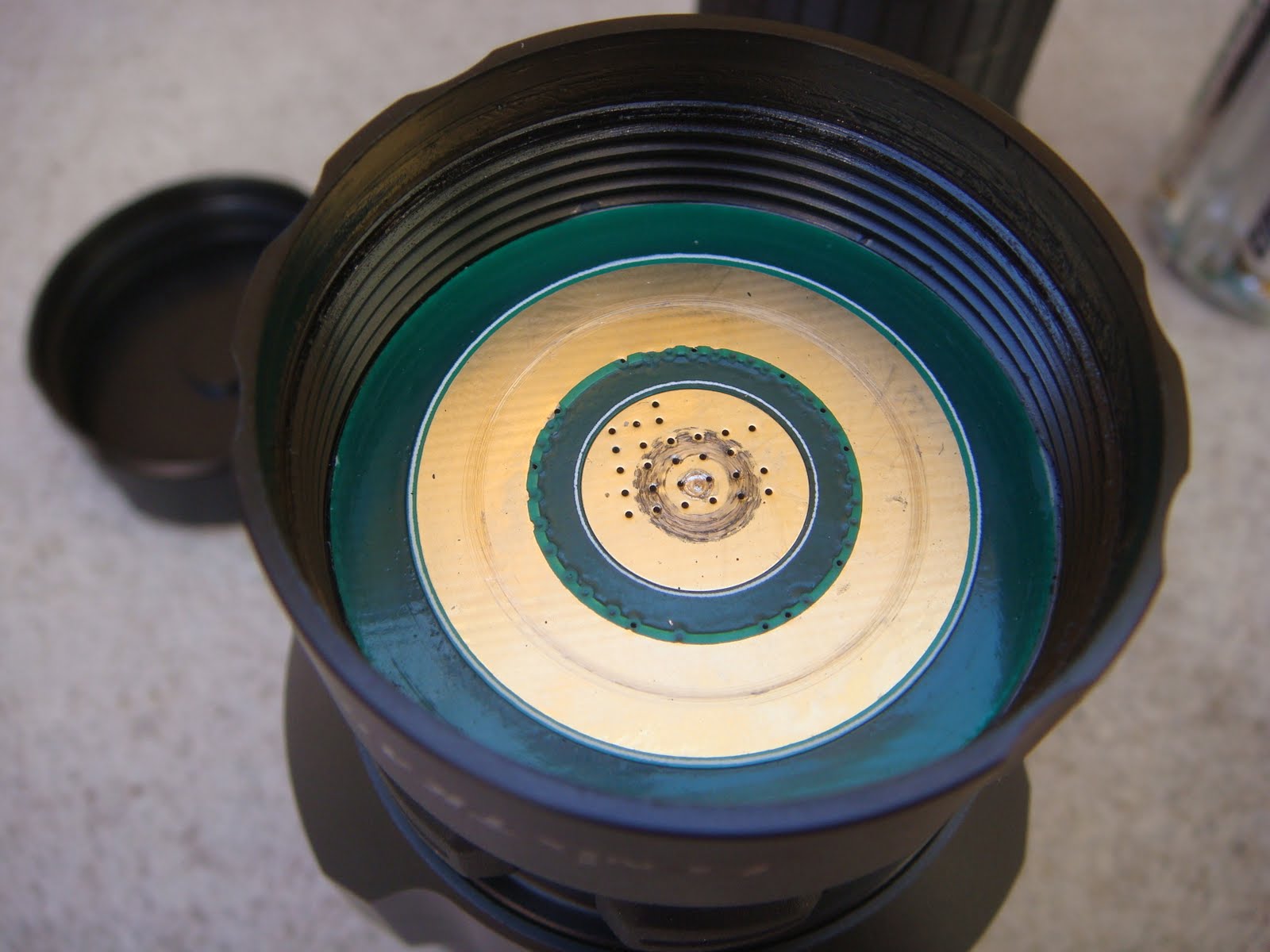

LED assembly. This particular light is a testing sample and was shipped with the XP-G R4, not the newer and brighter R5 that the production version will have. Expect the production version to be notably brighter!
LED pedestal or tower. The only non-anodized metal that I could find. These threads are also standard cut, not the square-cut you see elsewhere on the TK45.
Note the beefy O-ring!
LED pedestal with the bezel in place. Note the slight gap at the bottom. I'm not sure why that is there, but it offers little functional detriment, so... Erh. Meh.

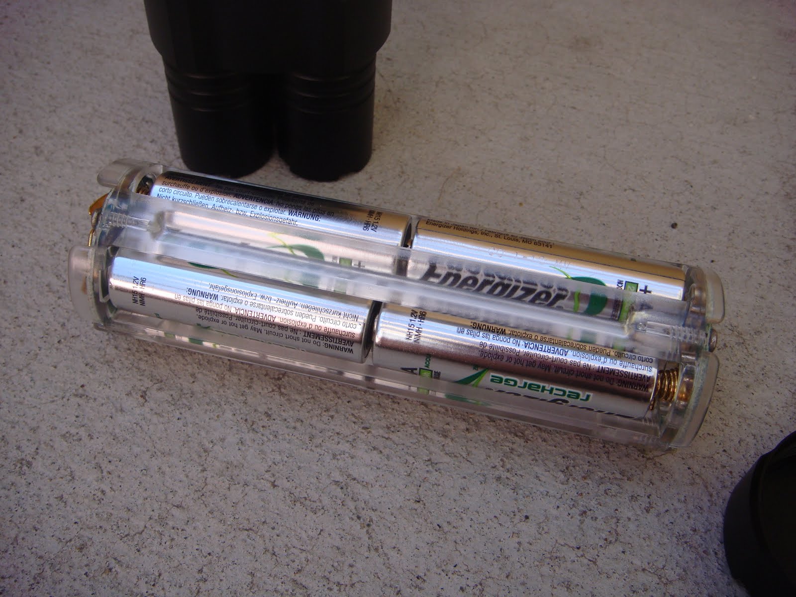

The battery-carrier that receives the 8 AA batteries, is made from clear plastic -likely a polycarbonate or acrylic compound- with the gold-plated contacts and circuitboards screwed into it at each end. It seems well-constructed, although there is some rattle when the whole thing is installed inside the light, but it's not annoying and appears to have no detrimental effect on functionality.
The battery-carrier. Takes 8 AA batteries, either Alkaline or NiMh. I used Energizer 2300mAh batteries for this test. Note gold-plated contacts.
Only real weakness seems to be that the batteries come out quite easily when the carrier isn't installed.

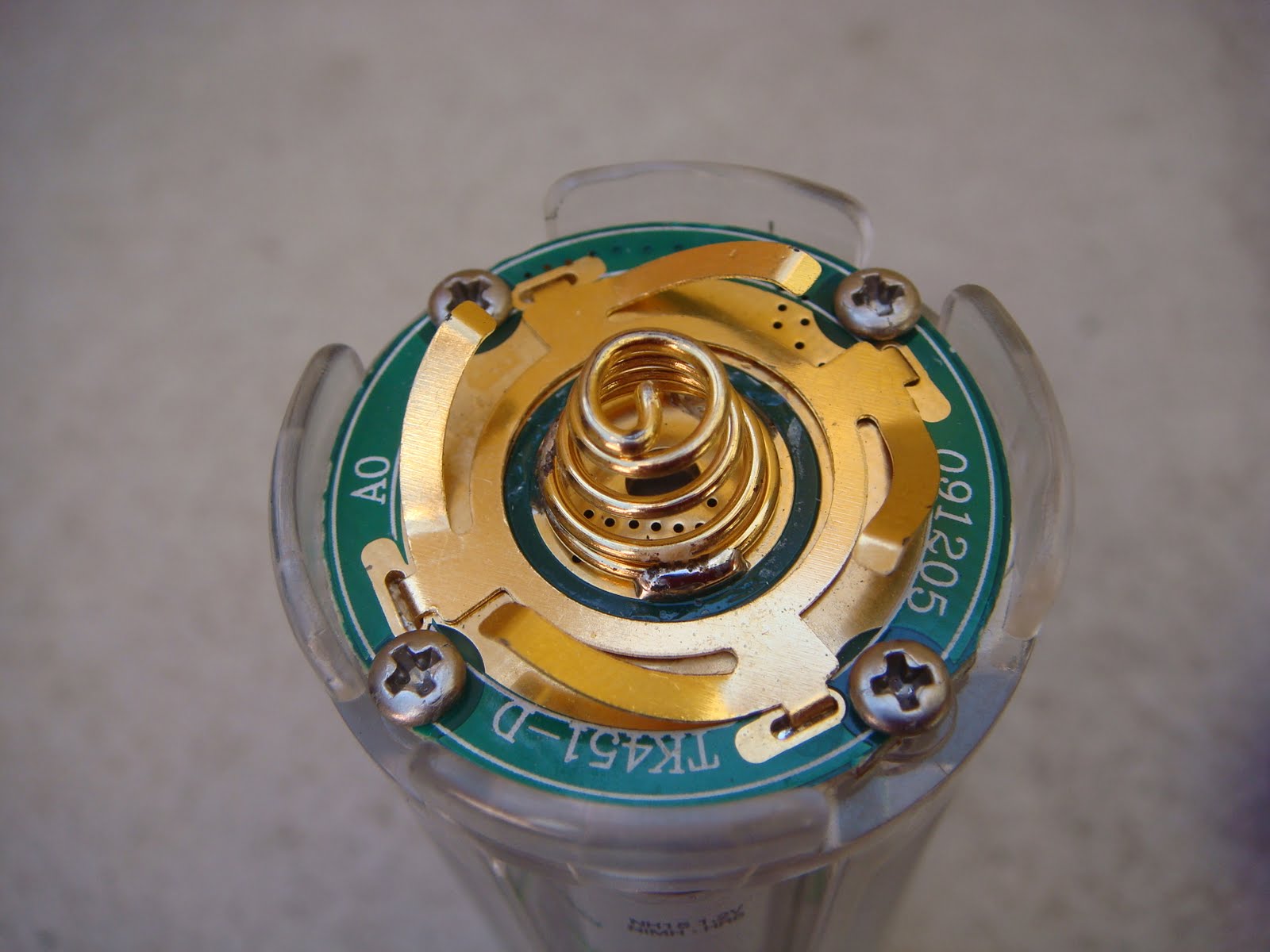

The contacts that go inside the head. There are no contacts at the other end.
Again, they're nicely gold-plated.
Seems like a very solid setup.

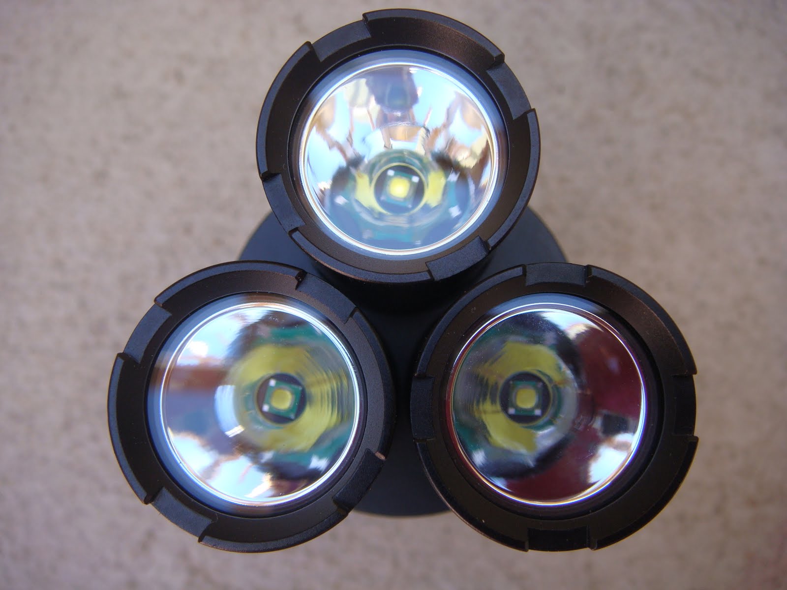

The tint of the light is a cool, pure white that -although not a neutral white- provides excellent color rendition.
The beam produced by the three reflectors is quite floody, with a large central hotspot, surrounded by a wide spillbeam.
The transition between hotspot and spillbeam is very smooth and gradual with very few artifacts in the beam in general.
I did notice that, while on the lowest output, there is a dark spot in the center of the hotspot.
This doesn't really bother me though, and is really only noticeable while shining the light on a white wall.
This is partially caused, I believe, by the lowest output only firing up a single LED at a time, which is likely how the TK45 achieves it's remarkable low setting of only 8 lumens. Most high-power lights don't get anywhere near that kind of setting, which for the TK45 is a great feature, especially for long-term use.
Interestingly, cycling the light on and off in the low mode, also cycles between the three LED-heads, each one lighting in turn.
The heft and balance feels very nice as well, the substantial circumference of the light providing plenty of surface to grip.
At the business end of the light, each LED-head has a crenelated bezel, that allows you to see if you left the light on, when you set it on its head(s).
These are not particularly aggressive, so I wouldn't refer to them as an "impact bezel" or anything similar.

The beefy threads and equally beefy O-ring. The threads arrived mostly dry from the factory but are still quite smooth. A quick application of grease eased my mind and the threads as well.
A quite solid setup.
The lenses themselves are glass and appear to be of high-quality.
