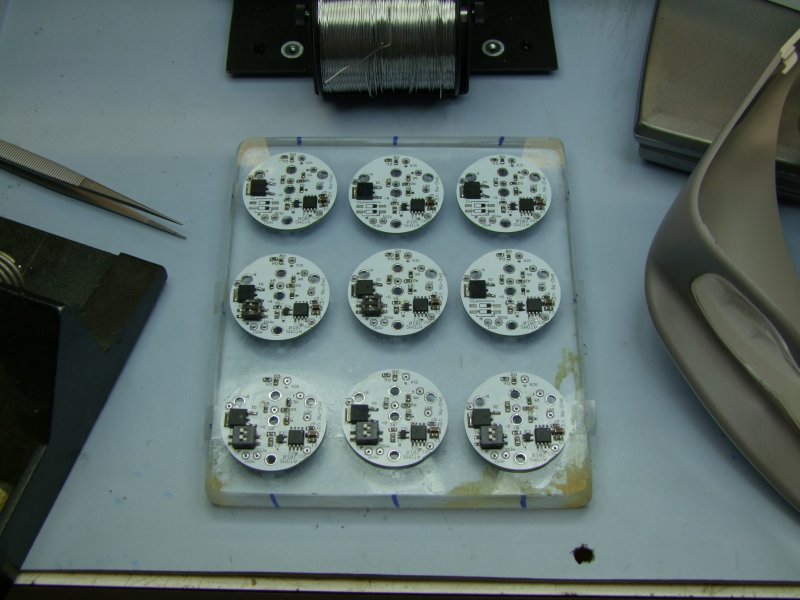

    What is the PhD-M6:
    It is a regulated custom battery pack with soft-start for the SureFire M6 flashlight, which also incorporates low battery detection monitoring to let the user know that the cells are almost depleted. The development thread and feeler threads have a lot more information, photos, videos, so I am not going to duplicate those here. Latest guide can be found here:

    Since these are all hand assembled/tested, it is a very time consuming process. I will be making available the packs in batches of about 9, as per my soldering fixture here shows.
    Eric and I have already been ordering parts and building production pieces based on these feeler quantities (and some extra amount), so we already started "production". Please be patient with me as there is a lot of hand labor and I rather have folks waiting than rush through orders - I will take my time with each one to make sure it is ready and tested before shipping out

    Thank you guys for confirming your orders. As I get packs ready to ship I will then ask for payment. As I do in my other threads, I will post a few pictures of the packs as I finish them.
    Unless I hear otherwise, I am going to assume the default values/behavior for those orders:
    Level 1 = 5.0 volts
    Level 2 = 6.8 volts
    Level 3 = 7.5 volts
    Level 4 = 10.8 volts
    Default behavior for almost depleted cells = Moon Mode
    Moon Mode means = PWM duty cycle goes down by 1/2, so output RMS voltage goes down approximately 30%.
