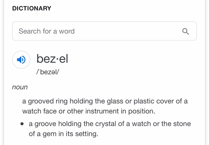

    Me too Pete. Whether it be in a SureFire thread, Maglite or any other thread. Anything forward of the battery tube (I call barrel) to me is "the head". I used to call the 'bezel' the 'lens holder' (from incan days) but now say 'bezel ring' after I acquired some lights with crenalated "lens holders", then some with crenalted "heads".
    Now a quick question: do you pronounce it "bee-zel" or "beh-zel"? I pronounce it "beh-zel" but I see youtube reviewers call it "bee-zel".
