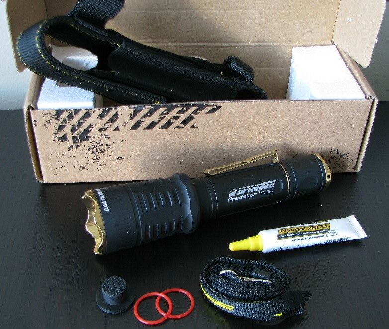

    Packaging is a stiff carboard box, with ArmyTek logos and graphic design all over it. Inside, the light comes packaged between two pieces of styrofoam, with a good quality holster with closing flap, wrist lanyard, spare o-rings, boot cap replacement cover, and a 5mL tube of Nyogel 760G (again with ArmyTek logo). The manual is available for download on their website.

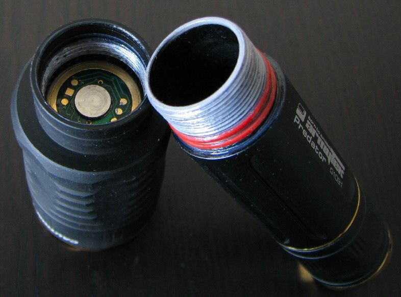

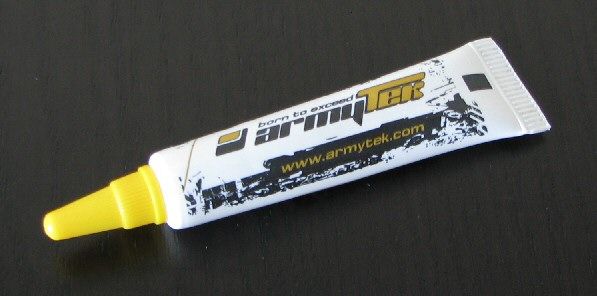

    Nice touch the inclusion of Nyogel 760G – it’s one of my preferred flashlight lubes.
    On a side note, the threads of my sample were swimming in Nyogel – I had to wipe most of it off. You don’t need to use much – a little goes a long way.

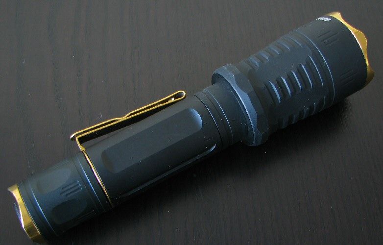

    Build quality is very high - the light has a substantial feel.
    In fact, the actual surface feel is fairly unique - the body has a very matte finish anodizing that feels almost moulded. According to ArmyTek, the Predator has a much thicker and harder level of anodizing than most lights (i.e. 35-50 microns, compared to typical 15-25 microns). Although the light lacks knurling as such, grip is better than you would expect, thanks to the unique finish. Still, I found it somewhat slippery at times, especially when programming.
    The bezel rings and clip are supposedly stainless steel with a titanium nitride coating for additional hardness (ArmyTek claims it is 10x harder than Type III anodizing). Apparently a more sandblasted titanium look is also available.
    Lettering is sharp and clear, in bright white against the dark grey matte finish.

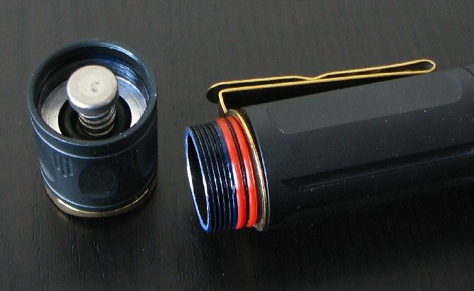

    Threads are anodized at the tailcap for lock-out.
    The light can’t tailstand, despite the scalloped tailcap ring.

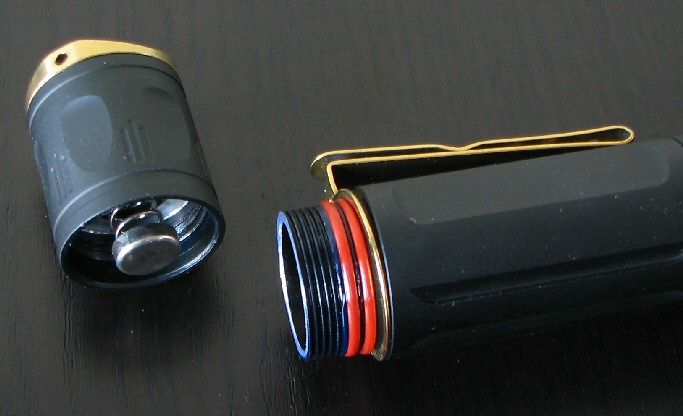

    There is a raised contact disc in the head, so flat-top 18650 batteries work fine on my sample.
    I like the flat disc at the end of the tailcap spring - no risk of scratching your batteries.
    Clip is removable (have to remove the o-rings first to get it off/on). Note the clip tends to swivel around the light unless the tailcap is screwed tightly on. There is a small notch in one area of the body which the ring slides into, preventing it from moving once the tailcap is screwed down all the way.

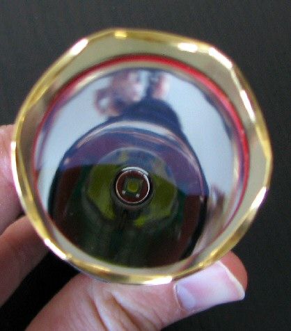

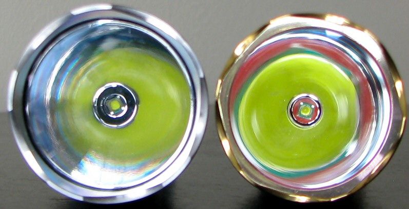

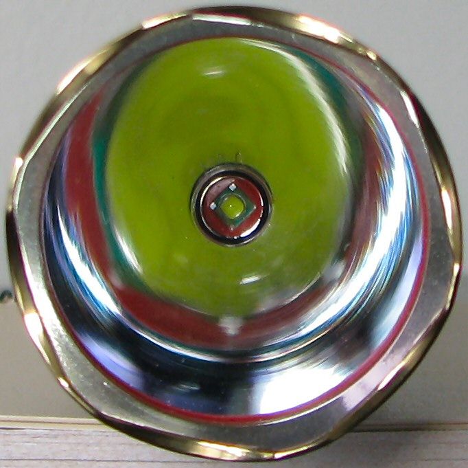

    The Predator features the latest emitter (XP-G R5), in a deep smooth reflector. Although the reflector's max diameter a little narrower than the Maelstrom G5 or Lumintop TD-15, it is definitely deeper. I would expect excellent throw.
    Lumintop TD15 on the left, Predator on the right.
    BTW, the red reflections you are seeing above are due to the red centering ring visible around the emitter (at the reflector opening). It also somewhat visible around the periphery of the beam, up close by the bezel. Below is a shot from my famed “integrating carpet”, to show you what I mean. It is not otherwise noticeable in real use.

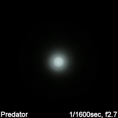

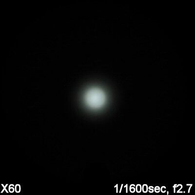

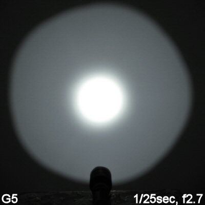

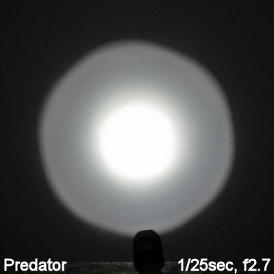

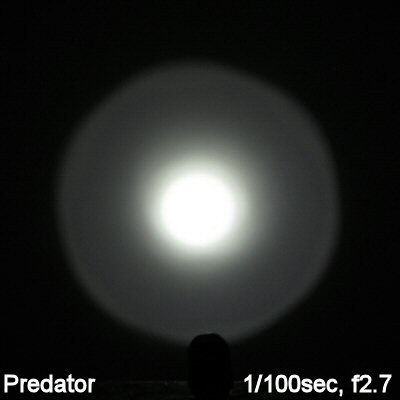

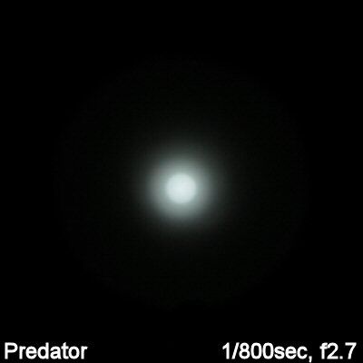

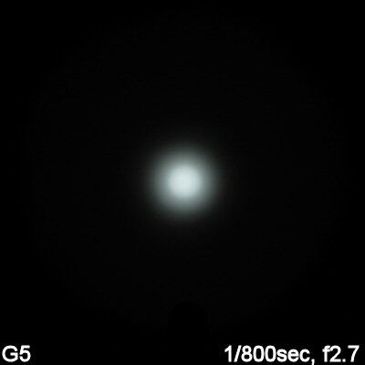

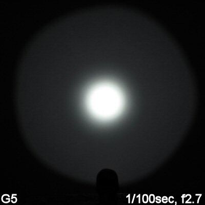

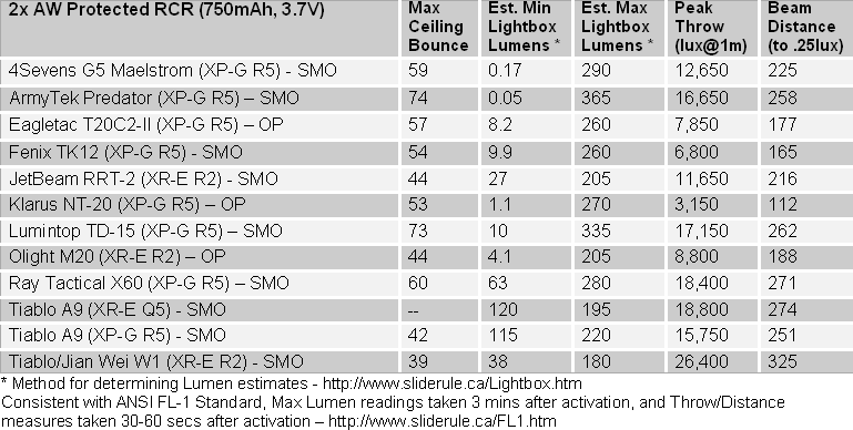

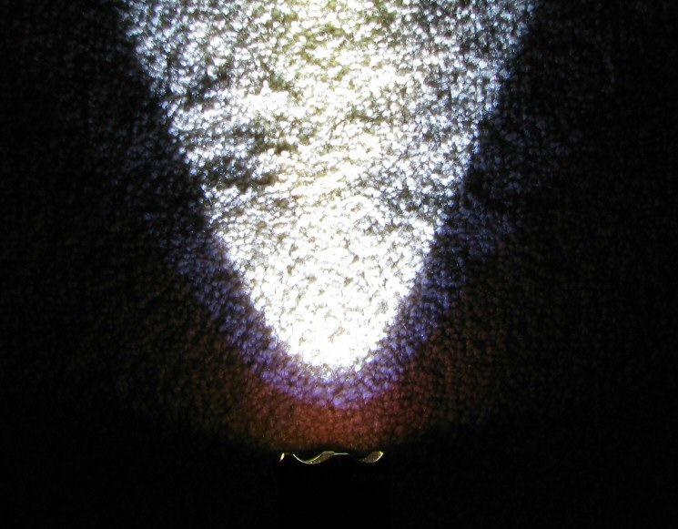

    Which brings us to the requisite white wall hunting . All lights are on Hi on AW protected 18650, about ~0.75 meter from a white wall (with the camera ~1.25 meters back from the wall). Automatic white balance on the camera, to minimize tint differences.
    As you can see, the Predator throws very well. The main difference in the reflector design is that the Predator has a tighter and more defined hospot than other lights of the XP-G “thrower-class”. However, it also has a greater corona immediately around it. My sample has only the mildest evidence of the center-void darkspot common to XP-G lights with smooth reflectors (your experience may vary, however).

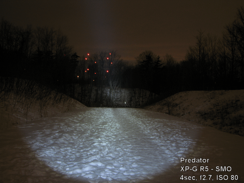

    I've recently updated my 100-Yard Outdoor Beamshot Round-up, including the latest XP-G lights. Check out that round-up thread for more details on the testing method, plus higher quality JPEG images of all lights. For now, here is an animated GIF of relevant XP-G comparisons:
    Since I was little off in my aiming of the lights, I decided to retest this recently on my replacement Predator:
    Note however that the full snow cover causes a lot reflection and diffusion (both ambient light and the flashlight beam, leading to a less clearly defined hotspot).

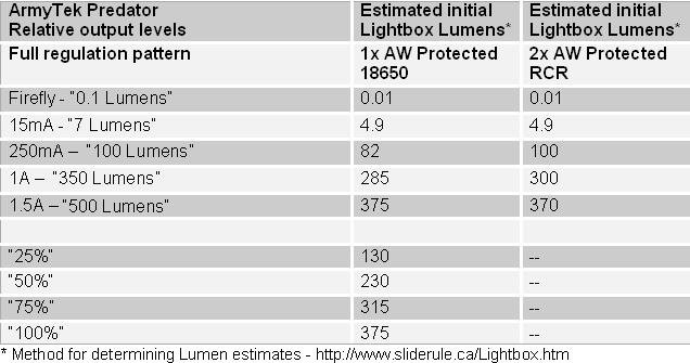

    Note that I put the lumen values in quotes above, as they refer to emitter lumens, not actual OTF lumens (see my Summary Tables later on for more on that).

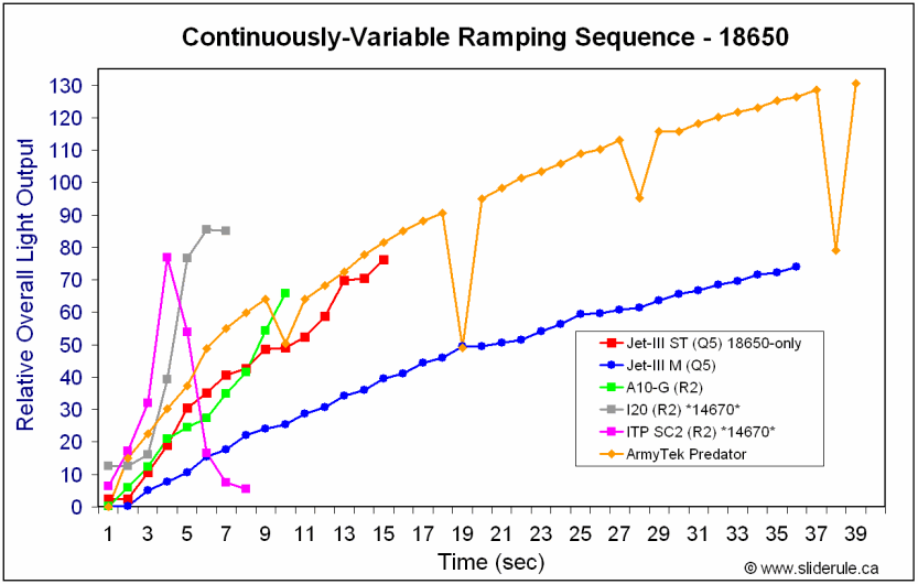

    To select a variable output level in the first line, start from head tight and loosen the head for at least 1 sec (i.e. wait for the light to switch lines), then immediate tighten, wait again for 1 sec (i.e. for the line to switch back), and then immediately turn off-on at the clicky. All the above has to be done in under 3 secs total, so timing is very tight (i.e. don’t delay on the head twist any longer than necessary to switch lines). It is highly unlikely that you would ever enter the programming state by accident!
    The light will then begin ramping from Firefly to Max, which takes about 40 secs in total (with flashes at 25%, 50%, 75% and 100% output). Once Max output is reached, the light restarts at Firefly and cycles through again. Make your selection by a loosen-tighten head switch.
    As you can see the output is not visually-linear across the ramp. The quarter percentage flashes thus seem to reflects actual drive currents. As such, you will have to be quick to select any of the truly low outputs.
    At the end of the ramp, the cycle repeats from low to hi again.

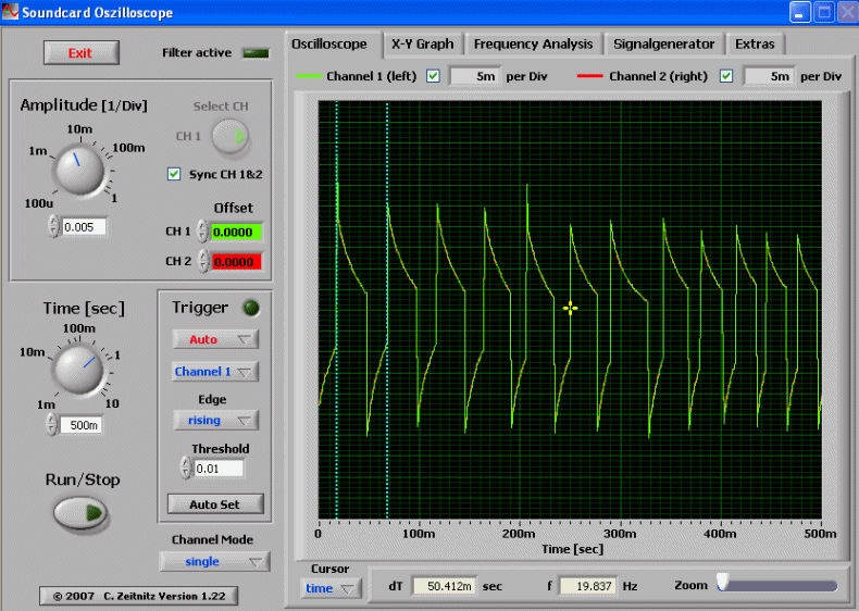

    Strobe speed in user-controllable, from 1-50 Hz (according to the manual). However, that’s not entirely true. First off, here is the default “Military” Strobe (which is reported to be 15 Hz, but was 12.5 Hz in my testing)
    According to the manual, the strobe freq will change from 1Hz to 50Hz over 30 secs in the programming mode. In my testing, I found it took about 35 secs to run through the range. However, the ramping speed is far from linear – although it starts at 1 Hz and slowly increases, all the frequencies between 15-50 Hz are presented in the last 1-2 secs of the cycle (and the cycle restarts at 1 immediately after 50Hz is reached).
    Despite repeated attempts, the maximum strobe speed I could detect was ~30 Hz, as shown below:
    As you can see, the strobe went from 19Hz to 32Hz in about 400msecs (i.e. those are the same traces above, I am just highlight different frequencies over a 500msec period). I wasn’t able to capture any speeds faster than that. Of course, I don’t really see why you would want anything this high – by 50 Hz, you are getting into nearly PWM constant light frequencies.

    To get a better idea of how some of the pre-set modes compare to actual lumens, here is a comparison table:

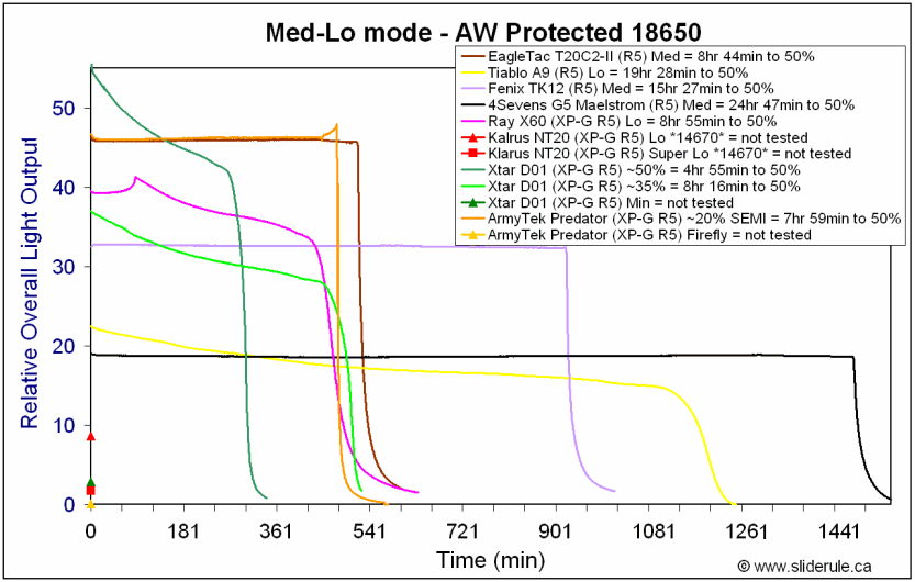

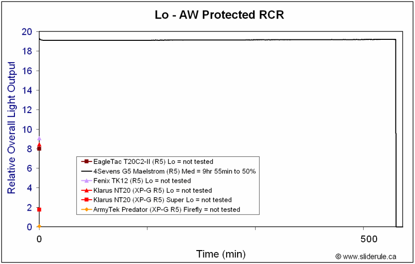

    Output/Runtime Comparison:

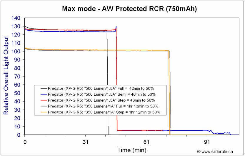

    One of the most unique features of this light is the option to choose between 3 different regulation (“stabilization”) patterns. Here are some comparative runtimes on different battery sources, starting with 1x18650:
    As you can see, FULL regulation gives you exactly that – perfectly flat regulation, followed by a sharp drop. Note that in some cases the light came back on in a low output level after the protection feature had been tripped. This effect was variable, and I suspect has to do with the cell recovering sufficiently to activate the light at a low level.
    SEMI and STEP regulation seem to give very similar overall runtime results – the difference is just in the pattern of drop off once the light falls out of regulation. Both typically last longer than FULL regulation.
    Note that the differences between regulation patterns at lower output levels are not as noticeable. It is really only on Max or near-maximal output levels where you can really see the difference.
    Also, at least on 1x18650, there is no difference in output levels between the regulation methods.
    In any case, I recommend you run the light in SEMI or STEP regulation, as they are the most efficient and won’t potentially leave you in the dark with little warning.
    Here’s how 2xRCR compare:
    As before, runtime on FULL was less than SEMI or STEP. Although there was a brief step-down near the ends of the STEP run, this is only on the order of a few seconds, not many minutes. The key difference being STEP and SEMI drop down to a low level rather than abruptly shutting off as FULL does on 2xRCR. I again recommend SEMI or STEP.
    On my original sample, there was a slight increase in output at "350 lumens/1A" on FULL regulation on 2xRCR. I have re-tested the replacement sample, and it shows the expected consistent output level across all three stabilization settings. I have updated the graph above to show this revised testing result. As you can see, there is not much difference in the regulation pattern on 2xRCR at this output level.

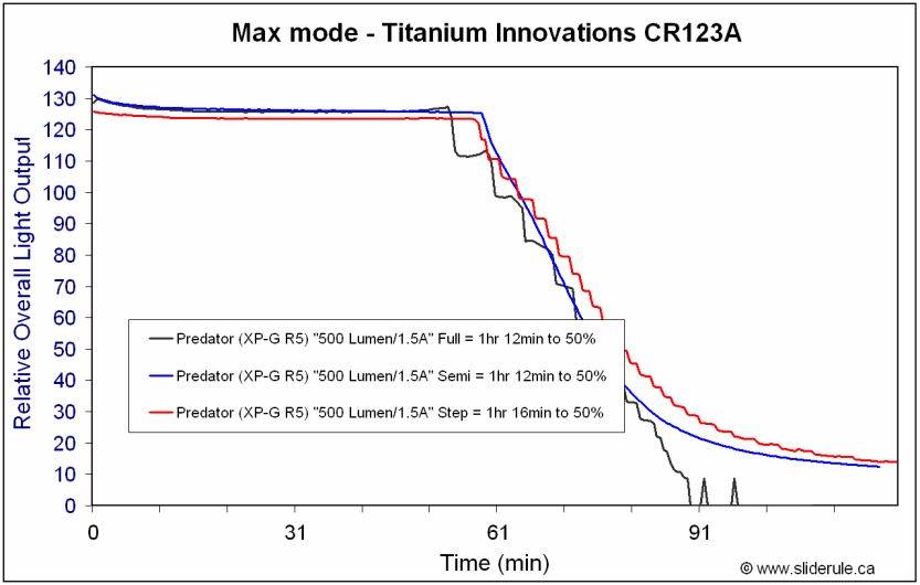

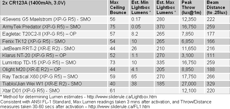

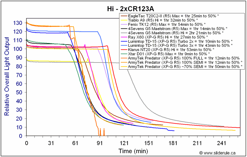

    And now 2xCR123A:
    Note that there is an interesting step-down pattern on FULL on 2xCR123A. But once again, I recommend you run the light on SEMI or STEP for maximum runtime without abrupt shut-down (i.e. especially as the light drops to lower outputs).
    To compare to other lights, I’ve used SEMI regulation pattern for the comparison graphs below (except on Max, where I show both FULL and SEMI).
    Note that all the runtimes were performed on my first Predator sample. A second sample was received (due to the software glitch lock-out of my first sample - see User Interface discussion above), which showed slightly lower Max output, similar to the TD-15.

    Unscrew the rear bezel, the retaining ring is below it.

    And good catch about the tailsanding when on. My sample is still far too wobbly for this, but I could see how it is close to being stable. It certainly can't tailstand when off.
    Written by gunga on 01-25-2011 03:14 PM GMT
    One trick, if you are not planning on tailstanding often, you could just unscrew the rear bezel 1 turn and it should tailstand reliably. Just screw it back when done, or add an o-ring spacer.

    Nice review on what seems to be a very solid light, are you using comparative data for the G5 from the XP-G R5 or S2 model?
    As labelled in the runtime graphs and summary table, I am using the R5 version. My sample is from the first shipping versions. As labelled in the runtime graphs and summary table, I am using the R5 version. My sample is from the first shipping versions.

    I received my Predator earlier this afternoon. Unfortunately there was no nyogel, o-rings or tail boot , but when I tried the light later I was impressed. It appears that the Predator's reflector is deeper than that of the G5 and TD-15. Am I correct about that? If so, perhaps that is how it can it can project such a clearly delineated circle.

    Quote Originally Posted by brightnorm
    Yes, that is my observation as well. The greater depth of the reflector (and its narrower overall dimension) seem to be what contributes to the more sharply defined hotspot. It doesn't seem to provide any greater centre-beam throw overall (i.e. when matched for output and compared to the TD-15 or G5). But the hotspot/corona pattern is distinctive on the Predator. Yes, that is my observation as well. The greater depth of the reflector (and its narrower overall dimension) seem to be what contributes to the more sharply defined hotspot. It doesn't seem to provide any greater centre-beam throw overall (i.e. when matched for output and compared to the TD-15 or G5). But the hotspot/corona pattern is distinctive on the Predator.

    seems like that metal clip is prone to bending and then being unable to bend it back.
    Written by selfbuilt on 02-08-2011 07:31 AM GMT
    Quote Originally Posted by billywilly02341
    Hmm, I see what you mean - if you bend the clip away from the body, it will stay that way. You should be able to bend it back tighter, but it would mean removing the clip from the body first. And of course, I wouldn't recommend you do that too often (i.e. metal fatigue will set in fast). Hmm, I see what you mean - if you bend the clip away from the body, it will stay that way. You should be able to bend it back tighter, but it would mean removing the clip from the body first. And of course, I wouldn't recommend you do that too often (i.e. metal fatigue will set in fast).

    Ordered a Predator on 24-March. Got the first notification that my carrier was DHL later that day. Never got a tracking number but the light arrived today (29-March) and surprised me when I got home. Thumbs up ArmyTek & DHL for very fast service from HKG.
    The shipping container had a big sticker that the carrier (HKG Station) had "inspected" the light. It was in a DHL body bag with the box completely destroyed and the Nyogel (predictably) missing. Thumbs down DHL. It looked like these guys were employing that Russian guy on the ArmyTek video! Even so, the light was unharmed.
    Initially no hope of tailstanding. Then I noticed that the spare switch boot appeared to be somewhat smaller. I took off the retaining ring and removed the installed switch boot and found that it was in fact about 2mm longer and had an aluminum slug in the end that improved the feel of the switch. The smaller switch cover couldn't accommodate the slug and still operate. It works fine with out the slug but it's a bit squishy and hard to operate. I wouldn't want to use it this way with gloves on. Even so, I value tailstanding so the shorter boot stays.
    I wanted to program it with two lines of (500/100) and (firefly/strobe), turn off mode memory, set stabilization to step and configure it for an 18650 LiIon. All of this was pretty easy but I discovered that if I turned off mode memory first, I could only program the first position in each line. With mode memory on it got a little confusing since I was essentially reversing the second line. I ultimately prevailed. Unfortunately firefly mode has a nasty and consistent preflash. It's not super bright but enough so that I would be inclined to place the bezel against my leg when actuating in firefly mode.
    Default Re: ArmyTek Predator (XP-G R5, 1x18650 2xR/CR123A) Programmable: RUNTIMES, BEAMSHOTS
    I got one. It came via DHL and my nyogel was also missing It throws well.

    I wouldn't worry about it too much, for the reasons andrewnewman pointed out. I will also add that I have done a LOT more head switching on my samples than most would do in a lifetime. Every runtime required not only output selection, but battery and regulation settings as well (i.e. I would always reconfirm each one, on each run, to be sure). Will all the general testing as well, you can rest assured mine went through the ringer.
    In fact I had to re-lube both samples several times during testing, that's how much wear I was putting on it. Never had an issue. On a side note, sorry to hear the nyogel does not seem to be included any more.
