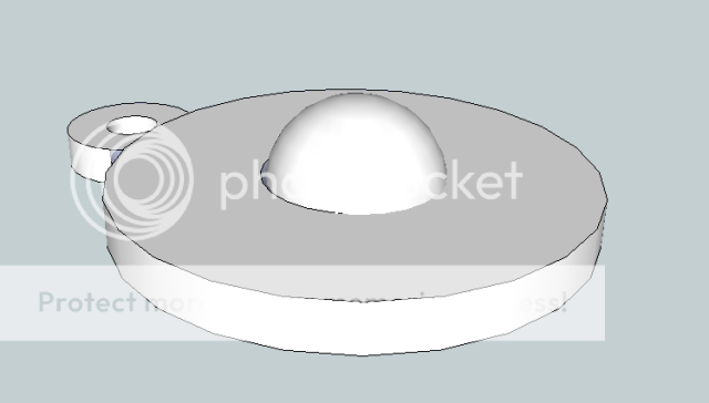

    Regarding the necklace/lanyard hole.
    Something like this looks like it could do the trick,
    and in actual size will indistinguishable from the current design, once properly centered.
    Will need to test to see if its enough of an angle,
    though it should be fine in most cases, depending on what kind of necklace/cord you plan to use.
    The weight distribution (of the internals) is very symmetrical so gravity should also help the Core Ti it find its center on a cord/ring.
    Note, the Core Ti with the black background in the hole is the original version,
    and the one with the white background is the the angled version.
    I would move the position of the hole down (by 1mm~) to make up for space lost by the extra angle.
    tgwnn

    applevision (_) !!!
    I feel like the guy in the haunted house who opens the squeaky doors and says
    ".... we've been expecting you"
    I had read your thread on the quest for the perfect neck-lace-light (more than once).
    Thrilled to hear the Core Ti is a possible contender to replace that now famous Ti-Fli of yours.
    As for your design above,
    I do like it!
    I have a friend/partner who has wanted to create something similar in concept (flat/round) to yours for a long, long time and I know he is keen to make it happen, but I know he will need to choose from a long list of innovative ideas that he has as well.
    I personally had pondered something similar many times.
    Sometimes hanging a Zebralight H30 on my neck (in a storage room), the swinging drives me a little crazy when I'm reaching down to search for things so I end up using the clip when I can, but a flatter profile should be more stable.
    tgwnn

    +1. I will say though, jd_oc, that I agree with you in that a more potent light is generally/often welcomed; indeed, if we could have a light with Zebralight functionality in this form factor, I think most of us would be drooling even more than we already are--though I'm not sure that is possible for me [to drool anymore than I am already drooling]! That said, the magic of this type of light is that it is truly something you can have on you at all times: when sleeping, in the shower, when the power goes out and you happen to be in the bathroom without your phone, etc. Since it is such an "intimate" light (sorry! I know that kinda makes it sound like a marital aid--not intended!), it will also be used for things like checking on babies, late night bathroom runs, and to see where you glasses are so you don't knock over the glass of water next to your bed... Thus, as a simple, single level light, something really potent might not be so great in this role. Rather, I like the idea of a 3-10 lumen soft light, similar to the Ti-Fli which I carry and use with great regularity (I had it on for over 1 year without removing it and used it almost every day; only recently have I been trying out the Photon Rex since I was burning though a fair amount of hearing aid batts...) All that said, YMMV and I also hope to see what else comes down the line... perhaps with some element of control in a future light, we could have both low-lumen for the aforementioned purposes, and high-lumen for when we need some power that can be more like a full-sized EDC. Something like the Draco (one of Kaichu's favorites and mine, too!) does this insanely well: very small, rechargeable, multi-levels from nice and dim to blindingly bright! But this light, our little buddy MBI Core Ti, would be significantly smaller and more wearable, and thus would have further specifications...
