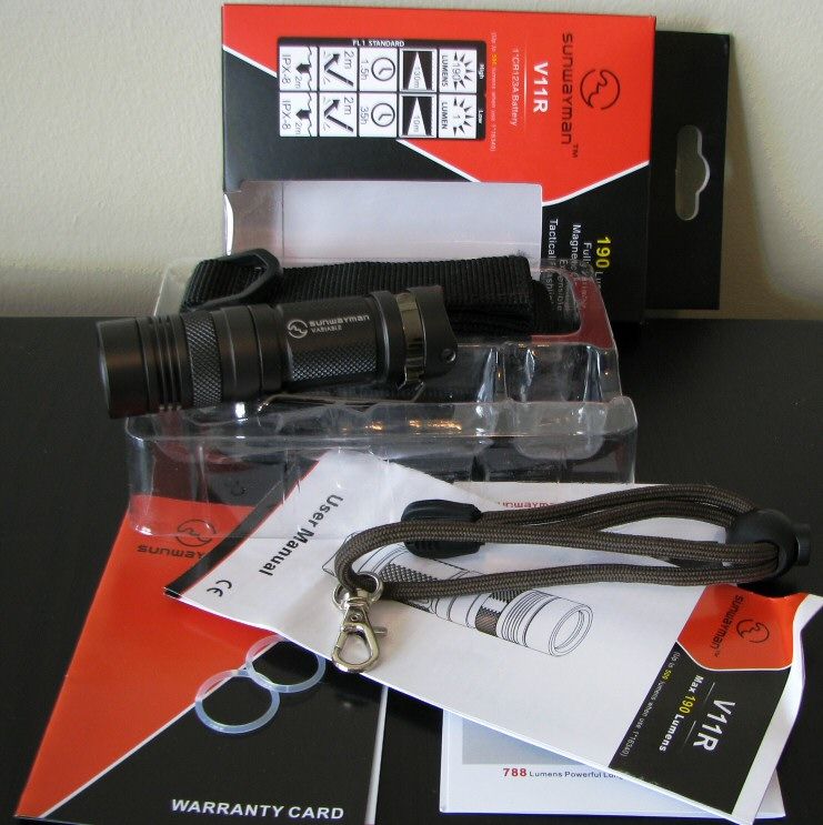

    Standard Sunwayman packaging includes a belt holster, clip-on style pocket clip, lanyard strap, extra o-rings, manual, warranty card and product insert.

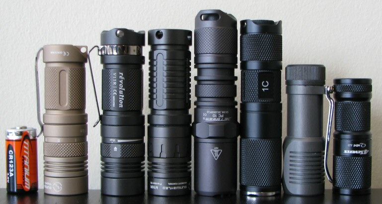

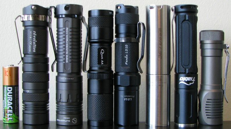

    From left to right: CR123A; Sunwayman M11R, V11R, M10R; JetBeam PC10; Thrunite Neutron 1C; Zebralight SC30; 4Sevens Mini 123.
    Sunwayman V11R: Weight 50.5g, Length: 84.3mm, Width (bezel): 23.1mm
    Sunwayman M11R: Weight 45.8g, Length: 76.4mm, Width (bezel): 23.1mm
    Rofis JR10: Weight 75.0g, Length (max): 110.6mm (angled): 92.9mm, Width (bezel): 24.8mm
    Jetbeam PC10: Weight: 50.5g, Length: 93.6mm, Width (bezel): 22.6mm
    Lumintop ED10: Weight: 21.5g, Length: 70.4mm, Width (bezel): 20.7mm
    Thrunite Neutron 1C: Weight: 45.2g, Length: 91.5mm, Width (bezel) 22.0mm

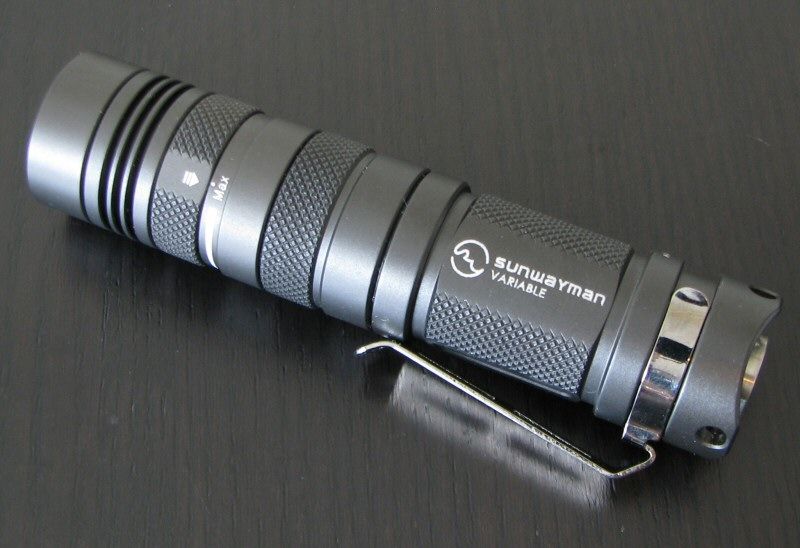

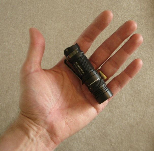

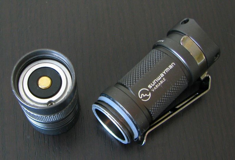

    The build has a number of updates to the earlier V10R/V10A.
    But first what hasn't changed – you still get the same rich, dark gray natural finish anodizing. Sunwayman has always had one of the best quality anodizations, with a very attractive finish (IMO). As always, all labels are fairly small and bright white against the dark background.

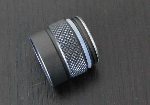

    One of the main physical differences is the addition of reasonable knurling to both the body tube and control ring, thus enhancing grip. This makes the control ring easier to access by feel, and improves the overall gripability of the light.
    The clip-on style clip is of improved quality, and holds more firmly against the light now. It is still not as robust as a screw-on clip (e.g., see the M11R I have just reviewed), but a definite upgrade from before.

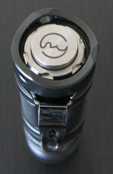

    The switch cover is something else that has changed – you now have a distinctive-looking metal boot cover. Personally, I have always preferred rubber boot covers – the main issue with metal ones is that you have to hit the cover right on the center, or you may not activate the underlying switch (i.e., less forgiving than rubber). The switch feel with this type of cover is also different – you may worry about not reliably activating the switch, due to the perception of less direct contact. However, I understand Sunwayman will soon begin shipping a rubber cover with the light, so you will have the option to change it yourself.
    The light can still tailstand, but with more scalloped edging around the base (which facilitates access to the switch).
    Screw threading size and diameter has not changed from the early Sunwayman lights, which means you can still mix-and-match heads and bodies across all models. Screw threads are anodized, for head lock-out.

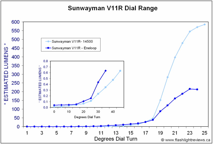

    Output level is controlled by the magnetic control ring in the head. As before, the V11R features a continuously-variable interface – you control the output level by twisting the ring. You can thus select your desired mode while the light is off (at least approximately).
    And that's it - no blinking modes, no standby modes. For a more detailed examination of the build and user interface, please see my video overview:

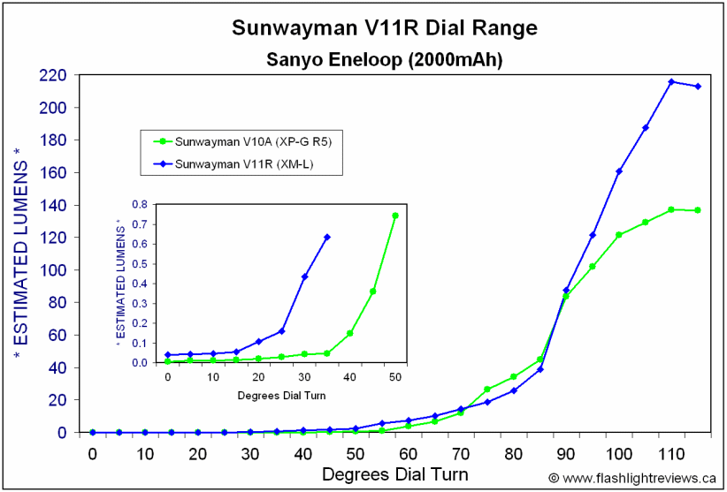

    Output Ramp

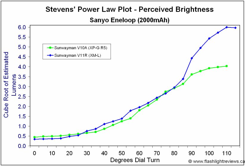

    One question users often ask is whether a given continuously-variable ramp is "visually linear". The short answer is the V11R – like its predecessor V10A/V10R - is generally "visually-linear" (in the sense commonly understood here).
    The reason that this is an issue is that we do not perceive brightness in a linear way, relative to actual lumen output (e.g., a 200 lumen does not actually look twice as bright as a 100 lumen light to us). So if the light varies the output through a control ring in a lumen-linear fashion, it will seem very distorted to our relative perceptions (i.e., it will seem to spend a lot of time at the higher end of the output range, with little perceptible difference).
    The common solution that flashlight makers have adopted for this problem is to adjust the variable interface to correspond to a logarithmic ramp of circuit power. This is what is known as "visually-linear" here, as there is a long-standing belief in many lighting/electronic/optic communities that we perceive light in a logarithmic way.
    To compare two otherwise similar lights – one with a circuit-linear and one with a logarithmic "visually-linear" ramp – see my reviews of the Jetbeam RRT-21 and the Sunwayman V20C, respectively.
    While most consider a logarithmic ramp a huge improvement over a standard circuit-linear ramp, it is still not perfect from a relative perception viewpoint. This has become increasingly obvious to me as flashlight makers have expanded the dynamic range of their offerings (i.e. both higher Highs and lower Lows) – the logarithmic relationship for our perceptions just doesn't seem to hold true at the extremes
    In reviewing the scientific literature, I have discovered that the logarithmic adjustment model actually dates back to 19th century testing methods. More recent psychometric research from the late 20th century to today has indicated that the range of relative human sensory perceptions appear to more closely follow specific, discrete power relationships. For perceived brightness of a non-point source of light (which would include a flashlight beam), current research findings typically find power values in the 0.30 to 0.35 range (i.e., very close to a cube root, or 0.33).
    For a full discussion of this issue - including detailed graphs and primary literature references - please see this post and the subsequent discussion.

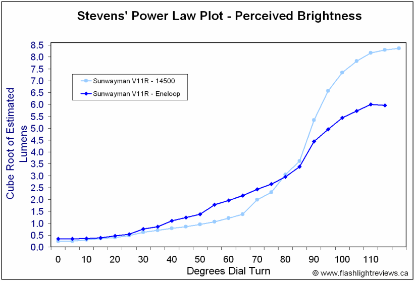

    To show this graphically, let's start with what the V11R's ramp would look like in terms of estimated lumen output. To measure this, I slowly turned the ring at as close to a constant rate as I could manage, over ~25 secs or so. My lightbox collected output readings every second, which I then converted to estimated lumens and plotted against the estimated degree shift of the ring (i.e. with 360 degrees being a complete turn). Note the ring only turns about 1/3 the circumference of the light, or about 120 degrees.
    I have blown-up the first quarter of the ramp in the inset graph, to show you that output does indeed increase over the whole ring (albeit seemingly slowly at first). As you can probably tell, the pattern does look rather logarithmic (i.e., if I were to plot these on a log scale, you get something approximating a straight line).
    But again, as more recent research has showed, we don't really perceive light in a perfectly logarithmic way. Plotting with a cube root transformation should give the best indication of what you are likely to see by eye.
    The point to the above is to show that the V11R uses a logarithmic ramp (like the earlier V10A), but rises to a higher max output. I haven't plotted the performance on 1xCR123A, but it should look intermediate to my AA and 14500 ramps above.

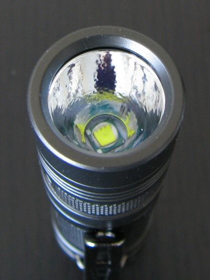

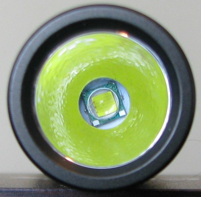

    The V11R has a fairly typical looking head for a light this size. The reflector is lightly textured (i.e., LOP). Emitter was not perfectly centered on my sample, but it was pretty good.

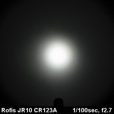

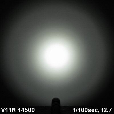

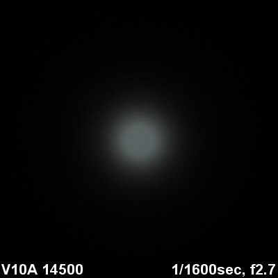

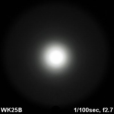

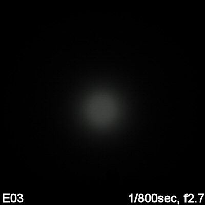

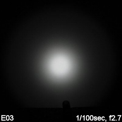

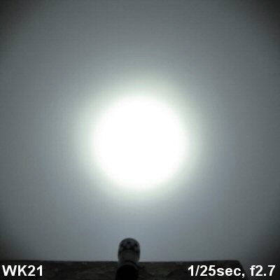

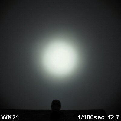

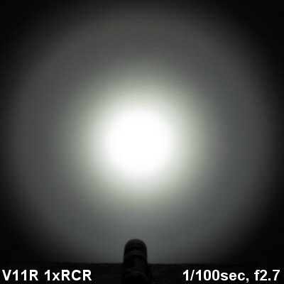

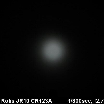

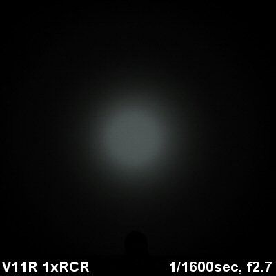

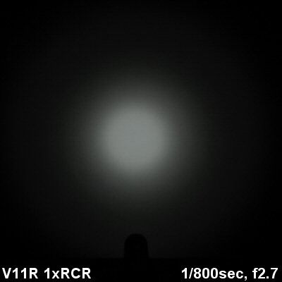

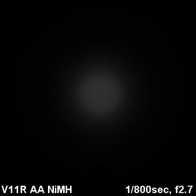

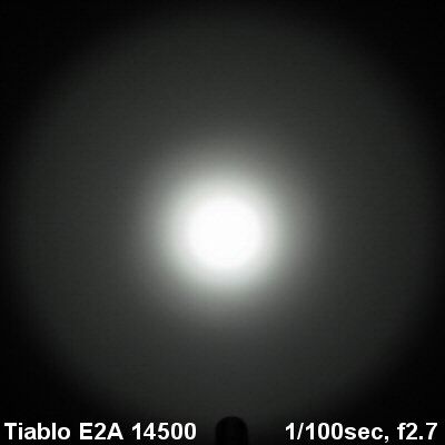

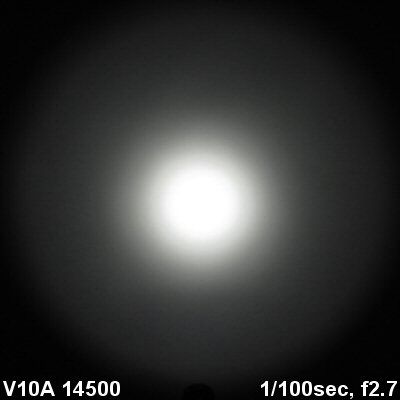

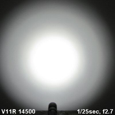

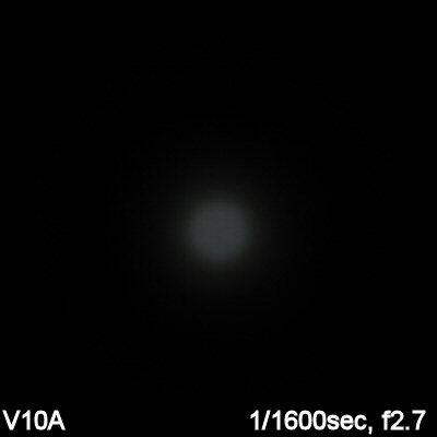

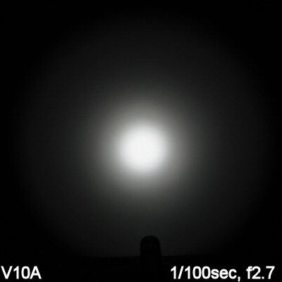

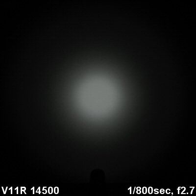

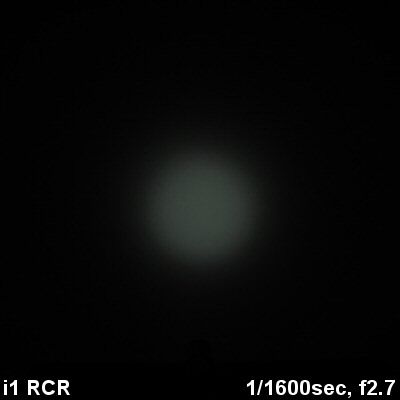

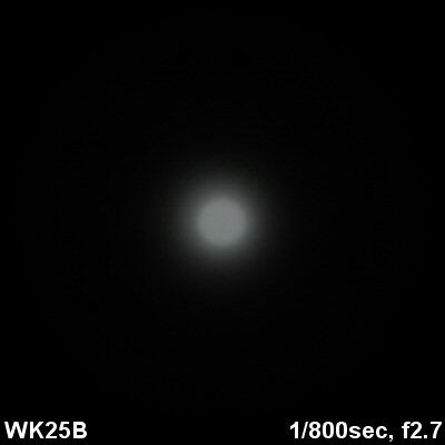

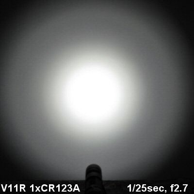

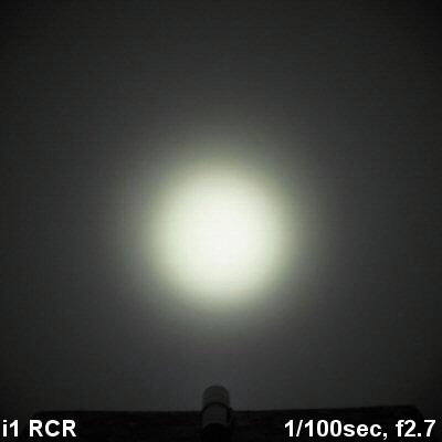

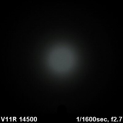

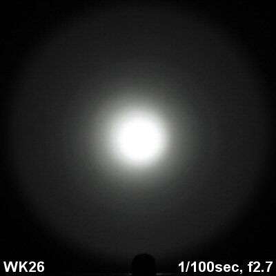

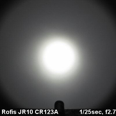

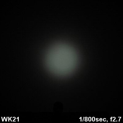

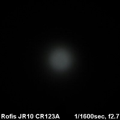

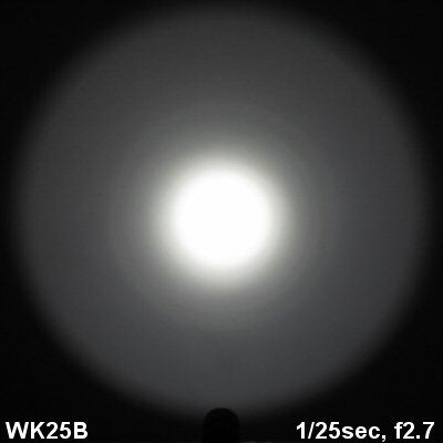

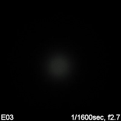

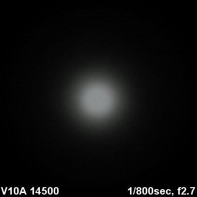

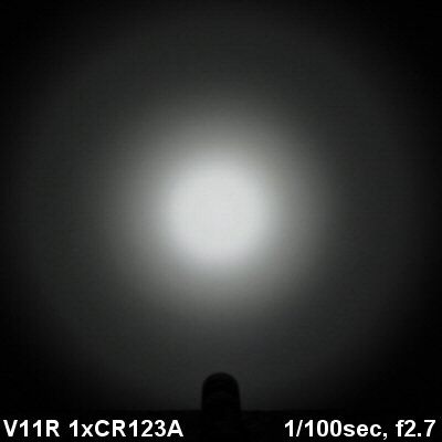

    And now, the white-wall beamshots. All lights are on Max output on the identified battery type. Lights are about ~0.75 meter from a white wall (with the camera ~1.25 meters back from the wall). Automatic white balance on the camera, to minimize tint differences.
    1xRCR (AW Protected 750mAh) Li-ion Comparison:
    1xCR123A Comparison:
    1x14500 (Aw Protected 14500) Li-ion Comparison:

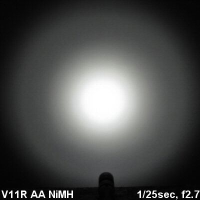

    1xAA (Sanyo Eneloop) NiMH Comparison:
    Ok, those are a lot of beamshots. But the take-home message is that the beam pattern is what you would expect for a light this size.

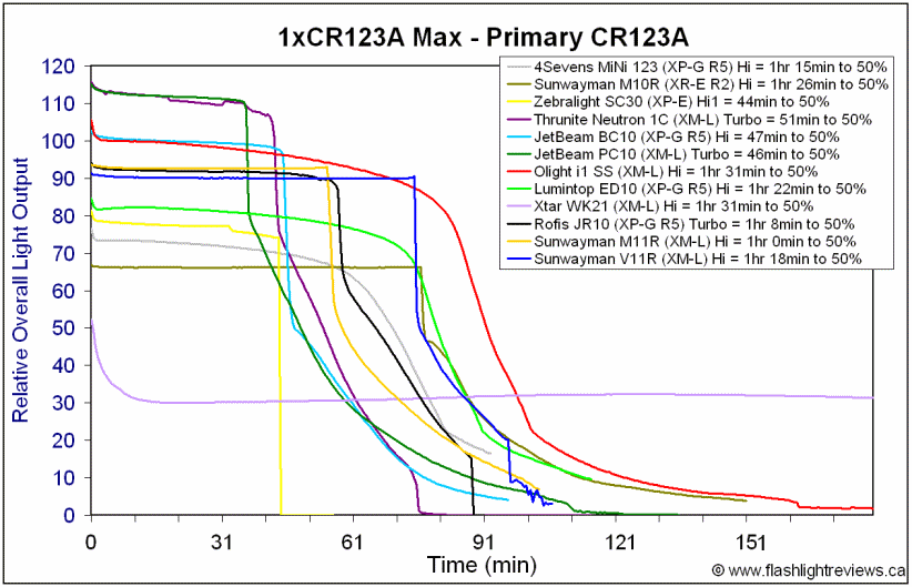

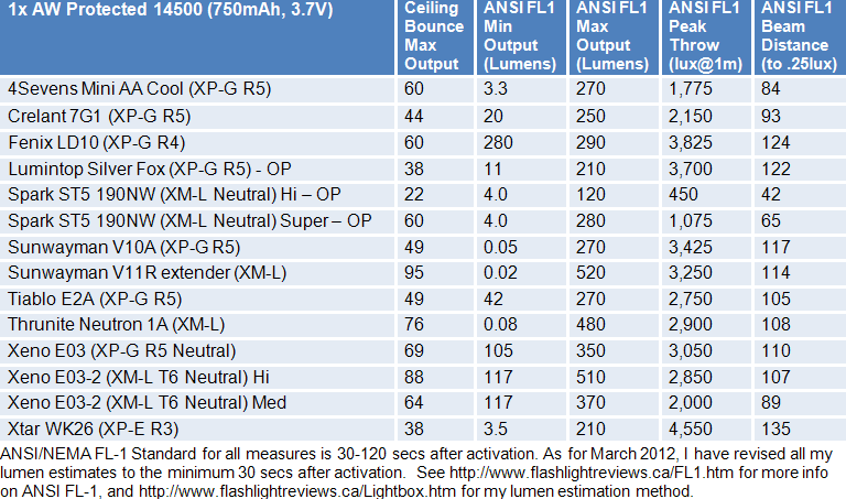

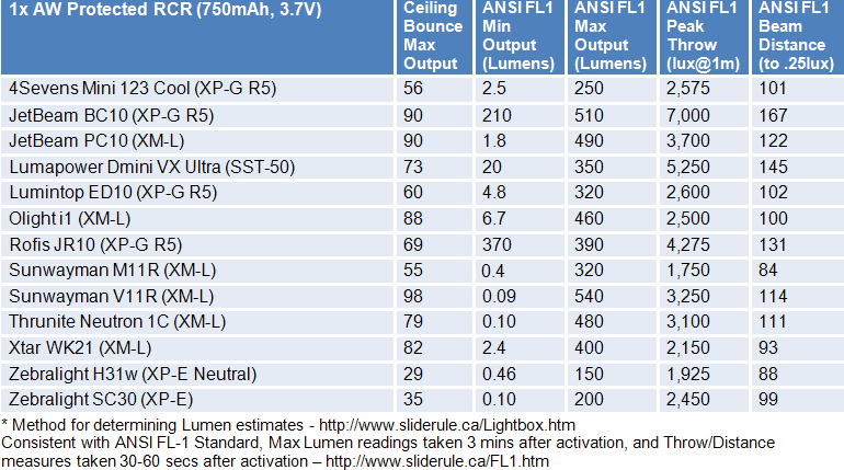

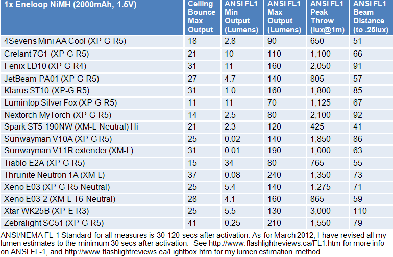

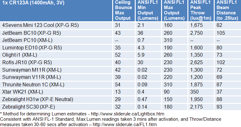

    My summary tables are reported in a manner consistent with the ANSI FL-1 standard for flashlight testing. Effective March 2012, I have updated the Max Output ANSI FL-1 lumen estimates to represent peak output measured at 30 secs (my earlier gray tables were based on a later time point for Max output). Please see http://www.flashlightreviews.ca/FL1.htm for a discussion, and a description of all the terms used in these tables.
    The reported 190 lumens Hi output spec on 1x CR123A seems pretty accurate in my testing. But the 1 lumen Lo output spec seems very conservative - mine went down to one of the lowest levels I've ever seen.
    On 1xRCR, the reported 500 lumens Hi output spec again seems pretty believable for the light. Although the Min output increased somewhat, it is still among the lowest I've seen for this battery type.
    The reported 130m Beam Distance spec seems rather optimistic. On 1xRCR, it does approach something close to that – but the ANSI FL-1 spec should relate to 1xCR123A performance.
    On standard AA batteries, V11R output has increased my older XP-G-based V10A, but throw has decreased (as you would expect for an XM-L emitter)
    On 14500, you get comparable characteristics to the 1xRCR, naturally.

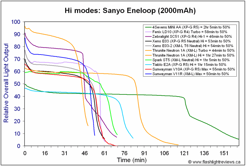

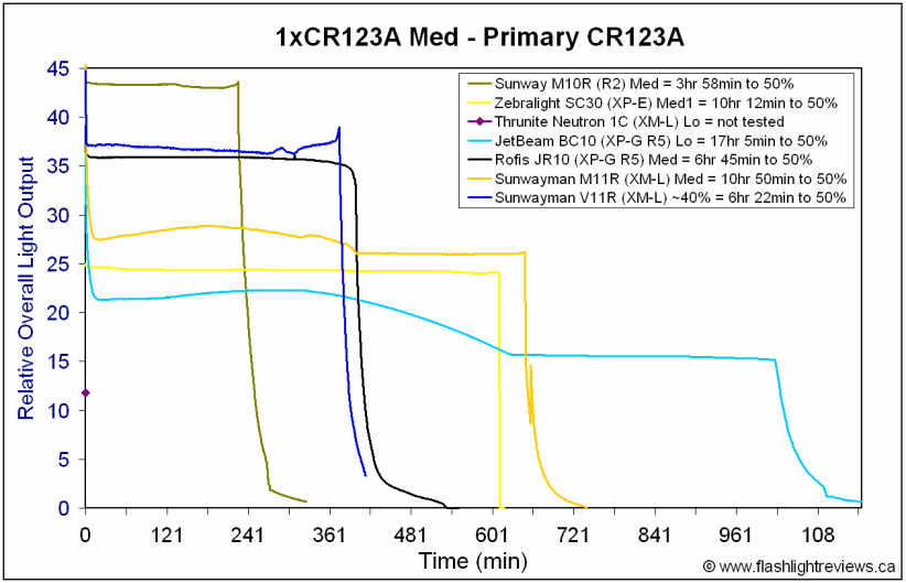

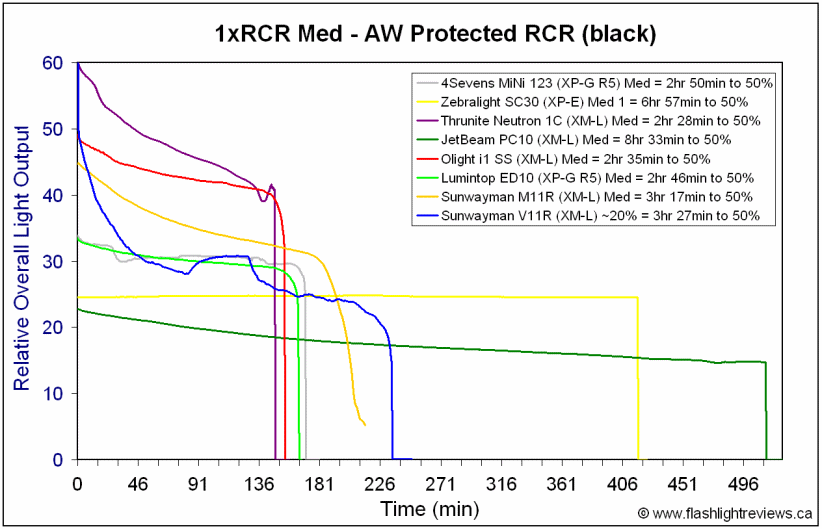

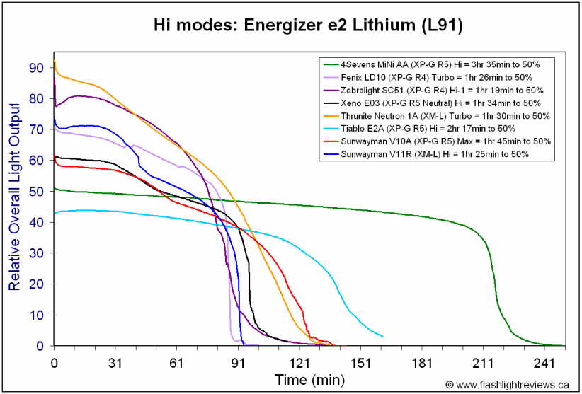

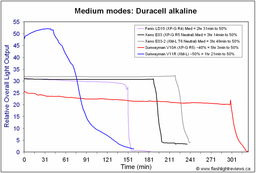

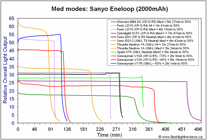

    Output/Runtime Comparison:
    1xRCR:
    1xCR123A:
    The V11R performs well for the output levels (i.e. overall efficiency is good).
    One oddity however – on all levels below Max levels, the light doesn't hold its initial output. Rather, it drops off over time, eventually stabilizing at a level <60% lower than the initial output.
    This may be a quirk of my one sample, but on 1xRCR it actually rises in output slightly over the first 1-2 mins, before starting off on its descending trajectory (you can't really see it the runtime above, due to the scale height).
    Although peculiar, this drop-off was still gradual enough that you will not notice it happening by eye.

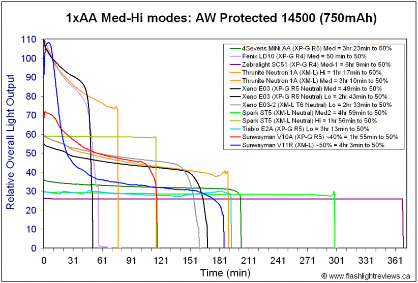

    1xAA:
    Overall efficiency is again very good, on all standard AA-class batteries, at all levels tested.
    1x14500:
    Again, overall efficiency is good on Li-ion.
    But the same pattern of shifting output over time (with a delayed stabilization) is observed here. Indeed, it was even more pronounced on all my 14500 cells – there was a clear increase in output over the first 3+ mins, sometimes rising by as much as 30%, before descending into a gradual drop-off. As before with 1xRCR, the light eventually leveled off somewhere <40% of its initial output level.
    Note I observed this on a number of 14500 and RCR cells (including different brands), and the effect seemed to be consistently greater on 14500. Interestingly, if you scroll back up the standard AA runtimes, you'll note something similar (but far less pronounced) seemed to be occurring there too.
    Not sure what it all means, but again it is not something you can notice very easily by eye (i.e. it is still gradual enough that you can't notice the change in output). And you can of course always turn the ring if you want more light later on – that's the advantage of continuously-variable.
    The included metal clicky switch cover can make it difficult to reliably access the switch, and the switch feel with these sorts of covers is never as good as with rubber boot covers. But I understand Sunwayman plans to start including a separate rubber boot cover with the light soon, so you will have the option of switching it over yourself.

    What I'm wondering is if the beam of the V11R is more floody, as I suspect it is, which would actually work even better in my line of work.
    Yes, in most senses of the word "floody": the V11R has a slightly wider spillbeam, a broader hotspot, and a brighter spill than the V10A. You add all that up, and the subjective impression is definitely "floodier". There is also a more noticeable beam ring around the spillbeam periphery on my V11R sample, though.
    Also, did Sunwayman mention when they would be including the rubber switch cover with these? I don't want one unless it comes with the rubber cover and Battery Junction doesn't mention the rubber cover yet, either.
    I don't have specific information, but I understood that all shipping lights now (soon?) would include both. And according to KiloVolt, his actually came with the rubber boot installed.

    Quote Originally Posted by dc38 View Post
    I noticed on your comparison chart of the RCR123 cells, the Sunwayman V11R actually outshined the Jetbeam PC10?
    Referring that JetBeam PC10 claims 550 ANSI FL-1 lumens and Sunwayman V11R claims 500 lumens.
    I had some PC10 questions Selfbuilt answered here and here.
    Hmmm, I wonder how the V11R would respond to an AW IMR 16340 . . .
    Oh well, I suppose we will just never know . . .
    Obviously, you'll want to recharge your battery every 30 seconds for max brightness.

    Output/Runtime using 1 x CR123A: Max 190 lumens (1.5 hrs), Min 1 Lumen (35 hrs)
    Using 1 x Li-Ion 16340, Turbo Mode: 500 lumens (25 min) - CAUTION: Do no run for more than 5 minutes in Turbo Mode
    Do I read this that with Li-Ion batteries the light looses its modes?
    Flashaholic* NoFair's Avatar
    Dec 2004
    Norway
    1,556
    Default Re: Sunwayman V11R (XM-L, 1xR/CR123A, 1xAA/14500) Review: RUNTIMES, VIDEO, BEAMSHOT+
    Quote Originally Posted by kosPap View Post
    You still have all modes with a Li-ion
    6,936
    Quote Originally Posted by NoFair View Post
    Confirmed, the V11R works fine on RCR (on 14500 for that matter).
    The warning from Sunwayman is just to limit runtime on Max on RCR, as it brighter (and therefore runs hotter) than 1xCR123A.
