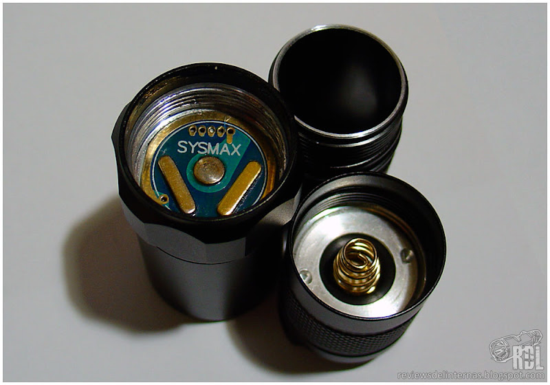

    The XP-G R5 LED is perfectly centered. Inside we have the circuit, which has a solid positive, and two bands that act as a shield against the installation of battery with reversed polarity.
    In the small central tube, besides the aforementioned good knurling and the two tracks that will allow us to install the clip in both directions, we have the threads. Although it’s no thick finish like the one featured on the Explorer series, the machining is excellent. Furthermore the threads at the tailcap are anodized, allowing the lock-out function by loosen only a few millimeters, avoiding involuntary turn-on when we have the flashlight, for example, in a pocket.
