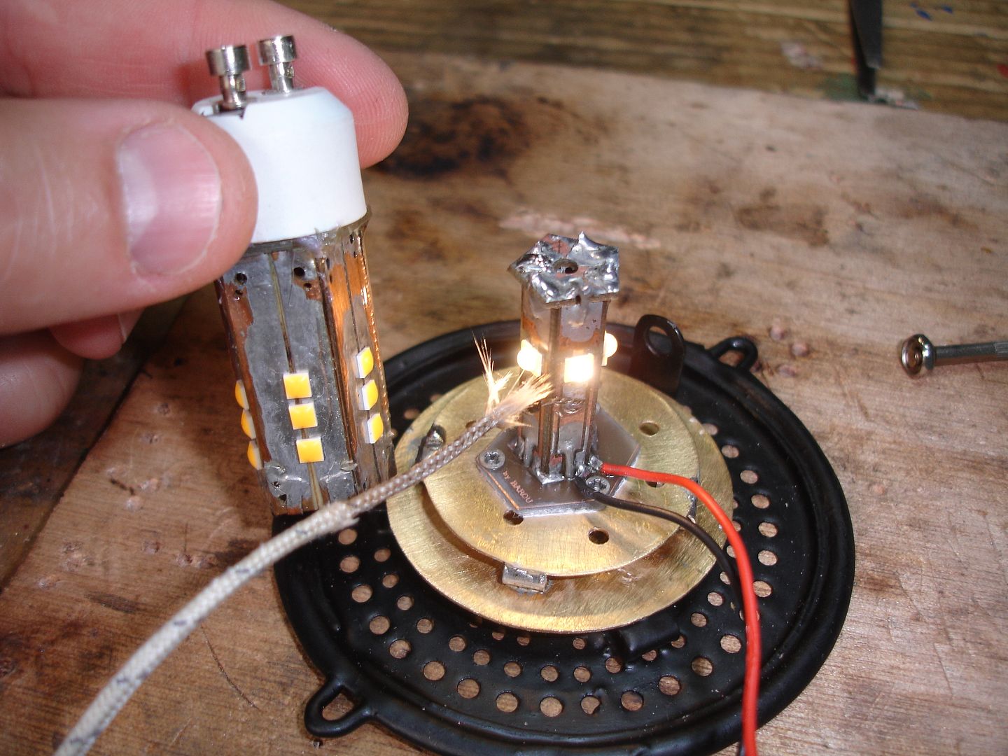

    Hi all,
    This post has to do with sharing some info regarding the developing of long wanting new type of lighting element.
    Goals were:
    1*easier to make
    2*lower profile for use to tiny lanterns also
    3*more compact lighting element with 5 high power LEDs for creating a light emitting spot rather area.
    4*Higher achievable output as much as 1000 lumens
    5*Can be replaced
    Leds used for this new lighting element approach are seoul's semiconductors SZ5-M1-WW-C8-V1V2-HA 80CRI min, 2700K
    data and datasheet: http://www.mouser.com/ProductDetail/...%252bvPw%3D%3D
    Despite my efforts, different heatsinks used and interfaces between heatsink and lighting element (pentahedron) goal 4 was not achieved. Actually there is only a marginal improvement in heatsinking than old element whereas the old one was limited to 3.5-4w of heat dissipation the new one goes 4-4.5 watts.
    I have replaced the custom brass heatsink with a quite large copper sheet than presents an very small thermal resistance (big heatsinking ability) and found out that the systems thermal resistance marginally imrpoves. Major thermal resisstance comes from the very construction of the pentahedron.. Temporarily i am out of ideas.. perhaps a more heat conductive solder...
    So as it stands now, new lighting elements can deliver top 500 (4.3w power dissipation) lumens reaching some 95 degrees celcius at LEDs at that power level with an ambient 25 degrees celcius temp.
    Extensive temp measurements were taken to conclude those.
    when attemping to over power the new lighting element above 5w input, then thermal runaway is a major concern that leads to further input power that surely in the long term will damage the leds.
    Beside all these obstacles and limitations, IMO, the new element is undeniably an improvement.
    http://s1358.photobucket.com/user/ba...eshow/9-6-2015
    or
    http://s1358.photobucket.com/user/ba...brary/9-6-2015
    your comments are welcomed
    cheers,
    barou

    Barou,
    Perhaps if you OPEN the TOP, and the BOTTOM of the pentahedron, so that air may circulate due to convection, I don't know if that would help, but it is a thought.
    Another is to have another copper heat sink at the top, similar to the one on the bottom.
    Maybe a finned heatsink? Aren't there some cylindrical finned CPU heat sinks?

    Hello poppy,
    Actually the top of the pentahedron is open with an 3mm hole some as the bottom. It is not shown so clearly in the picture but the sides of the pentahedron are not that hermetically sealed together.
    I have not any photo handy right now, but i started with a star type finned heatsink for leds. I also try other things. Nah.. it is not pretty. Especially in small and medium sized lanterns where distance between glass and heatsink is small, the finned heatsink does not look so cool. Let aside their geometries, produce thicker or not so thicker shadows.
    What i am saying is next to impossible to get what i really want except make it. (brass is cool also)
    Bear in mind that i have soldered for experimentation the pentahedron in a extra large copper sheet (large heatsink). Leds are cooled only a bit more and not substantially.
    Its about pentahedron's very structure that must be altered in order to attain higher power outputs.
    Anyway, it does a goood job for power about 4-5 watts. (450-550 lumens) and it seems good as a top limit, at least for now
    cheers

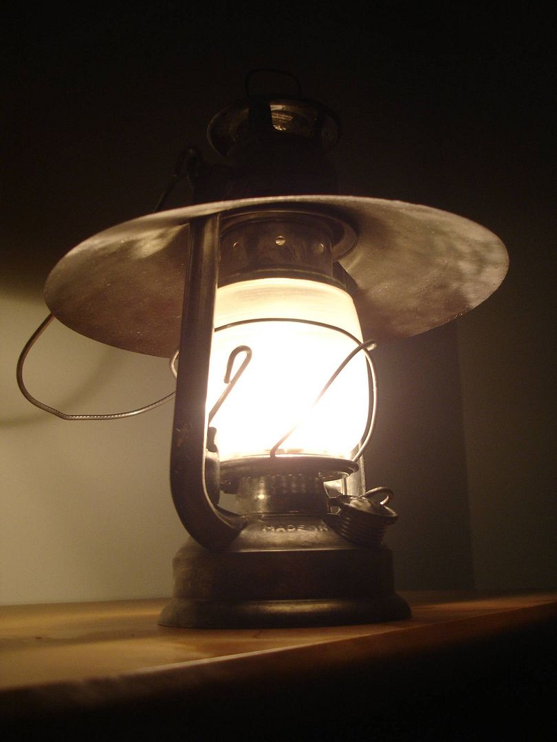

    Default first Reflector Lantern
    i have been busy lately (time allowing) at finilizing my long worked λ-series lanterns.
    This post is about my first lantern that came with a reflector (hood).
    Take a look of a hooded lantern
    slideshow http://s1358.photobucket.com/user/ba...eshow/6-7-2015
    For artistic shake, i let lantern unfinished, actually it is tinned and the tin has tarnished from places to places but still holds ok cocnerning rust protection.
    The hood on the other hand was in a rather poor condition of rust.
    Required, derusting andsurface preparing. Actually i applied on this, the black oxide process, thus "painting it" black on the outsidewithout changing its dimensions since clearances are really tight.
    That reflector is rather small around 20 cm diam and was made for cosmetic reasons rather real reflecting job. Hence it was painted black inside and outside.
    Inside surface now is iron polished and laquered so as to not rust and reflect light, and outside laquered black oxide.
    This BAT158 lantern has its red led also removed from usual position, perpedicular so as to light the dimmer/on-off switch.
    cheers,
    Barou

    I have made also reflectors for hotblast lantern models.
    I intend to make them a staple item and each lantern i sell to have its reflector.
    why reflector?
    Reflector's functionality, aside for being more cool in my oppion
    • allows lantern to be hunged overhead, avoiding the line of sight to be at the level of light source, thus blinding and "wasting lumens" in subjective perceived lighted area.
    • redirected lights downwards eliminating lanterns tank's shawdow.
    • redirected lightt downward is especially usefull to when walking with lantern (not blinding) and in outdoor situations that light that goes to sky is lost light.

    Default Re: Baroutologos's Handcrafted - Rechargeable LED Hurricane Lanterns
    Barou,
    The addition of a reflector/shield is a nice touch.
    Last year, while fooling with various diffuser shapes. I discovered that the color of the reflector made a difference in the color/tint of the reflected light. I was working with cool white emitters, and found that I preferred natural wood to a pure white, or shiny metal, reflector. It probably isn't as efficient, but looks nicer/ was gentler on the eyes.
    My Grand Kids call me Poppy
  20. #80
    Hello Poppy,
    Yes you have absulutely right. I have made so far, stainless steel mirror like reflectors to polished iron. I prefer tha later personally. Glaring reflectors imho is the last thing i want.
    cheers,
    Barou
    ps: yes, reflector tint surely will affect overall light color emmited
