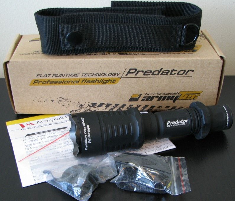

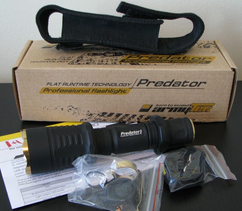

    Packaging is common for both versions - a typical carboard box, with ArmyTek logos and graphic design on it. Inside, the light comes packaged between two pieces of packing plastic-styrofoam, with a good quality holster with closing flap, wrist lanyard, spare o-rings, tail switch boot replacement cover, manual and product insert/warranty card.

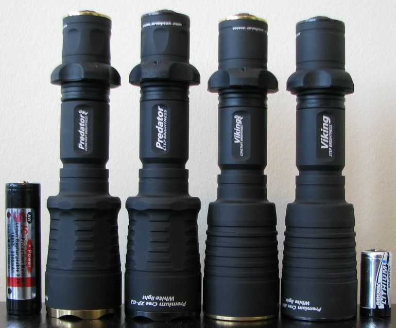

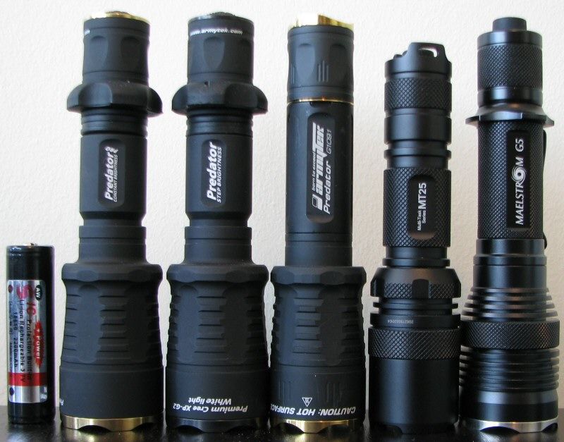

    From left to right: AW Protected 18650; Armytek Predator Pro v2.5, Predator v2.5, Viking Pro v2.5, Viking v2.5, CR123A.
    From left to right: AW Protected 18650; Armytek Predator Pro v2.5, Predator v2.5, Predator v1.0; Nitecore MT25; Foursevens G5.

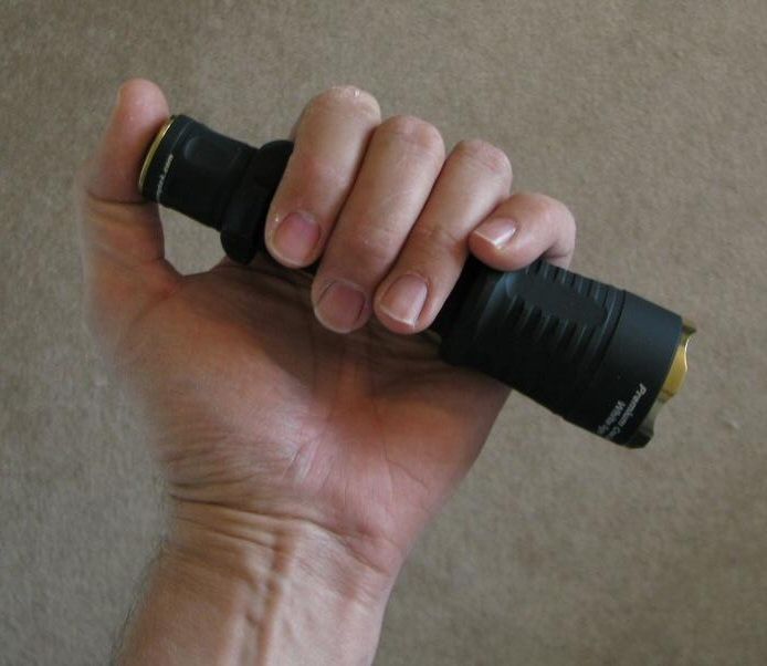

    ArmyTek Predator V2.5: Weight: 161.8g, Length 155mm, Width (bezel): 39.5mm
    ArmyTek Predator Pro v2.5: Weight: 161.0g, Length 155mm, Width (bezel): 39.5mm
    ArmyTek Viking V2.5: Weight: 159.8g, Length 153mm, Width (bezel): 39.5mm
    ArmyTek Viking Pro V2.5: Weight: 161.9g, Length 152mm, Width (bezel): 39.5mm
    ArmyTek Predator V1.0: Weight: 134.6g, Length 153.9mm, Width (bezel): 36.7mm
    Foursevens G5: Weight: 145.5g, Length 156mm, Width (bezel): 38.9mm
    Nitecore SRT7: Weight: 172.4g, Length: 158mm, Width (bezel): 40.0m
    Olight M22: Weight: 148.4g, Length: 144.8mm, Width: 41.2mm (bezel)

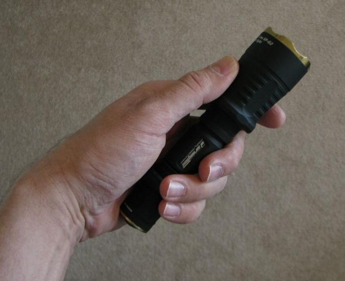

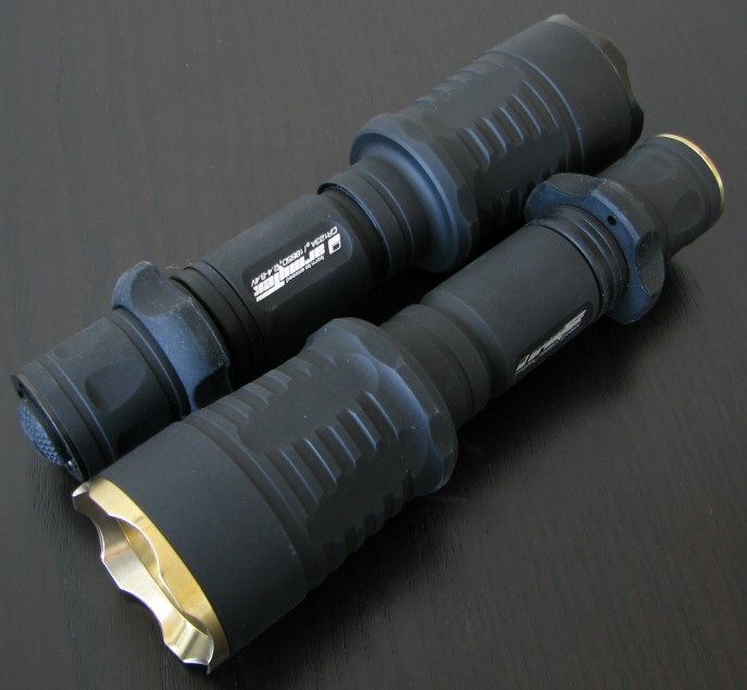

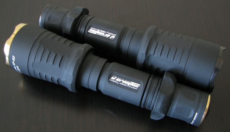

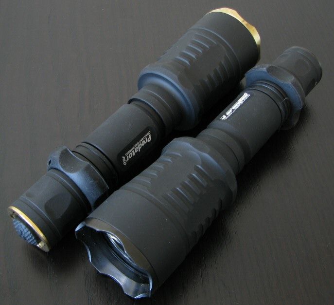

    Overall dimensions are similar to the original Predator, but the new ArmyTek lights are heavier now, with a more typical bezel diameter. Overall dimensions are consistent for this class.

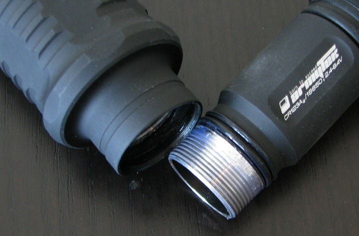

    As always, ArmyTek build quality is very high, and the lights have a very robust feel. Physically, the models are distinguished primarily by their emitters (XP-G2 on the Predators, XM-L2 on the Vikings) and corresponding reflectors. The Pro versions differ from the regular versions in terms of circuit features and interface. All lights come with a choice of bezel/tail ring colors and crenelation styles.
    The ArmyTek finish is fairly unique in my testing - the bodies of their lights have a very thick matte finish anodizing that feels almost molded (i.e., it is very "grippy"). According to ArmyTek, this coating is much thicker than most lights (i.e., harder anodizing). Although the light lacks knurling, grip is actually quite decent thanks to this unique finish. And there are some ridge detail elements to help further with grip.
    Note the grippier finish may show dirt, hand oil, etc, more easily than traditional glossy knurling. There are also few anti-roll features, aside from some cut-outs in the bundled rubber grip ring.
    Lettering is very bright and clear, and exceptionally legible. In additional to model information on the body tube and bezel, the voltage range and supported cells are printed right on the light.

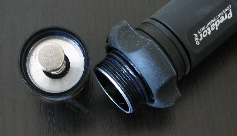

    Screw threads are thick square-cut (trapezoidal), and anodized at the tail region of the battery tube and in the tailcap (for lock-out).

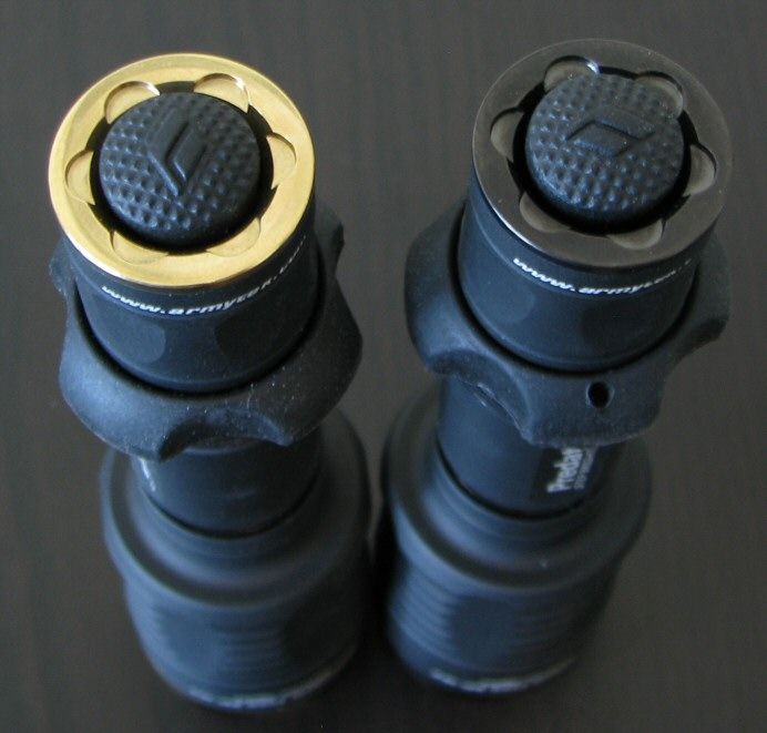

    The tailcap switch is a forward clicky in all lights, with good feel. The spring is thicker and longer than typical on these sorts of lights, with a flat connector piece (so as not to scratch your batteries). The lights cannot tailstand.

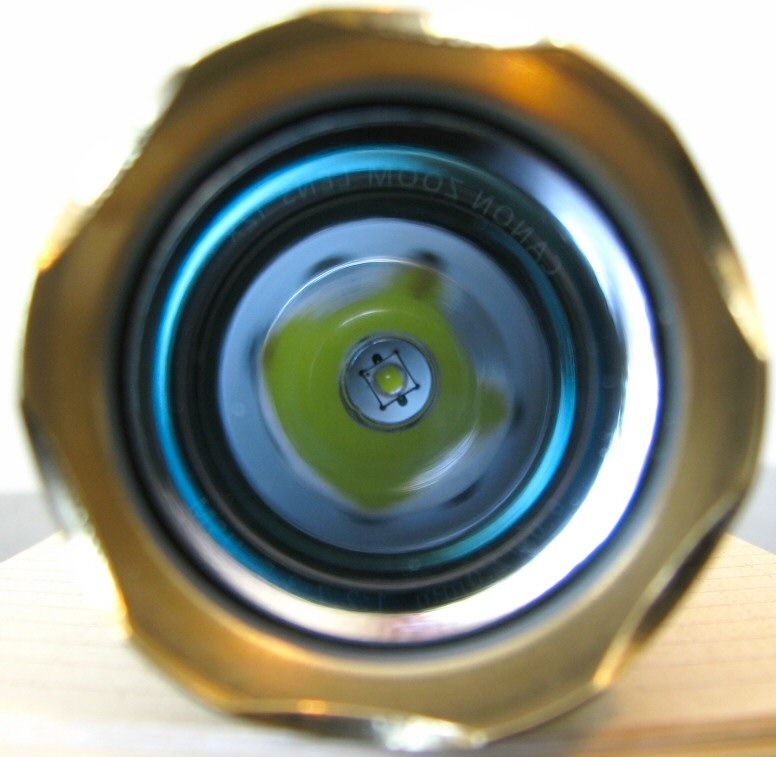

    There is a small raised contact point in the head, so high capacity flat-top batteries can be used. All my 18650 cells fit in the lights – there is in fact quite a generous amount of cell length space.

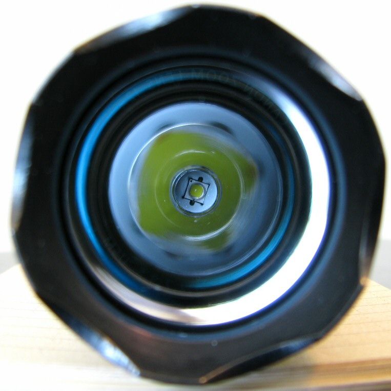

    The Predator reflector is optimized for max throw, with a 5 degree spot angle for its XP-G2 emitter. In contrast, the more general purpose Viking has a 10 degree spot angle for its XM-L emitter (both series have a 40 degree spill angle). As you see in the pics below, even though the Predators put out less light overall, they can deliver more light on target at a distance.
    Both my samples in this series came with smooth reflectors, so some artifacts are possible. Emitters were all well centered on my samples. There is an anti-glare coating on the lens, which gives the signature ArmyTek green tint. ArmyTek claims this is a higher quality anti-glare coating normally found on photographic equipment.
    ArmyTek doesn't supply diffusers, but the Olight M22 diffuser fits fine on all bezel styles (as should most ~40mm diffuser covers).

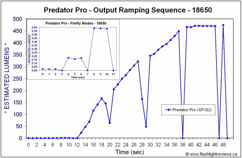

    But I can at least explain the general process. To select a variable output level in the first line, start from head tight and loosen the head for at least 1 sec and wait for the light to switch lines. Once it does, then immediate tighten, and wait again for the line to switch back. When it does, immediately turn off-on at the clicky. All the above has to be done in under 3 secs total, so timing is very tight (i.e. don’t delay on the head twist any longer than necessary to switch lines). It is highly unlikely that you would ever enter the programming state by accident.
    Here is what the light will do, as plotted in estimated lumens (note: this is not my relative output scale, but actual computed lumens):
    I show a blow-up insert of the first ~11 secs or, as the Firefly modes are too dim to compare to the continuously variable ramp.
    As you can tell above, you get three Firefly modes in sequence, for about ~3 sec each with a ~1 sec off pause between them. This is followed by continuously-variable ramp from Lo to Max, which takes about 40 secs in total (with flashes at 25%, 50%, 75% and 100% output). Once Max output is reached, the light restarts at lowest Firefly and cycles through again. Make your selection by a loosen-tighten head switch.
    The continuously-variable ramp is relatively visually-linear to the eye (at least up to the 75% mark), and the quarter percent flashes are helpful to calibrate your relative setting. Beyond the 75% mark though, light output seems pretty constant. I am not quite sure why this is, but note that my Viking Pro v2.5 continues to risk in output over the whole ramp.
    But you will have to be quick to select any of the truly low outputs. Note that the lowest non-Firefly level that I was able to capture off the contrinuous ramp was ~25 estimated lumens.

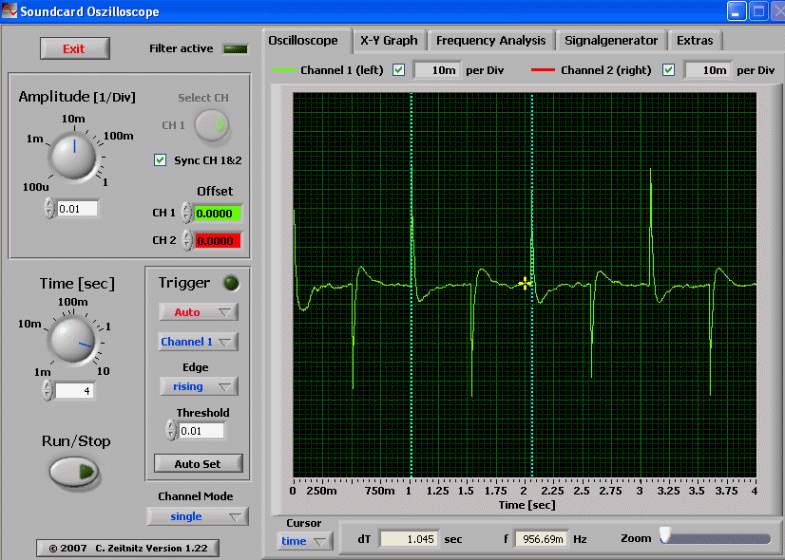

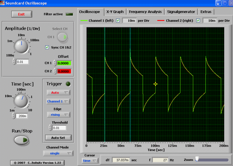

    PWM
    Light has no evidence of PWM on any mode, leading me to believe it is current-controlled.
    UPDATE JULY 13, 2013: Actually, there is a reoccurring signal on the second Firefly mode (but not the first or third) of both the Viking Pro and Predator Pro. Unfortunately, the light intensity is too low for my oscilloscope sensor to detect, but I can measure the frequency by freeze-frame photography: it is 180 Hz on both lights. Without an oscilloscope trace to examine, I am unable to ascertain whether or not this is actual PWM. But regardless, this frequency of "flicker" is detectable by eye.
    Strobe/Beacon

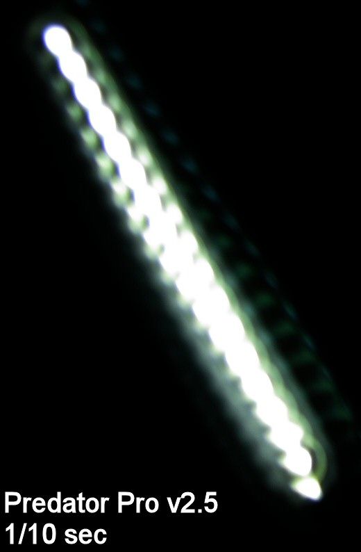

    There is no strobe mode on the regular series model – it is only the Pro version that supports blinking modes.

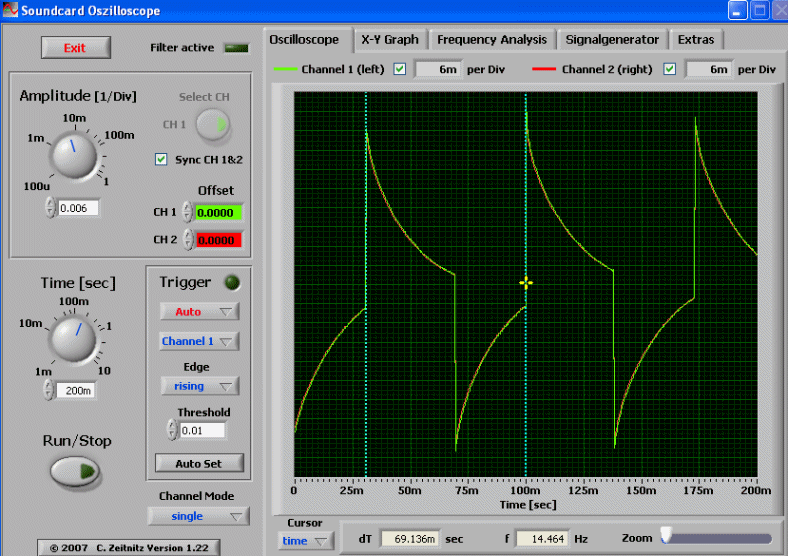

    The default strobe on the Pro is rated as 15 Hz:
    Which, as you can see, seems pretty accurate according to my oscilloscope.
    According to the full manual, you can set the strobe frequency anywhere from 1 to 50 Hz. Here's what I managed to set as the lowest and highest strobes:
    And again, pretty good concordance with my oscilloscope.
    Note that the original Predator claimed this same 1-50 Hz range as well – but the strobe frequency changed so quickly (i.e., at an accelerating rate) it was next to impossible to select the really high modes. I am happy to report the new Pro models provide a slower acceleration rate. You now have ~28 secs to select your strobe frequency, although you have less than ~8 secs to choose anything in the 20-50 Hz range. Still, this is much better than the original Predator, when you had ~1 sec to select anything in this range.
    Here are some additional strobe modes that I captured, after ~6 secs and ~23 secs:
    A minor point for you techno-geeks: as with the original Predator, the strobe pulse duration (duty cycle) does not stay entirely consistent across the full range of frequencies. A typical strobe mode has a 50:50 on/off cycle. But starting at the >30Hz frequencies on the Pro version, the on-pulse duration gradually increases to ~60% by the max 54 Hz (i.e., 60:40 cycle). That is more consistent than the original predator though, which was already at ~65% by 30Hz. None of this matters in terms of how disorienting the strobe is, but I thought I'd point it out.
    As an aside, I don't find 54 Hz strobe very "disorienting" … it's almost like a really bad PWM rate at that level.

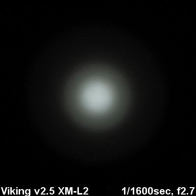

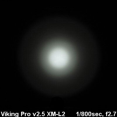

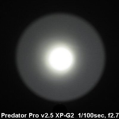

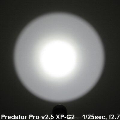

    For white-wall beamshots below, all lights are on Max output on an AW protected 18650 battery. Lights are about ~0.75 meter from a white wall (with the camera ~1.25 meters back from the wall). Automatic white balance on the camera, to minimize tint differences (but there may still be some variation).
    Let's start with a comparison of the Predator and Predator Pro against the Viking and Viking Pro.
    To show how you the Predator Pro compares against the competition, here are some comparisons to XP-G lights in my collection. In the pics below, "Predator" refers to the original V1.0 model, "G5" is the Foursevens Maelstrom G5 (now MMS) and the "TD-15" is the original Lumintop TD15.
    The new Predator v2.5 XP-G2 models are clearly higher output – with greater peak throw – than these earlier XP-G lights.

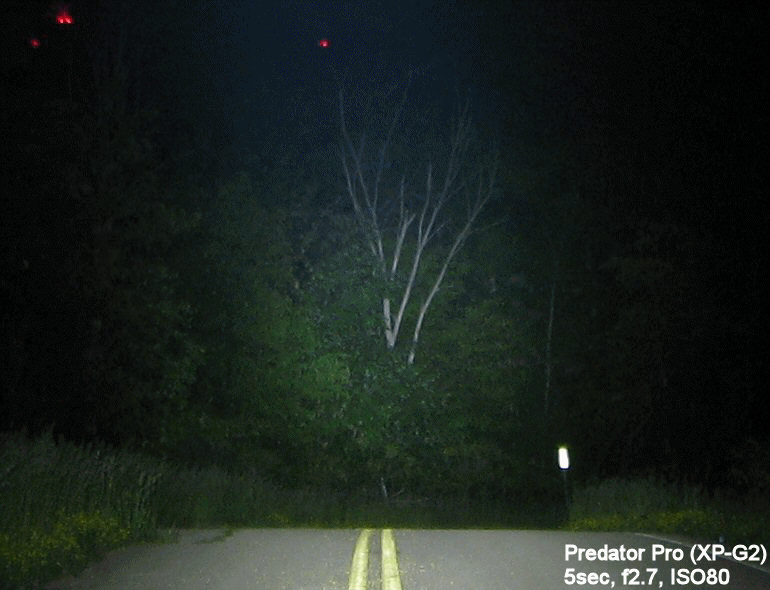

    Outdoor Beamshots
    For outdoor beamshots, these are done in the style of my earlier 100-yard round-up review. Please see that thread for a discussion of the topography (i.e. the road dips in the distance, to better show you the corona in the mid-ground). FYI, any "streaks" you see across the images are bug-trails. Flying insects are often attracted to the bright lights, and their flight trails get captured as swirly streaks due to the long exposure time. Also, ignore any tint differences below – they are mainly due to the automatic white balance setting on the camera.
    Again, let's start with a comparison of the Predator and Viking classes. For outdoor shots, I am only showing the Pro versions of the Predator and Viking.
    ArmyTek intends for the Predator and Viking models to be used by different groups. As you can tell from the beamshots above, the beam patterns at a distance are clearly very different.
    Now, let's see how the Predator Pro compares to some relatively throwy recent XM-L2 lights in my collection.
    While lower overall output, the Predator certainly does throw a more focused beam than your typical well-focused XM-L2 light.
    As expected, The Predator models have less output – but more throw – than the Viking models.

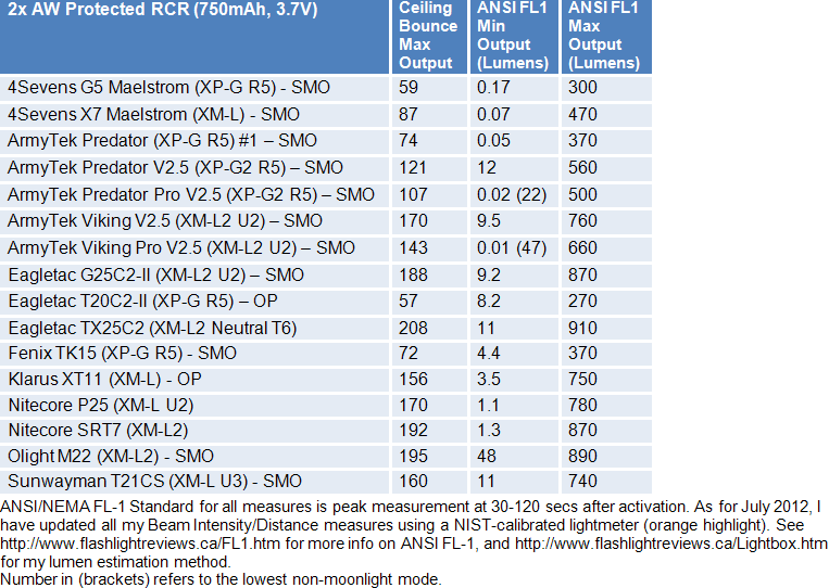

    The two Predator versions are rated to the same max output level ("670 LED lumens"), although my regular Predator seemed surprisingly bright at an ~560 estimated ANSI FL-1 lumens. Note that "LED lumens" typically refer to theoretical max output of the emitter for a given drive level, and do not take into account actual losses due to the circuit, heat build-up in the emitter, reflector and lens effects, etc. All told, these can easily cut ~25-30% off the theoretical output levels. Note that ANSI FL-1 testing standard requires actual measurement of output "out the front", between 30-120 secs after activation.
    My direct beam measures show an impressive result for the XP-G2-based Predators.
    How do my lumen estimates compare across the various levels?
    As you can see, my results are fairly consistent across the board (taking into account my ANSI FL-1 estimated lumens vs ArmyTek's published "LED lumens").

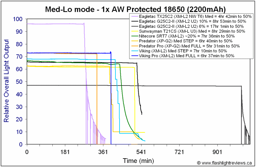

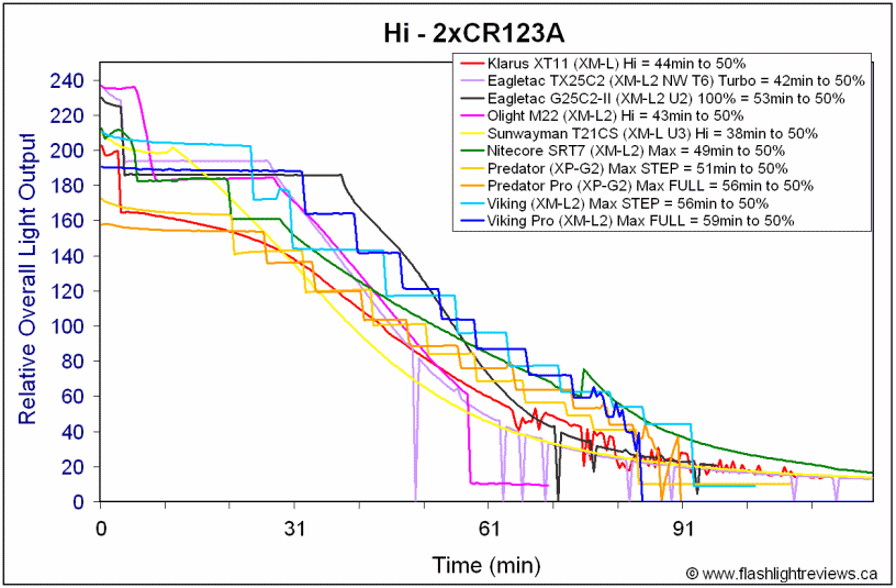

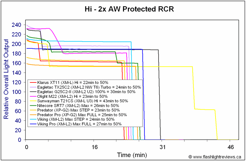

    Output/Runtime Graphs:
    Note: Unless otherwise stated, all my runtimes below are based on AW 2200mAh 18650 cells.

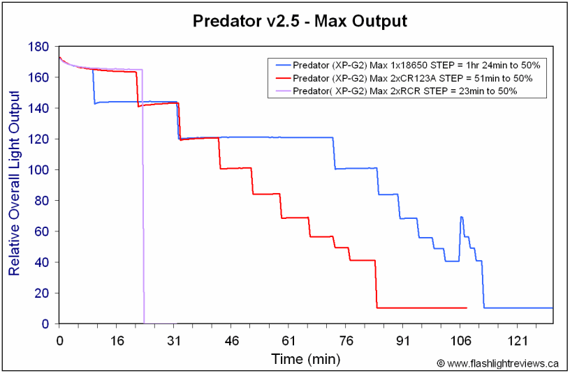

    Ok, let's start with the base Regular model, on different types of cells.
    The Regular model uses a "STEP" regulation method, where the light steps down in output by discrete levels, depending on the amount of battery power remaining. This is typically quite efficient (scroll down for comparison runtimes). What you can see above is that on Max, 2xRCR hits an abrupt termination (due to the protection circuits being triggered). But the 2xCR123A and 1x18650 show a very clear step-down pattern.
    Let's compare that to the default "FULL" regulation method on the Pro version:
    In FULL regulation, the light should abruptly shut-off on all Li-ion sources, without prior step-down. You can see that above quite clearly for the 1x18650 and 2xRCR runtimes. Interestingly, 2xCR123A continues to have a step-down pattern, even when FULL regulation is selected. One general comment here – you can expect a significantly shorter runtime on 1x18650 when FULL regulation is selected.
    To demonstrate that, let's compare the various regulation patterns on the Pro model (STEP, SEMI and FULL – see UI section earlier in this review for an explanation of the terms):
    As you can see above, SEMI and STEP have generally equivalent runtime – it just comes down to whether or not you like to see discrete steps. I am a bit surprised as how much lower the Max runtime was on FULL, but that may reflect the lower capacity 2200mAh cells used here (i.e., it's possible higher capacity cells may have handled the high drive level better). Personally, I recommend you program the Pro version to STEP or SEMI for maximum runtime (and clearer indication of battery life remaining).
    Alright, let's see how the Regular and Pro versions do compared to the competition. To make the runtimes easier to distinguish, the Max modes on the Pro version were done in FULL and SEMI regulation (in contrast the typical STEP of the Regular versions).
    As expected, the XP-G2-based Predator models don't have the same max output as the XM-L2 Vikings (or other XM-L/XM-L2 lights, for that matter). Note that XM-L2 will produce more light than XP-G2 for the same current. But at lower drive currents, there typically isn't much of an efficiency difference between these emitters. You can see that in the results above – at lower levels, the Predator (XP-G2) perform similarly to the XM-L/XM-L2 lights.
    Note also that I left the Pro version on FULL stabilization for the Med mode runtime. Based on my previous experience, there typically isn't much of a runtime difference between stabilization methods at the sub-maximal drive levels.
    In terms of overall efficiency, the Predators seem to hold their own quite well, at all levels tested.

    As before, I am glad to see that output/runtime performance is right on par with other decent current-controlled lights of this class.
    In terms of beam pattern, the Predator models maintain the traditional focus of this series on max centre-beam throw. The XP-G2 emitters used here are well suited to this task. For those looking for a less "throwy" option, check out my concurrent Viking series review. But in any case, many of the ~40mm diffuser covers should work with the Predator, giving you option of diffuse light if you want it.
    ArmyTek is really trying to give you a clear choice between throw and a broad hotspot (i.e. Predators vs Vikings), and simple or sophisticated interface (i.e., Regular vs Pro versions). With the continual improvement updates to the Predator/Viking lines, there is little to criticize here – I like the subtle build and interface improvements that have been introduced since my original V1.0 review.

    You said "Light has no evidence of PWM on any mode, leading me to believe it is current-controlled."
    Can you checking the second lowest mode? This mode has pwm(?) flickering. I checked my lights (Viking Pro 2.5 and Predator Pro 2.5) What do you think?

    Over 30K lux sems pretty impresive for a light of this size. I think I'm sold. Is there any other light of this build with XP-G2?
    BTW thx for this fantastic review
    Default Re: ArmyTek Predator 2.5 (XP-G2 R5 1x18650 2xCR123A/RCR) Regular and Pro Review: RUNT
    That's an amazing amount of throw from that size of a light.
    Do you mean the second lowest Firefly mode, or one of the default regular modes? I didn't notice any flicker during testing, but didn't leave them in the Firefly modes for long. I will double-check, but I am unlikely to be able to get a reading from the lower two ... generally, <1 lumen is typically below the detection threshold from my oscilloscope sensor.
    In my experience, flicker is not uncommon on moonlight/firefly modes. It seems to be hard for current-controlled makers to stably run lights at such low currents. But I will double-check tomorrow and report back what I am able to see and measure.
    Quote Originally Posted by blackFFM View Post
    Quote Originally Posted by whatswrongwithmee View Post
    Yes, it is interesting how the XM-L/XM-L2 has virtually completely replaced the XP-G/XP-G2 - even though the latter is far better suited for throw applications. I can only imagine that people chase the highest possible lumen output, and manufacturers respond to that.
    But I think the outdoor beamshots tell an interesting story - all those extra lumens of the XM-L2 get dissipated in the spill (unless you have a much larger reflector to focus them). If you want to put a good amount of light on a target in the mid-to-far distance (with a reasonably compact flashlight build), XP-G2 is a better way to go.
    The second lowest firefly mode.

    I'm in need a new pocket size thrower and am struggling which to choose. One handed operation and simplicity are key for me. Can you twist the bezel with one hand? I'm looking at the basic model so I wouldn't be doing this move a lot. Just going from low to turbo and back occasionally.

    Quote Originally Posted by gopajti View Post
    Yes, there is a reoccurring signal on the second Firefly mode (but not the first or third) of both the Viking Pro and Predator Pro. Unfortunately, the light intensity is too low for my oscilloscope sensor to detect, which is why I missed it before (i.e., no signal above background).
    But I can measure the frequency by freeze-frame photography: it is 180 Hz on both lights, as shown below.
    Without an oscilloscope trace to examine further, I am unable to ascertain whether or not this is actual PWM. But regardless, this frequency of "flicker" is detectable by eye. Thanks for the heads up gopajti.
    Quote Originally Posted by tubed View Post
    Unless your hand grip strength is a lot higher than mine, I would have to say no. The Pro lights really need two hands to do a head twist. I suppose the right lube, grip (and strong hands) could do it, but I wouldn't want to rely on that.
    Just to chime in on what you guys have already confirmed, I think high frequency PWM was necessary to get that lumen level ever since V 1.2.

    Quote Originally Posted by dajabec View Post
    That's certainly possible for the other two Firefly modes - although the frequency would need to be extremely high for it not to be visible when shining on a fan. Since my oscilloscope sensor can't detect levels that low, I can't verify the PWM on these levels. But it is odd that only the middle Firefly level (on both Pro models) needs to have such a low frequency visible PWM.

    On more of a personal preference note, how do you find the narrow spill of the Armyteks compared to their competition in terms of beam usefulness?

    Well, I typically use a diffuser on most lights outdoor, so native reflector spill angle doesn't matter much to me. When I want throw, I just remove the diffuser - at which point, hotspot intensity is what really matters to me. The Predators are certainly impressive throwers for this size.

    Did a quick runtime test last night on a Fasttech 3400 mAH protected 18650. Seemed a bit short, got 55 mins on full regulation. However, after I ran it down in max mode I was able to get another 45 mins regulated in 200 lumen mode so it seems to not be draining the cell completely. This cell was at about 4.05V I believe before starting, I'll re-do it with a totally topped off cell just to see if there is a noticeable difference. It should be noted that the light gives you plenty of warning before dropping to firefly, it seems to blink 3 times once per minute roughly for the last 20% or so of the battery life.
    I will likely be using the stepped or semi mode in regular use rather than the full regulation.
    I had the light out on a trail in the city here last night. Even without complete darkness and drizzle in the air the light seriously impressed. One thing I noticed, this light is just about perfect as a mid to mid-far range light. 20-100 yards is handled beautifully by this beam. I had some reservations about the narrow spill and tight beam but it also works in a pinch as a walking light, though I'd probably prefer a floodier light or a diffuser for a longer hike, especially on uncertain terrain.
    I passed a group of people walking on the trail (they were using no lights most of the time and a phone light when needed it looked like) with the light on 5 lumens just to see where I was going and not to aggravate them with a bright light. After passing them by a good 20-30 yards I decided to switch to max mode and see what it could do. Instantly the entire trail was clearly lit up in front of me with the beam reaching easily 80+ meters out to the back of the trail leading into a turn. I heard someone behind me say "oh my god what is that". I have no doubts that in a more open area, without light pollution and rain you could comfortably hit 250m with this light.
    Compared to my favorite thrower in my collection, Solarforce MPP-1 /w UCL (XR-E R2, large smooth reflector, likely around 50-55 kcd) the Predator compares quite favorably. The intensity is only slightly outdone by the MPP-1 but you get a hot spot about 4 times bigger, and a narrower but noticeably brighter spill. Not to mention the head diameter is much smaller than the MPP-1.

    Did a proper runtime test. Still came up a bit short to Armytek's spec but got a good bit closer. Cell was charged this morning, measured at 4.19V before commencing test:
    3400 mAh Fasttech on Max output, full regulation
    Low battery indication - 53 minutes
    Runtime til moonlight - 66 minutes
    Additional runtime on 200 lumen mode -31 minutes

    All I can say is wow. This is one hell of a light. Lighting up a parking garage 125 yards away like it's nobodys business. In the rain too. I thought my T20CS threw, and it does, but the Predator outdoes it by far.
    Build quality seems top notch. And no flickering issues on it, yet anyway. This is a keeper.
