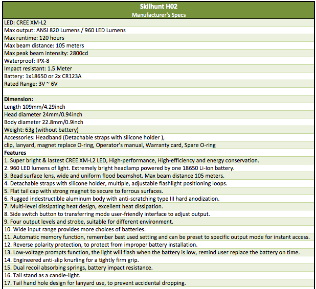

    Manufacturer's Specifications
    Price: 46 USD

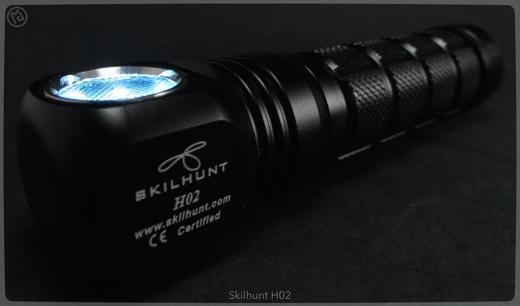

    Plus, here's a few shots with some good detail.

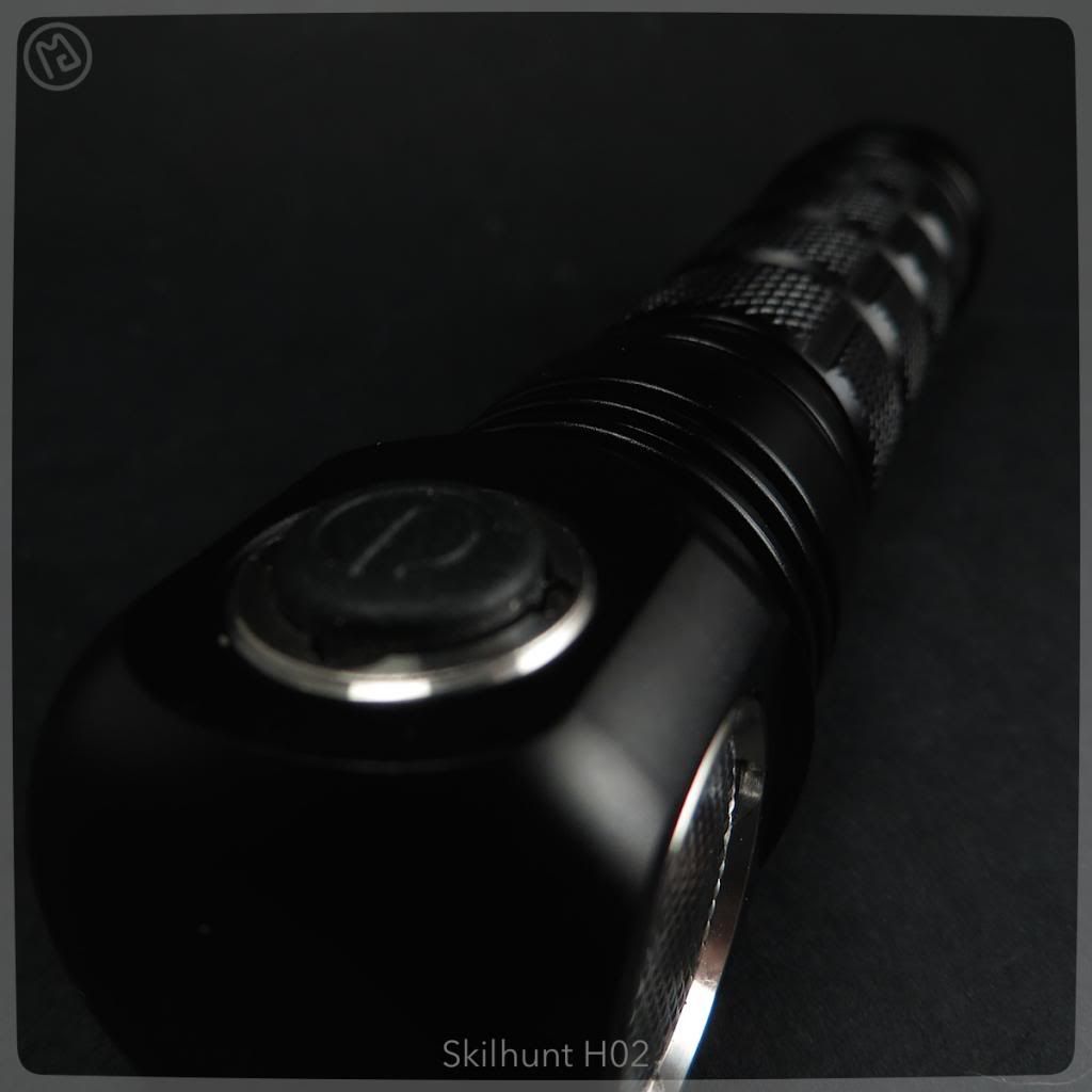

    The H02 shares an interface with models in the DS series, controlled by a single electronic side switch (a magnet in the tail has replaced the traditional tail switch).
    To turn the light on in the last brightness mode used, press the switch once quickly. Once on, a single quick click rotates through the sequence Low -> Medium -> High -> Turbo. Two quick clicks switches to strobe mode. To turn the light off, hold down on the switch for about a second.
    Also, when the light is off, you have direct access to the Low mode by holding down the switch for a second instead of a quick click, or direct access to Turbo by using two quick clicks. The result is that when the light is off, you can always turn it on in Low, Turbo, or the last used brightness setting.

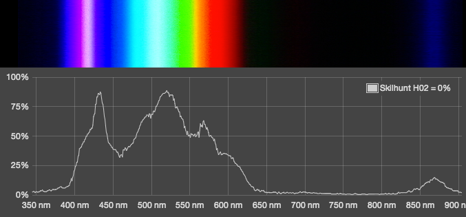

    Spectral Analysis
    All light that we see as white is actually made up of several different colors put together. The relative intensities of the different colors in the mix are what determine the tint of the white we see. For example, cool white LED's have a lot of blue, and warm white LED's have more red or yellow. This measurement was done on a home made spectrometer. The plot below the picture is corrected for the spectral sensitivity of the human eye. Note: the peak in the 900nm region doesn't really exist, it's a piece of the second-order spectrum that's showing up here because of the high intensity of the light source.

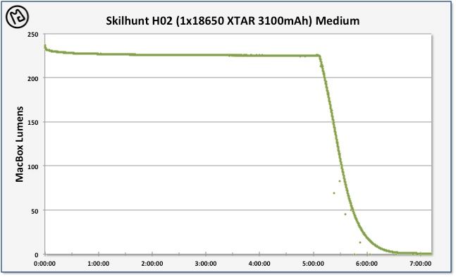

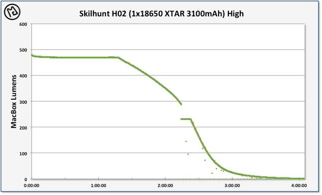

    Output and Runtime
    ANSI FL-1 runtime ratings are the time it takes for a light to fall to 10% of it's original output (counting from 30 seconds after turning the light on).
    The vertical axis of the graphs below represents a relative brightness measurement using a home made light box. The horizontal axis is time in hours:minutes:seconds. Runtimes are stated in hours:minutes:seconds. These graphs may be truncated to show detail.
    Mode Comparison
    Turbo
    High
    Medium

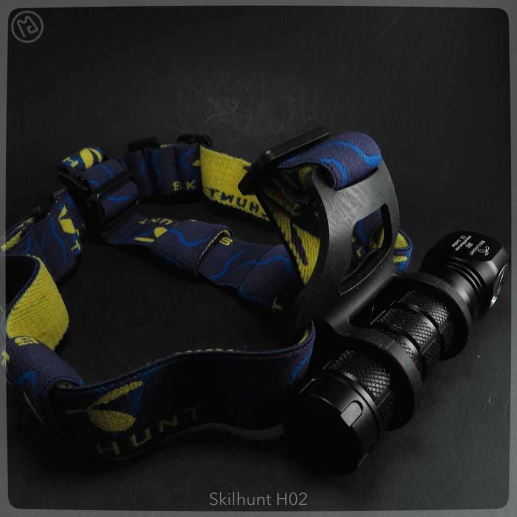

    First, this is a very compact light in the 18650 battery class. The design of putting the electronic side switch in the gap remaining in the head due to the shallow, side-facing emitter/reflector assembly really cuts down on the length needed in the head, and the use of a magnet in the tail cap instead of a clicky switch minimizes that length as well. Finally, the diameter of the body isn't much more than the diameter of the battery. There are certainly 18650 lights that are more compact, but this is definitely at the small end, and that's great for a headlamp, where large size or weight would become a nuisance very quickly. Second, the tail has a very impressive magnet. You can see the video above to see just how strong the magnet is. I've seen other lights with magnets in the tail, but Skilhunt is the first company I've seen to put a tail magnet in a high quality light, the others being the kind of cheep thing you find at a chain hardware store. The magnet is exceedingly useful for keeping the light where you want it in a variety of situations. Because the light is removable from the headlamp, there are really a ton of ways to get the H02 to point light where you need it.
    The headband of the H02 is very comfortable, and does a good job of keeping the H02 in place without causing discomfort, even for long periods of time. I find the over-the-top band of the headband makes a big difference in the comfort (some headlamps don't have that style of headband, just a single band around the side of the head). The rubber strap design that keeps the H02 in place makes it easy to adjust the angle of the light, but you don't have to worry about it moving when you don't want it to. Having the light source be slightly to one side instead of centered doesn't seem to make a noticeable difference to me when I'm using the light. I also prefer the side switch for a headlamp of this style, it somehow seems more comfortable to use than similar headlamps with a tail switch.
