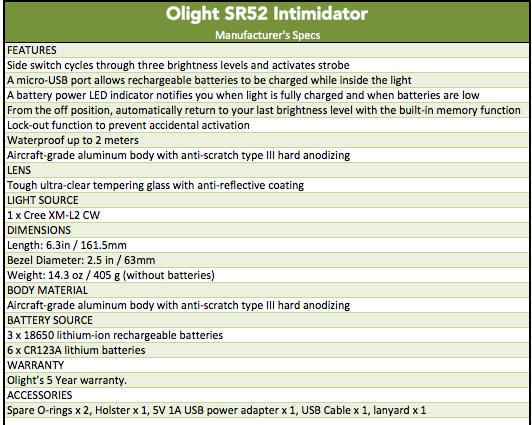

    Manufacturer's Specifications
    Price: 120 USD

    The SR52 has a very simple UI, with just three brightness modes and sone strobe mode controlled by a single side switch.
    To turn the light on, just give a click to the switch, and it will come on in the mode you used last. To change the brightness, hold the switch for about a second and it will cycle to the next mode in the sequence of Low -> Medium -> High. To turn the light off, just click the switch. At any time (on or off), a fast double click will activate the Strobe mode. When the light is off, you can press and hold the switch for a few seconds, and the light will first turn on, then turn off and enter an electronic lockout, where it will not respond to clicks until you again hold the switch for a few seconds and disable the lockout.
    Also, the SR52 features a micro-usb charging port with a red/green indictor light next to it. The indicator turns red when the light is charging, green when plugged in and fully charged, and flashes red when you are using the light and the battery starts to get low.

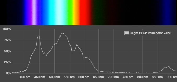

    Spectral Analysis
    All light that we see as white is actually made up of several different colors put together. The relative intensities of the different colors in the mix are what determine the tint of the white we see. For example, cool white LED's have a lot of blue, and warm white LED's have more red or yellow. This measurement was done on a home made spectrometer. The plot below the picture is corrected for the spectral sensitivity of the human eye. Note: the peak in the 900nm region doesn't really exist, it's a piece of the second-order spectrum that's showing up here because of the high intensity of the light source.

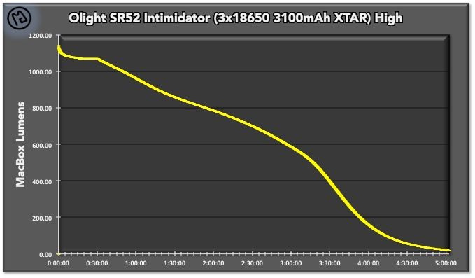

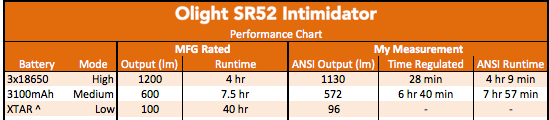

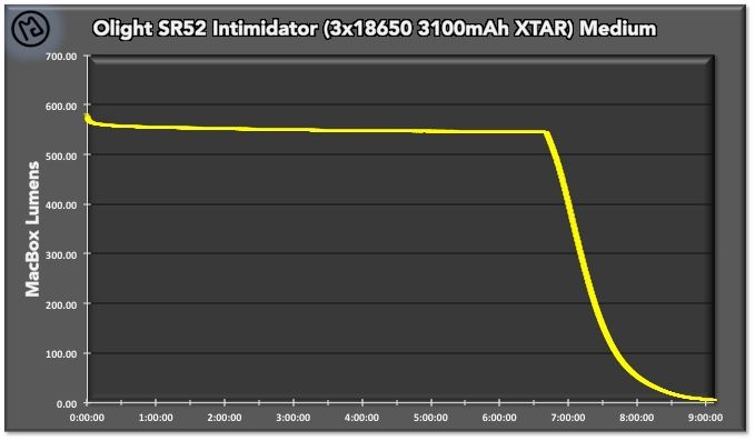

    Output and Runtime
    ANSI FL-1 runtime ratings are the time it takes for a light to fall to 10% of it's original output (counting from 30 seconds after turning the light on).
    The vertical axis of the graphs below represents a relative brightness measurement using a home made light box. The horizontal axis is time in hours:minutes:seconds. Runtimes are stated in hours:minutes:seconds. These graphs may be truncated to show detail.
    Mode Comparison
    Turbo
    High

    + Very accurate lumen and runtime claims
