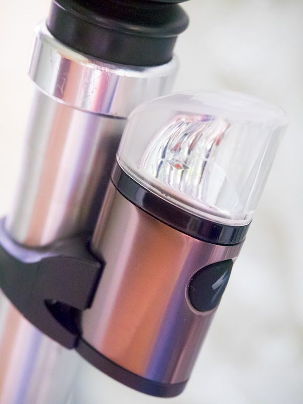

    Like the FLUX Expert Headlight, the fit and finish on the FLUX Expert Taillight is outstanding in every respect. Again, this is a solid, quality piece of kit, and the attention to detail is obvious.
    One interesting feature of this new taillight that might be of interest to road bikers, is it's uniquely sculpted body, which, according to Specialized, results in "zero drag".

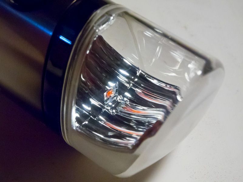

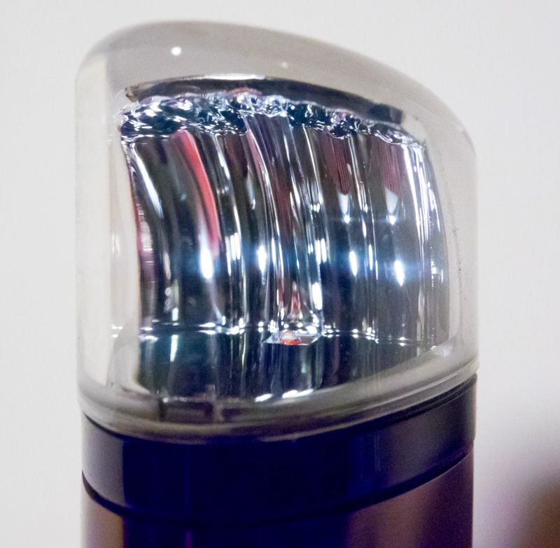

    Like the FLUX Headlight, the FLUX Taillight uses a specially designed reflector to precisely focus the light from an upward firing LED into a beam with exceptional visibility, even in bright day light.
    Behind the reflector, in a small compartment with a frosted lens, you can just make out the 2nd small LED, which comes on in 2 of the 3 MODES (CONSTANT ON and PULSE ), giving the light virtually 360 degree visibility.

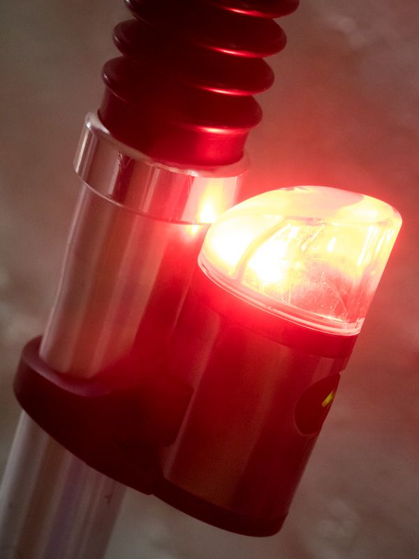

    The FLUX Taillight features 3 Modes (with mode memory):
    1. CONSTANT ON - 25 lumens for 10 hours
    2. PULSE - Pulsing between 5-55 lumens for 6 hours (1 pulse/sec)
    3. STROBE (2 strobes/sec) - 110 lumens for 14 hours during the day
    55 lumens for 17 hours during the night
    The Strobe Mode features a unique variable output which is controlled by a sensor on the light. This lets the light output itís maximum 110 lumens during the day, but automatically brings that level down to a much more eye friendly 55 lumens at night.
    Unfortunately, the variable output feature wasnít enabled on my pre-production model, so I didnít have a chance to check that out, but in theory itís a great idea.

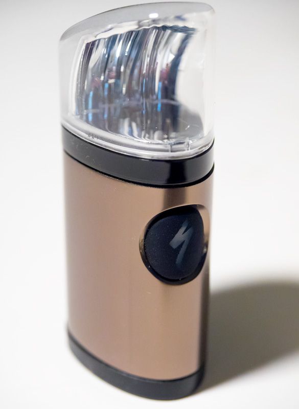

    On the front of the light is the single rubber MODE button, which activates an electronic switch. The MODE button features a small clear ďSĒ that glows a soft green color when the light is first turned on.
    The MODE button serves as the ON/OFF switch (tap quickly to turn ON, press and hold to turn OFF), as well as switching between the 3 modes (a quick tap).
    The MODE button sits flush with the surface of the light, and does require a substantial quick push to activate, meaning it would probably be difficult to accidentally turn it on in a bike bag, but, like the FLUX Headlight, Iíd like to see it changed to a 1 second press and hold to activate the light as well as turn it off, giving added protection against accidental activation.
    The backlit feature of the MODE button also serves two other functions. When the light is in use, it will give a quick indication of the remaining battery status, with Solid Green indicating 50-100%, Solid Amber indicating 20-50%, Solid Red indicating 5- 20%, and Flashing Red indicating that itís time to recharge.

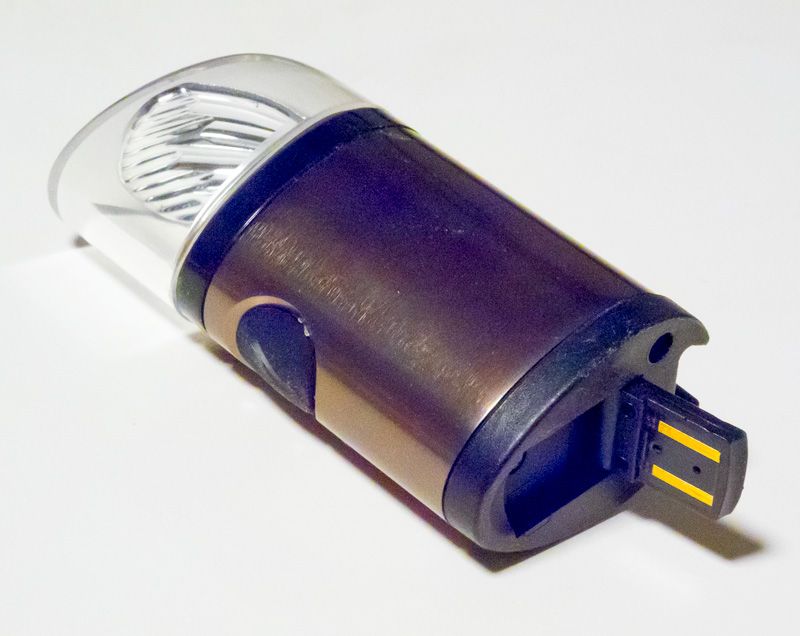

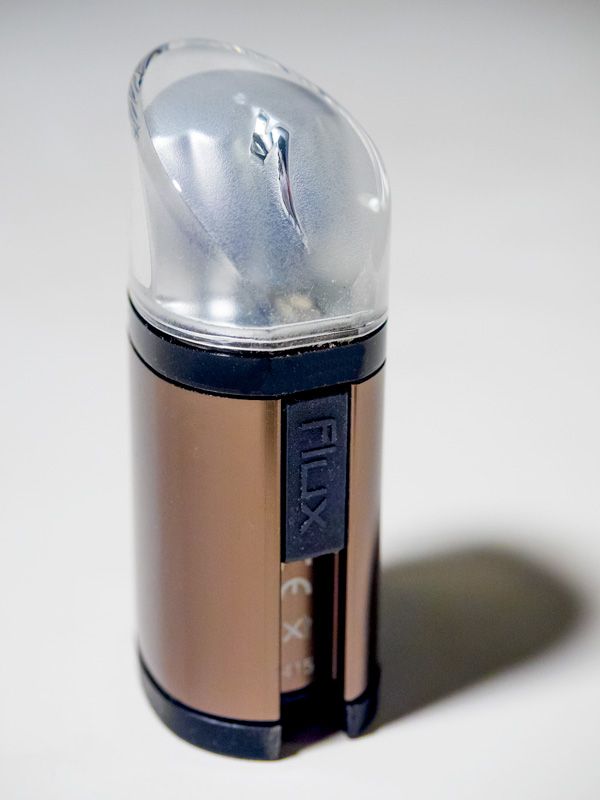

    Another nice feature of this light is itís built-in USB charging plug, which allows you to plug the light directly into a powered USB port to charge itís built-in lithium-ion battery pack, which typically takes 1 hour to 90%, with an additional 20 minutes to 100%. When not in use, the handy flip out USB charging plug folds flat into the bottom of the light and snaps securely into place, out of the way until needed.
    I found this flip-out USB charging plug to be very handy. No charger is included, but itís quite simple to plug the light into your computer for an hour or so, and bam, itís done. By the way, the Flux Expert Taillight's USB plug fits nicely into the port on the charger that IS included with the Flux Expert Headlight.
    The Flux Taillight has been specifically designed to mount on an angled bicycle seat tube, and comes with the appropriate mounts to fit 3 different sized tubes, including a round 27.2mm tube, a round 30.9mm tube, and an oval shaped VENGE tube.
    Attaching the mount is relatively easy and only requires a minute or two using the small included hex wrench. Once the mount is secured in place, itís a simple matter to slide the light down into the mount where it seats with a secure, ďclickĒ.

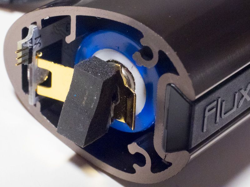

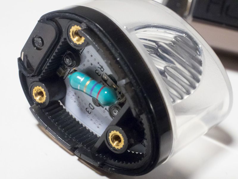

    Now, Steve, just for you...I decided to investigate a bit, and heck, there are only 3 looooong hex screws holding the taillight together (located on the bottom, two visible, one under the fold-out USB plug). So, here's a look inside:
    Below are two views inside the bottom (connection to the USB plug). It's nice to see that the single RCR123 cell is NOT soldered in. I'm not quite sure how to move that metal piece, but it might be easier from the other end.
    Below is the other end of the battery tube (top end). That's a foam block on top of the metal piece. Notice the 3 short straight wires that plug into the head of the light to provide power and on/off/mode selection.
    Finally, below is inside the head of the unit, which appears to be sealed. It's nice to see the brass threaded screw inserts. It's not very apparent from these photos, but there are O-rings for both areas, keeping the unit weather sealed.
    So, there you go. It looks like replacing the internal battery is definitely doable. Of course opening it like this might void the warranty, but that will probably have expired by the time you find it necessary.
