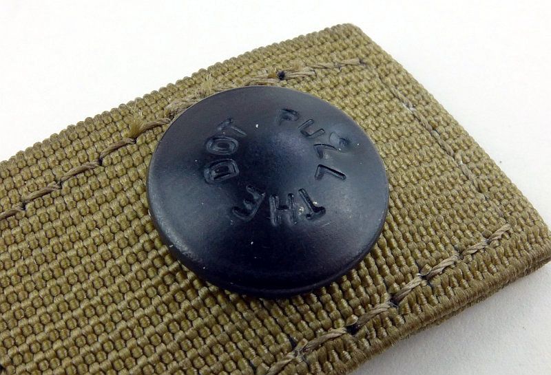

Taking a moment to have a closer look at the accessories. The press studs used on the mount are military grade, and will only open when pulled from the direction indicated by the dot.
And the reason it only opens at the dot is that the retaining spring ring is fixed on one side (unlike standard press studs where the ring is generally free floating).

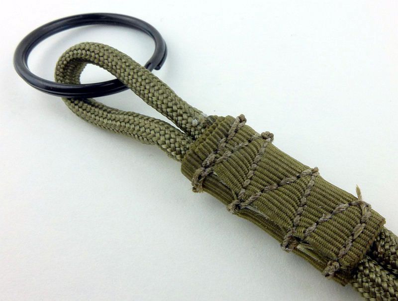

The braided cord lanyard is strongly reinforced and stitched together.

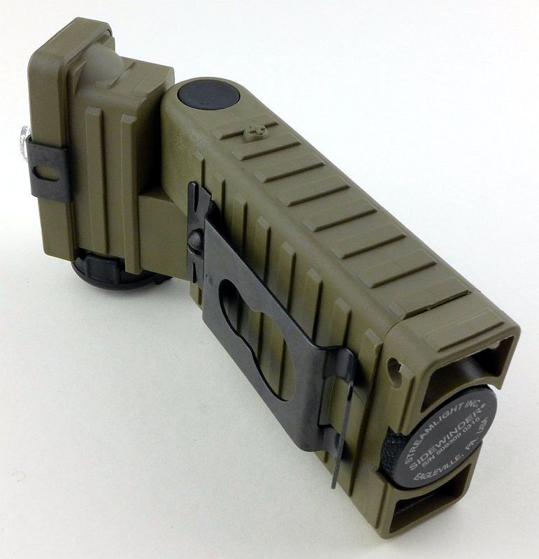

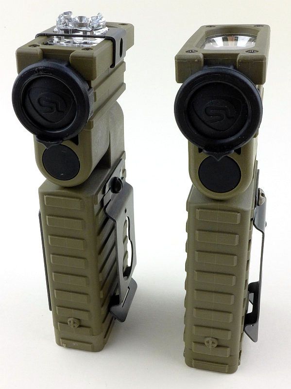

The Rescue is shown next to the older Sidewinder Sportsman model I reviewed in 2012. The body is the same, but there are two additions. The sliding diffuser and a mounting plate (on the opposite side to the clip).
Another view of the Sportsman and Rescue models.

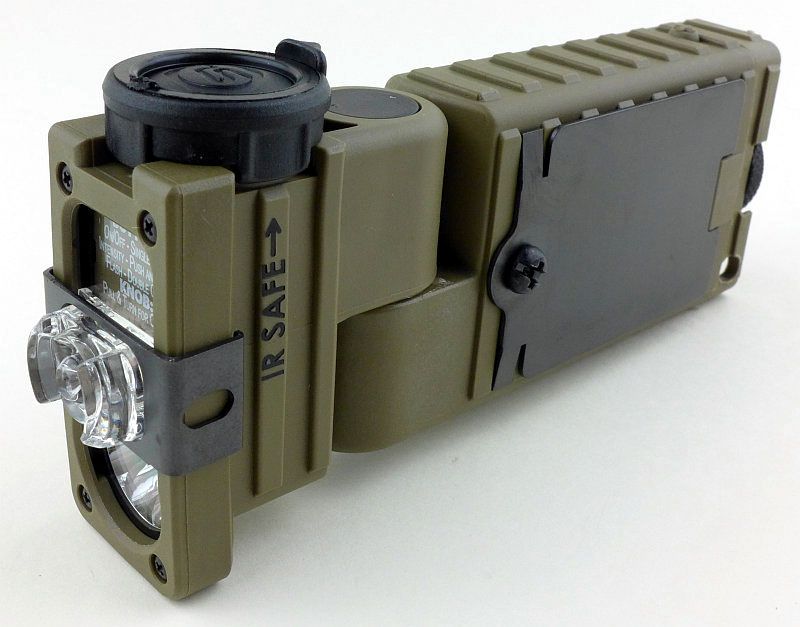

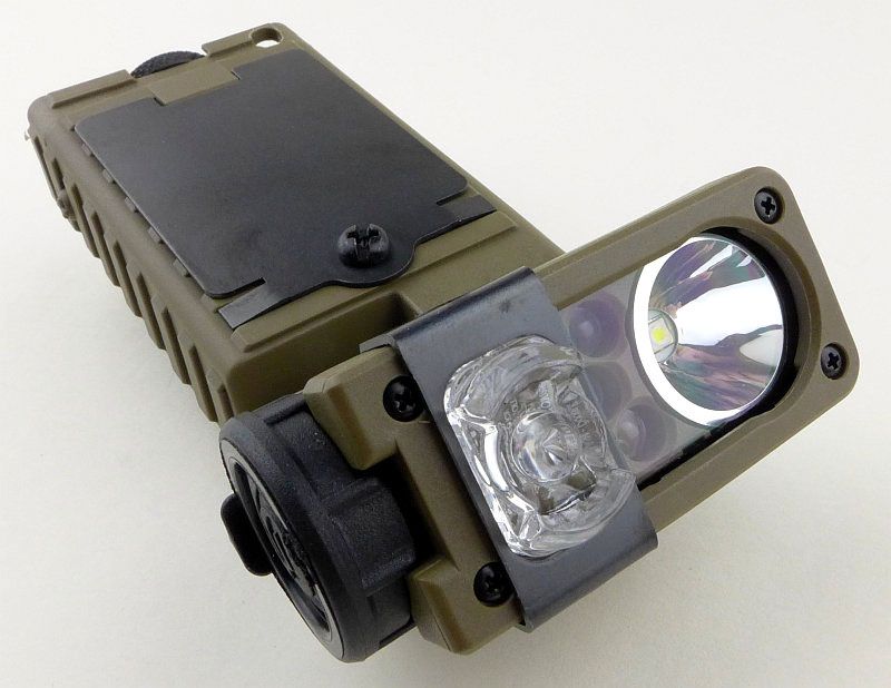

The new aluminium mounting plate on the side is clearly shown. This is intended for the user to glue on whatever fixing material they want to (Velcro or similar) and can be removed by taking out the screw.
The head is angled over and you can see the 'IR safe' setting which selects the blue LED. On the thumb screw you will find the serial number and main model designation (Sidewinder).

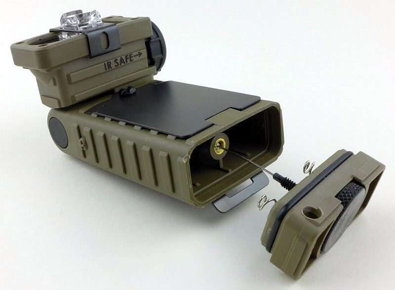

Unscrewing the tail-cap thumb screw allows the tethered tail-cap to come away to give access to the battery compartment.
Inside you can see the physical reverse polarity protection incorporated into the contacts.

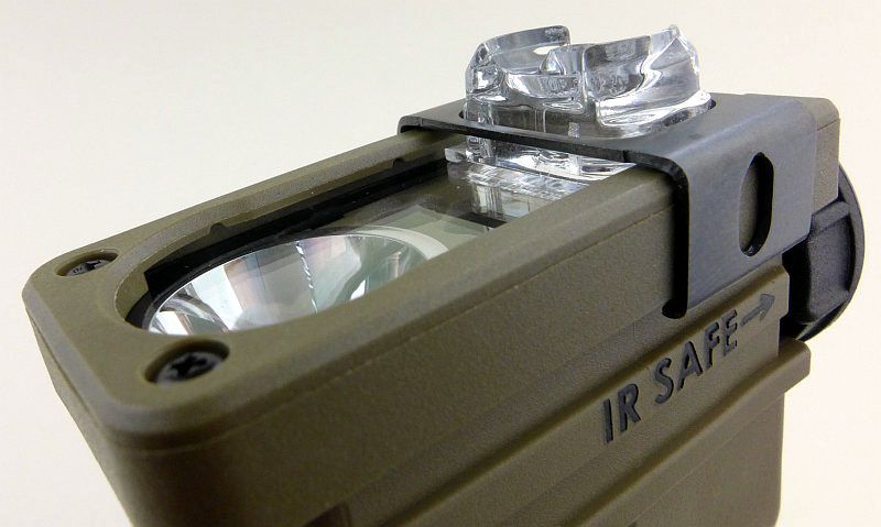

The new diffuser has three positions it can be set. Starting in the 'out of the way' position here where it is not over any of the LEDs.
Now positioned over the coloured/IR LEDs.
And finally over the white LED.
If you look inside the rim of the head, you will see two of the indent positions that the sliding diffuser clicks into.
Two things are shown here, the first is the way the diffuser covers the coloured LEDs, and the second is the main white LED which Streamlight simply designate as C4 not publishing the actual emitter used.
With the diffuser in this position we can see the coloured/IR LEDs and the way the diffuser covers the white LED.

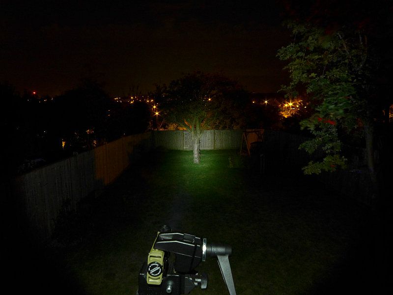

The beam
Starting indoors, you can see one of the criticisms of the Sidewinder is that its beam is not the cleanest or most refined. There is a definite hotspot with relatively dim spill.
Outside, despite its limited output, the Sidewinder's hotspot gives it some range.

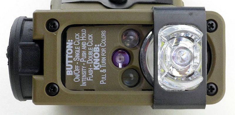

Modes and User Interface:
For the original Sidewinder a claim of "20 flashlights in one" was made, which refers to the set of five modes that are repeated for each of the four emitters. However with the sliding diffuser this is now "40 flashlights in one" as each mode can be diffused or not.
Each emitter has Max, High, Medium, Low and Flashing modes available. For the Rescue model on review, the Sidewinder turns on in Low and has Red, Green and IR coloured LEDs.
See my original Streamlight Sidewinder Review for a photo showing the LEDs of the Sportsman version all lit. The Sportsman also turns on in Max output.
To change output level, the rubber dome switch is held down to cycle through the levels and follows the sequence Low -> Medium -> High -> Max -> High -> Medium -> …… so unlike many lights it ramps up and down and does not jump straight from Max to low.
A quick double-click enters the flashing mode which is set at Max output.
Surrounding the switch is a selector ring for the emitter. This must be pulled up, rotated and dropped back down to lock in the selection. The emitter can be changed while the light is in any mode without changing the output level or mode. Two hands are needed to change the emitter and the selector ring has a raised section to allow for tactile LED changes.

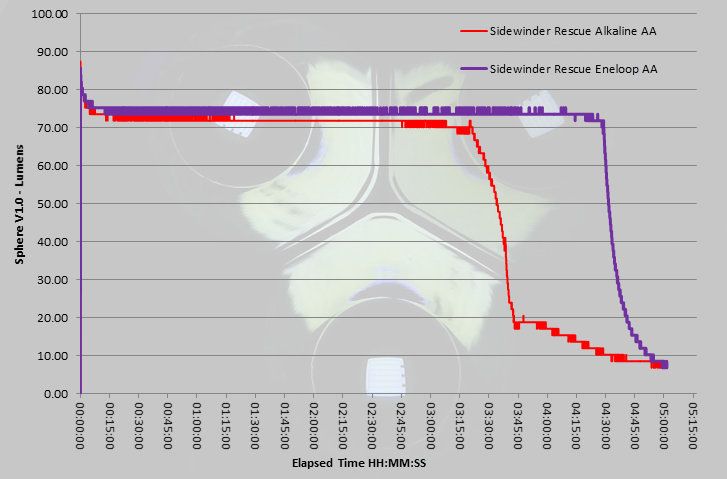

Batteries and output:
The Sidewinder Rescue runs on 2x AA – Alkaline, NiMh or Lithium AAs (NOT 14500).
This is a very large table as it includes diffused and non-diffused outputs. I cannot measure the IR output, so that is not included.

Peak Beam intensity measured 2000lx @1m giving a beam range of 89m.
There is super low parasitic drain of 0.1uA. At this drain it would take 2167 years to fully drain the cells!!!
In this trace you can see the relative performance using Alkaline and Eneloop cells. This is actually the most similar performance between Alkaline and NiMh of any light I've tested as normally the Alkaline output is significantly worse. Though the NiMh does win on overall runtime and maintains regulation a little better, the Alkaline output is perfectly good and just comes up short on output at the end of the runtime. By ANSI standards, the runtime is actually the same, but the Alkaline dims earlier than the NiMh.
