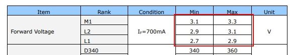

    Another interesting observation for levels up to 25 ma at 1000 ma setting - that is, 1-4 level flickers, 5 does not flicker, 1 and 2 levels go out on their own after a while, and they all go out if I am outside in cool weather. When turned on, a flash is visible, but there is no further light. My friend suggested to me that most likely the extinction is due to the parameters of the diode, in the cold, the resistance of LED increases and the current current is not enough for ignition. I tested it in a freezer (-18 C) at level 3 (12 ma), which burns well indoors and then at level 4 and 5 - nobody turns on, only a faint first flash is visible, but when I put it in warm water, it starts to shine again.
    Maybe this is due to a specific instance of the LED?
    I have XML2. For example, Nichia indicates in coils voltage grades, Cree does not indicate it, I did not find this in the datasheet, but it is quite possible that the Cree have a similar spread of characteristics, and if there is a coincidence of an inappropriate diode and cold weather, it will go out on small current.
    Or it may be due to the fact that in the driver itself, because of the cold, something freezes and it does not produce the current that it should?
    Or does both the LED and the driver freeze?
    it would also be nice to move the setup steps 14 15 between 4 and 5 steps, so it's really more convenient than going through all the steps if you just want to change the memory type and velocity
