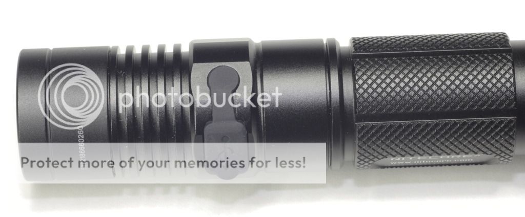

The MH12NW has a black HAIII hard anodized finish over an aircraft grade aluminum body like most of Nitecore's selection. The finish is not matte, but it isn't very reflective. My sample came without any scrapes or chips. The finish was clean and in perfect condition.
the body of the MH12NW has moderately aggressive knurling on the body and around the tailcap. The cuts form small diamonds. The MH12NW is pretty good at anti-roll by itself, but if you add the belt clip and/or the tactical ring, the anti-roll is perfectly effective.

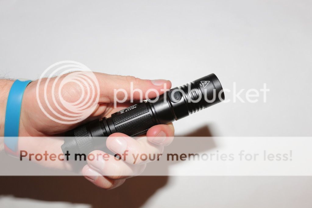

Overall gript is very comfortable and doesn't feel like the light will slip out of your hand, regardless of the fact that it is just a tube. Adding the tactical ring helps with gription but is not the most comfortable unless holding cigar-style. Adding grip tape makes this design even more perfect! I don't feel that I would drop this light.

The MH12NW can be recharged with the USB charging port on the opposite side from the mode button. Open the flap, and you can plug in the included USB cable to charge the light from a computer, or a USB wall/car adaptor. When you plug in the light, make sure to turn it on for it to charge.. When the light is charging, the mode button will be solidly lit up. When the light is finished charging, the mode button turn off.

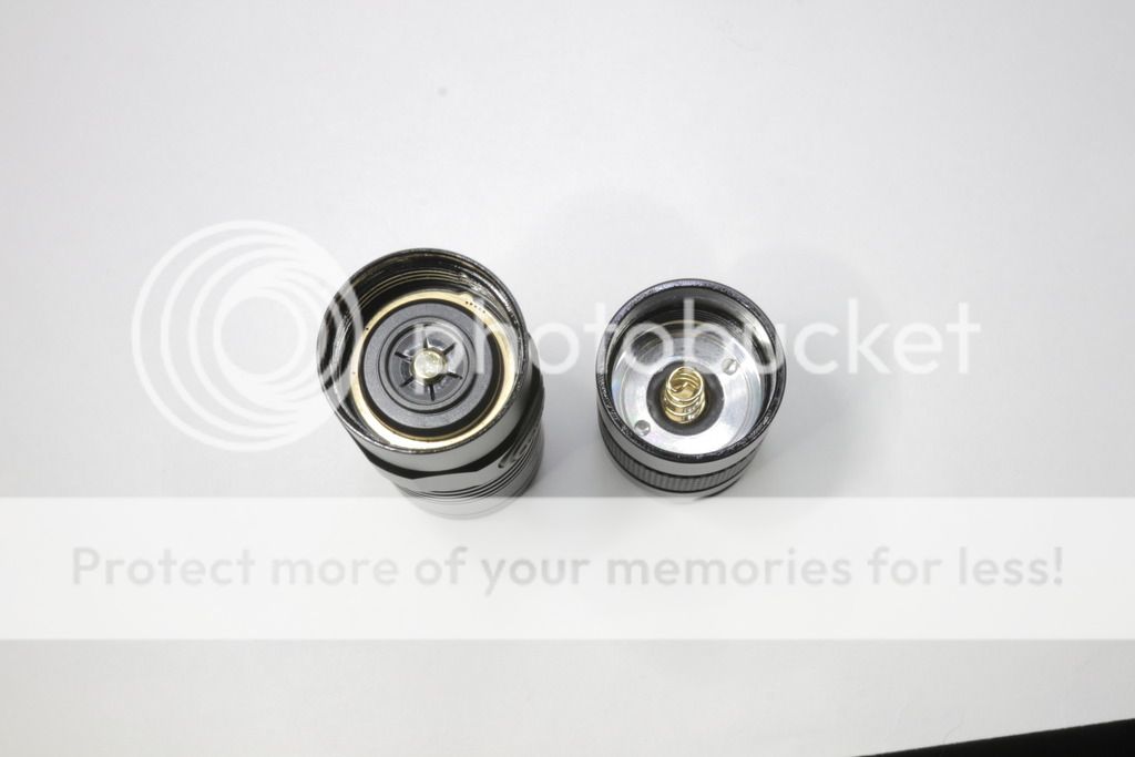

Both ends of the battery compartment feature a spring to dampen impact of inserting batteries.

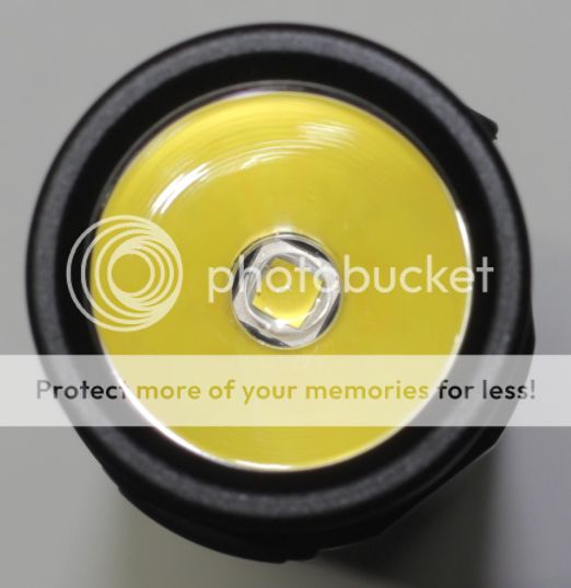

The New CREE XM-L2 V2 Emitter is domed, meaning that there is a dome over the diode which helps to spread the light to the reflector
The MH27 also features a smooth reflector which produces better throw than an orange peel reflector would, but the beam pattern is slightly rougher than it would be with an OP reflector.

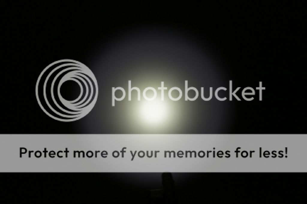

In the beam shots below, notice the tint, it is what my eyes see.
ISO 100, f/3.5, 1/60
ISO 100, f/3.5, 1/250
ISO 100, f/3.5, 1/2000

The MH12 is built incredibly! I love the 1 inch diameter and ~5.5 inch length. The profile of the flashlight is perfect for my needs because it is comfortable to hold and easy to use. The design of the forward clicky button to be used as momentary or constant on is great. Partner that with the mode button on the side and you have a fantastic user interface. I like having the two separate buttons to control the light; one for activation and one for mode cycling.

The only negative I can find with this light is the USB flap being easy to open. Of course this is great if you are wearing gloves or just want to simply open the USB cover without trouble. The downside to this is obviously the possibility of you inadvertently opening it without knowing.

The USB flap is easy to open. I am slightly worried that it could be accidentally opened

DISTANCE BEAMSHOT
The MH12 has great throw for a 1" diameter light powered by a single 18650 with an XM-L2 U2 LED. The first fence is around 30 meters away. The treeline is around 122 meters away (measured). The image is edited to be almost exactly what my eye sees.
NOTE the tint. The grass is much more green under this tint as opposed to the cool white.
First fence is 80 feet away. 2nd fence is 228 feet away. Far trees are 400 feet away.
Comparison
I walked out to the furthest back fence while the light was shining from the deck where these images were taken, I definitely had a useable amount of light.
The pictures do not show it, but all of the trees in the far back are illuminated. The branches and trunks are lit up clearly and easily seen. Dark colors such as the black fence are hard to see, but anything else is lit up clearly.
