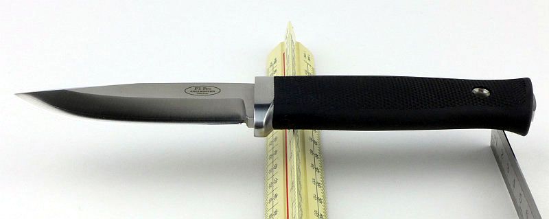

    Using a set of gauges and precision measuring equipment including a Vernier protractor, callipers, fixed radius gauges and the unique Arc Master adjustable radius gauge (the one that looks like a crossbow).
    These measurements have been tabulated and are presented along with a few reference blades (8" Chef's Knife, 5.5" Santoku and the popular Fällkniven F1).
    Key aspects such as the primary bevel angle, grind type, blade depth, blade thickness, length, weight are detailed, along with balance information.

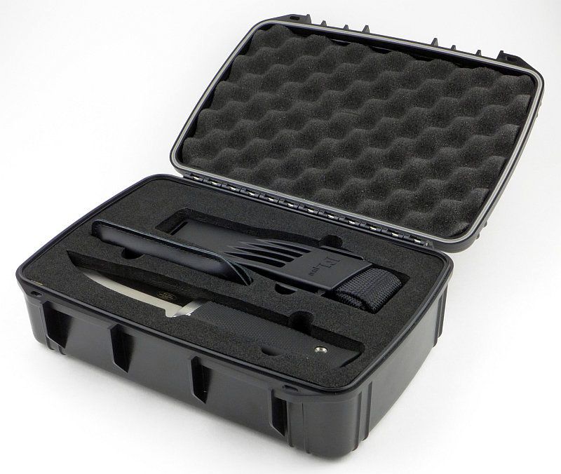

    In keeping with Fällkniven's normal product packaging the F1 Pro arrives in a white cardboard box.
    I like the Swedish sense of humour as this is the first knife I have received which came with a supply of Fällkniven branded sticking plasters.
    Inside the cardboard box is the tough, waterproof, plastic case.
    Opening the case you find the contents nicely organised.
    The liner is a substantial closed-cell foam with finger cut-outs to make it easy to remove the items.
    You have the F1 Pro knife, its sheath, the DC4 stone and a case for the DC4.
    You can buy the DC4 separately, but in keeping with the uprated features of the F1 Pro you get this great stone with the F1 Pro. The gold side is the one with a diamond coating. With harder blade steels, the diamond makes it much easier to achieve a good result while not taking too long.
    Flipping the DC4 over, it has a ceramic side which allows for a finer finish once the diamond side has done most of the work.

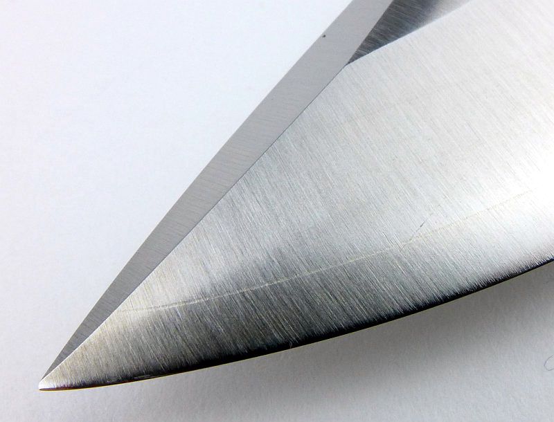

    Taking a close look at the tip of the blade. You can see the line where the outer and centre steels join.

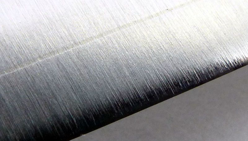

    Looking closer still at the lamination join and cutting edge. Where the steels join it appears as if it is slightly softer as during the finishing processes the line has become slightly recessed. This is not a problem, just an observation.

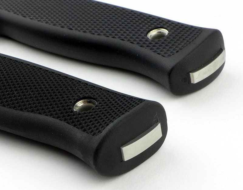

    As with the F1, the tang of the F1 Pro is exposed at the pommel.
    A flared tube is used for the lanyard hole and also secures the grip. The flaring of the tube not only keeps it in place, but also means the lanyard hole has no sharp edges that might have frayed the cord.

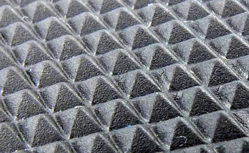

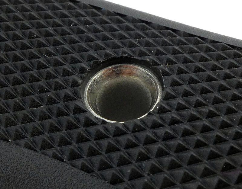

    The sides of the handle have a moulded diamond knurling pattern.

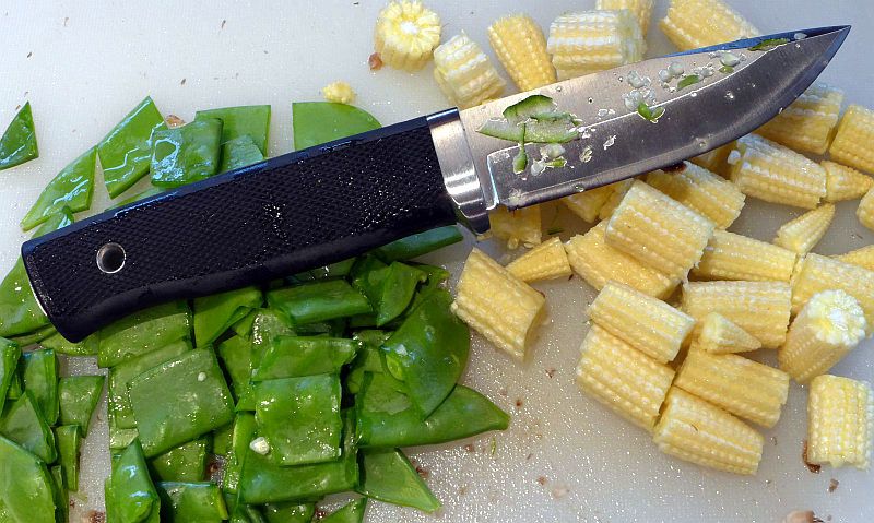

    I thought I would give it a try in the kitchen as well to see what its food preparation capabilities were. A blade this thick is always going to struggle a bit with deeper cuts and this test really showed this. Starting with mushrooms, the cuts were easy and controllable, but the slices were bent over and split by the thick blade.
    Moving to a thinner vegetable, it handled the mange-tout with ease and the baby sweetcorn were half cut, half split apart.
    The biggest challenge to the blade thickness was a crisp courgette. Cutting was easy but there was a great deal of splitting once the blade got a little deeper. Altogether though, the cutting was easy, and even if not my first choice for food preparation, the F1 Pro worked well enough.
