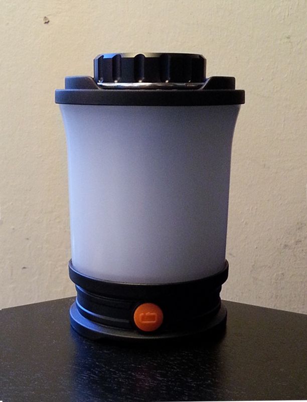

Fenix CL30R Camping Lantern
TURBO: 650 lumens, run time: 4 hours, 30 minutes
HIGH
: 350 lumens, run time: 9 hours
MEDIUM: 100 lumens, run time: 38 hours
LOW: 50 lumens, run time: 70 hours
ECO: 10 lumens, run time: 300 hours
Impact resistance: 1m
Water/Weather Resistance: IPX7
Light: ??? (appears to be the same or similar to CL25R)
Power
: 3*18650 (button-top only)
Dimensions: 5.4" x 3.7"
Weight: 14.5oz w/o batteries
Notes: comes with a trio of Fenix ARB-L18-2600mAh button-top cells, micro-USB cable and spare o-ring. Posted run times are apparently observed using the included 2600mAh cells. Fenix purports run times with 3500mAh cells to be 6h, 12h, 51h, 93h and 400h, turbo through eco. Again, your mileage may vary.

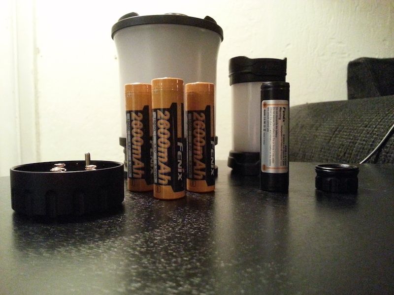

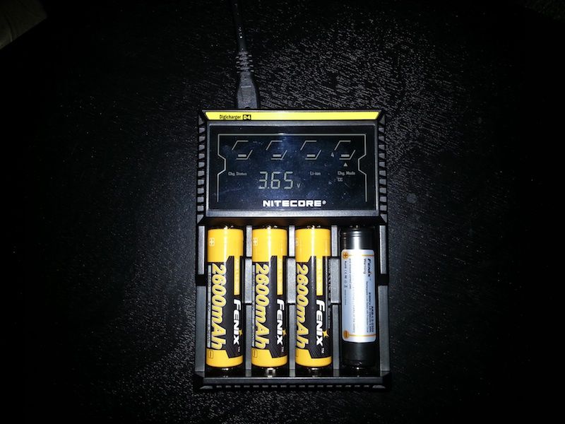

Both lanterns come with Fenix branded protected Li-ion cells. The CL25R comes with a flat-top cell and the CL30R comes with button-top cells (more on that in a moment). Like most people, I feel that Fenix should not have included their own cells and sold these at a lower price-point or at least thrown us a bone and included their higher capacity 3400mAh cells, but I believe they are trying to market these as a turn-key solution for non-flashoholics. Both lanterns feature on-board USB charging and since they include the cells and a cable, you don't really need anything else. I recall seeing an ad for the CL25R in the Outside Summer 2016 Buyer's Guide and there was no mention at all of 18650 batteries, perhaps so as to not scare off buyers by mentioning "uncommon/unfamilar" battery types? Could be worse, at least they're not using proprietary cells like the Goal Zero Lighthouse Mini. :shakehead
None the less, they are good batteries. They arrived at a safe storage voltage and just needed topping off.

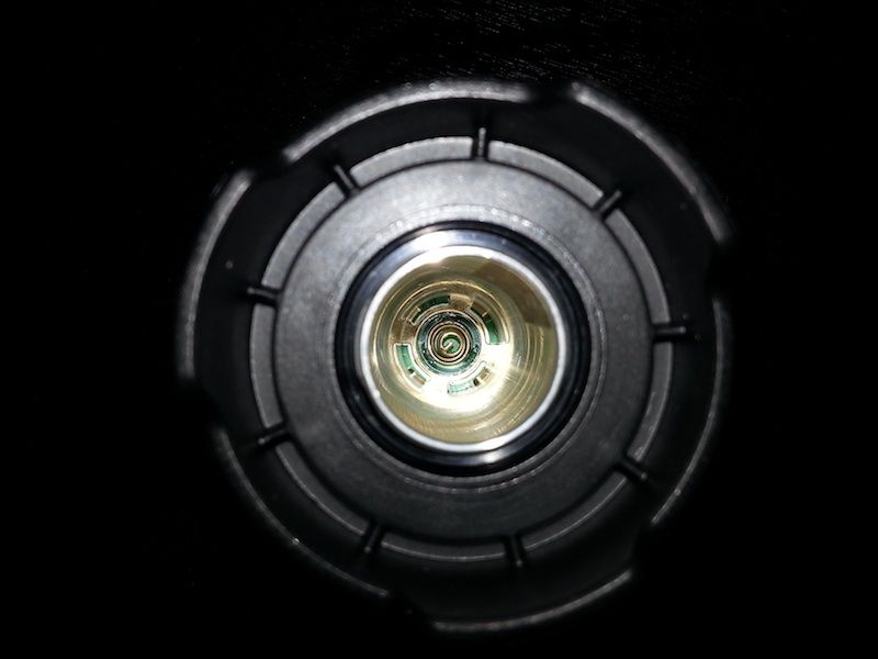

The CL25R's positive terminal has a spring. Both flat-tops and button-tops work just fine. I haven't tried it with CR123As, but I can't imagine any conceivable issues.

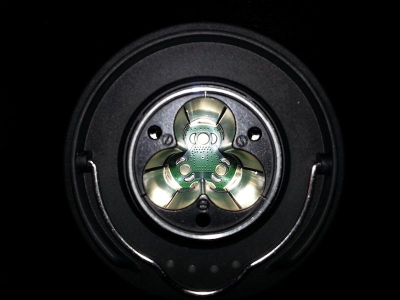

The CL30R's positive terminals are slightly recessed and obviously designed for use with button-tops. Fenix states that charge/discharge functions will only work with button-tops. I tried inserting a protected flat-top cell and couldn't power the lantern on at all. Fenix states that you can use CR123As, but they don't recommend it (probably because of the discharge feature). Again, I have not tested it with these cells. Looks like button-top protected cells are your only realistic option. The upside is that since they're in parallel you can run it off of 1 or 2 cells if you need to, so you can scavenge a battery or two from it in the field for other things if need be.

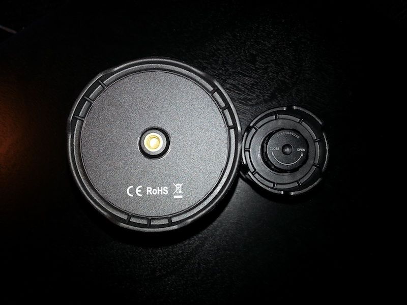

Both lantern's can be charged via USB, but only the CL30R can charge other devices. The CL30R has it's USB charge and discharge ports on the lower rear. The CL25R has it's USB charge port on the top. Both lanterns have silicon plugs to protect the ports. Note how much thicker the plug is on the CL30R, which I think explains the slightly higher liquid infiltration rating.
Both lanterns have a tripod socket on the bottom so you can set it up "street lamp-style" on a standard tripod in camp or raise it up off of your picnic table on a Gorillapod-style tripod. The CL25R also has a magnetic base, the CL30R does not.

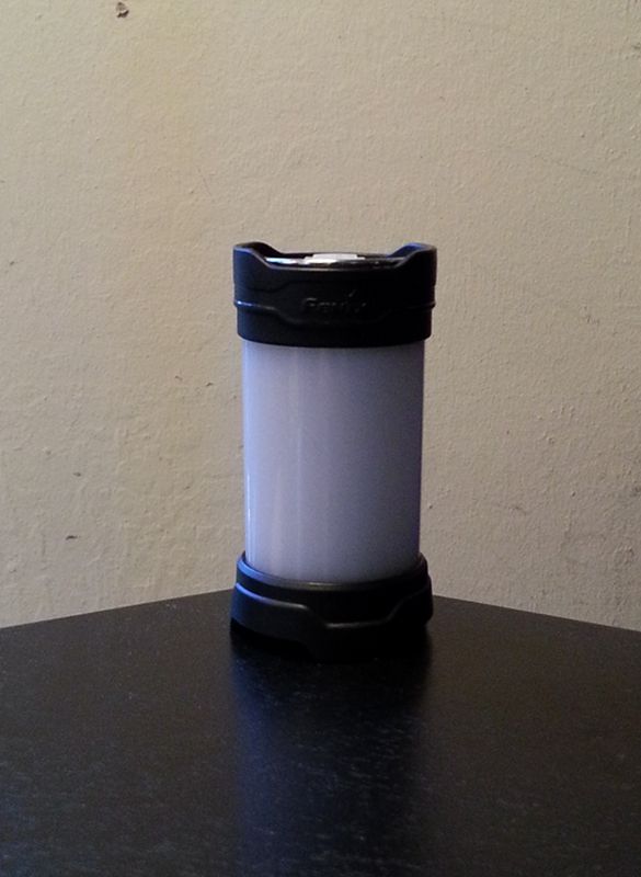

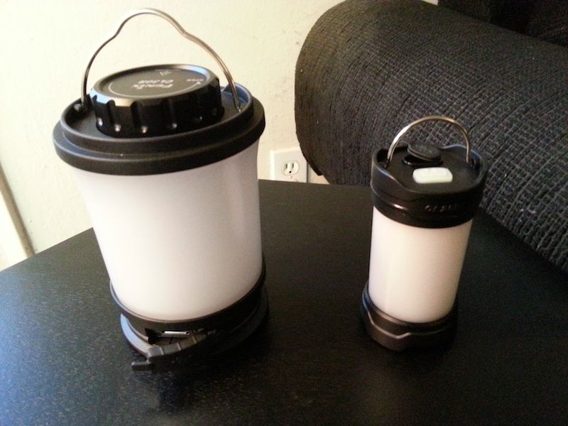

How are they similar?
-Both produce an ample amount of beautiful, neutral white light. When playing around with these indoors, I was surprised at how well they lit up various rooms, even in the lower modes. Color and depth were comparable to my household lighting. Very pleasing light to work in and I'm sure they will not only come in handy camping, but at home during a power failure as well. I didn't get the "creepy" feeling I sometimes feel when I'm playing around with cooler white lights indoors and no other lighting. Plenty of light on the higher modes and not hard on the eyes, unless you look directly at them.
-The light distribution from both lanterns is excellent. Unlike most lanterns in the "traditional" design in which most of the light is projected outward, these Fenix lanterns also project a lot of light both up and down with barely perceptible dead spots directly above and below. I tried hanging them from the ceiling indoors and you get a lot of light down towards the floor, as well as tons of ceiling bounce which should make them handy in an emergency. For camping, you probably couldn't go wrong almost anywhere you place them; on the table, hanging from a tree or inside your shade structure, etc. In the case of the CL25R, you can even affix it to a metal object, such as a bear box.
-Both run on 18650 protected cells, which we all have at least a few of right? Both can be charged via USB from your vehicle, a power pack, your laptop (if it's an emergency), etc.
-Both have a socket for a standard tripod, adding to your placement options. Both have a folding wire bail for hanging as well.
-Both are compact in size and comparitively light for their output.
-Both feature a "cold-resistant" battery compartment. Not sure how this works, but I suppose it has to do with the batteries being in the center of the lanterns, near or surrounded by the emitters and the heavy metal caps for the battery compartments? I will say that the threads were a bit dry and could have stood a touch of grease from the factory.
-Both have a battery status indicator and low voltage warning.
-Both have a versatile and intuitive UI. Hold the power button for 0.8 seconds to turn on or off. Tap the power button to cycle through modes from lowest to highest. Flashing modes are accesed in a similar fashion:
CL25R: While on, double tap the power button to access the red mode. Single tap to toggle between steady and flashing. Double tap to switch back to white mode.
CL30R: While on, double tap the power button to access the flash mode. Single tap to return to steady mode.

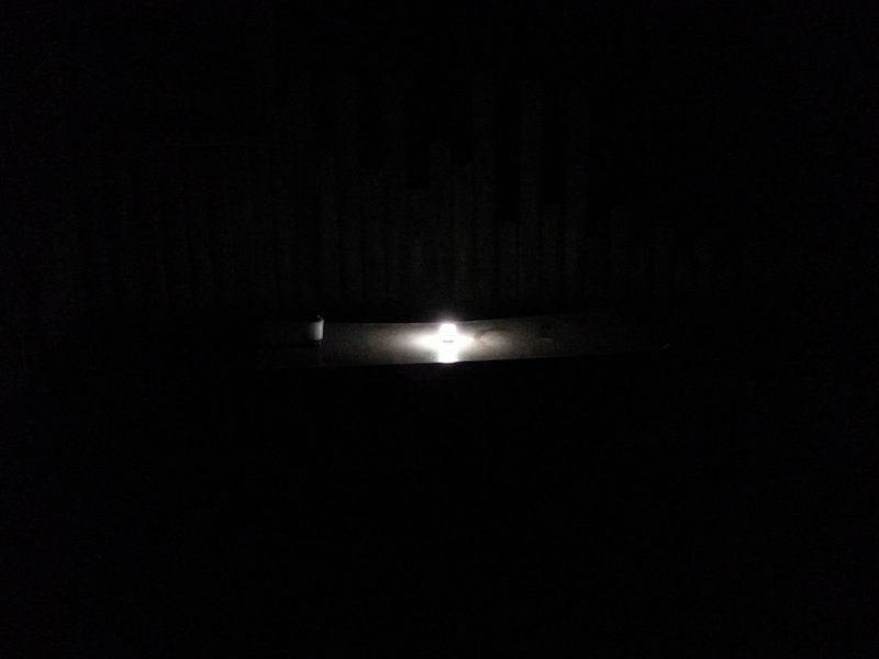

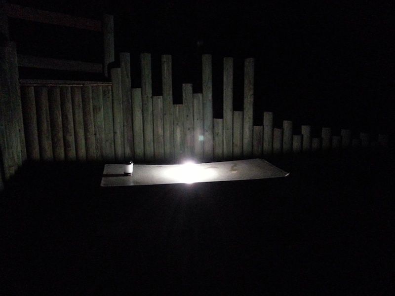

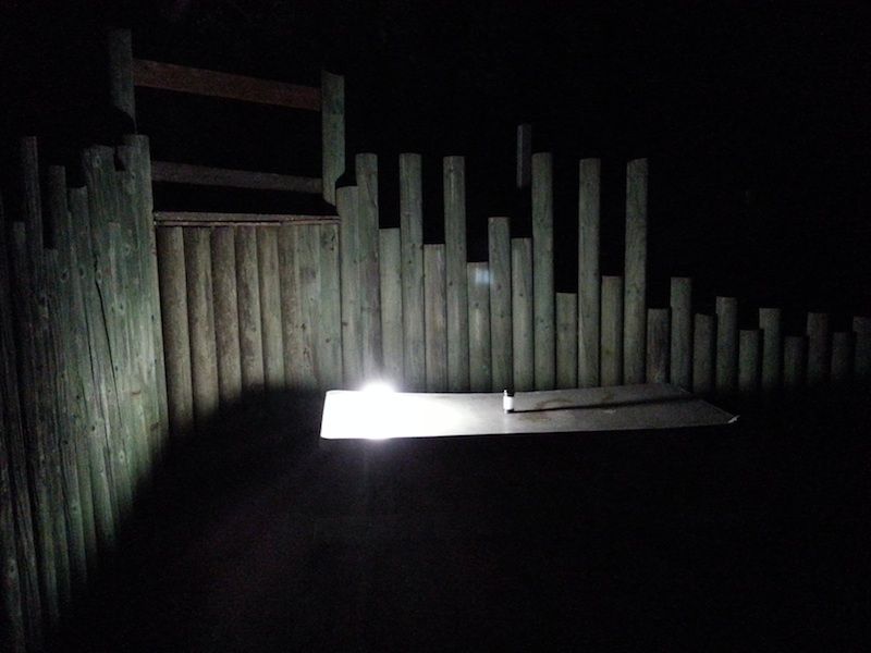

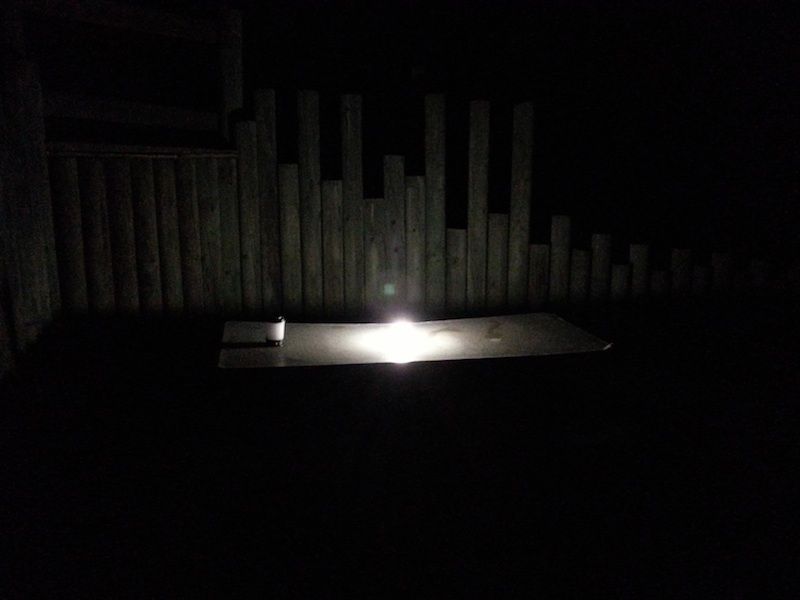

Now let's look at some beam shots:
CL25R moonlight
CL25R medium
CL25R high
CL25R turbo
CL25R red

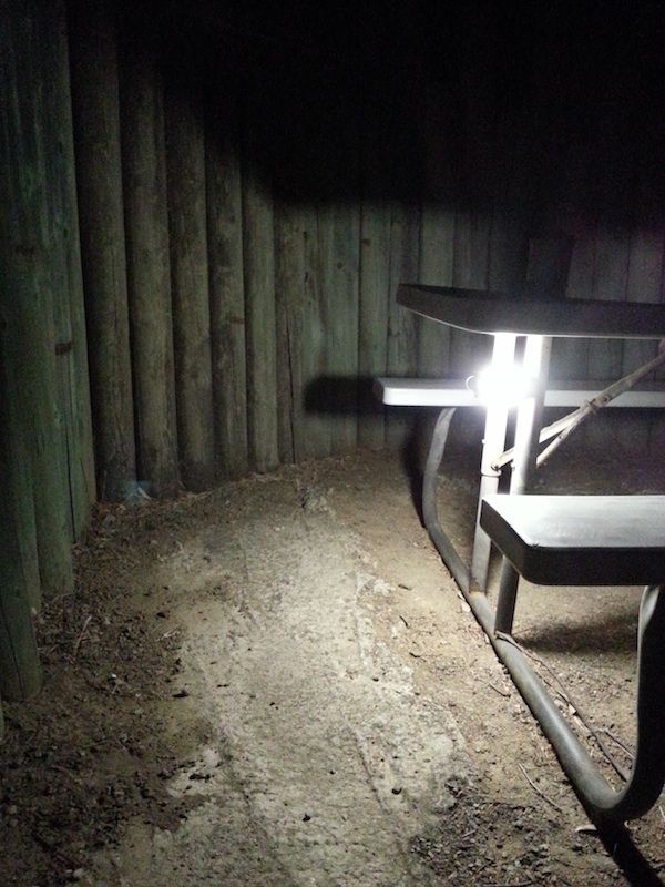

CL25R magnetic base in action. Note the detail observed on the ground. I love this NW light!
CL30R eco
CL30R low
CL30R medium
CL30R high

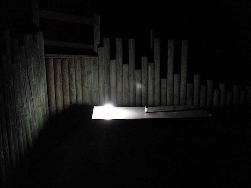

CL30R turbo; note that the railing above the retaining wall on the upper left is illuminated. This lantern is bright!

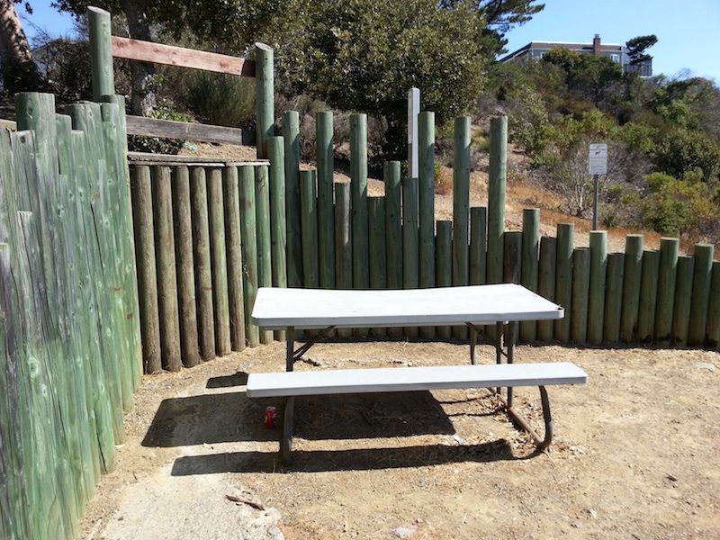

Daytime shot for general reference.
Conclusion: Despite some flaws, I really like both of these lanterns. Either may be a bit too pricey for some, but I stand by the adage that you get what you pay for. If you're the type to do your own mods, you can probably do the same or better for less with a cheaper lantern. However, for turn key solutions and fans of Fenix these lanterns are where it's at. So which one is best for you?
CL25R: If you prize light weight, portability, power and "duel-fuel" options then this is your lantern. It should make a great backpacking lantern for all but the most fussy ULer.
CL30R: If monstrous run times, a charging station, an excuse to have extra batteries on hand "just in case" and the occasional period of high intensity output is your thing, then this is your lantern. It definitely a car camping lantern and quite adequate I feel. The question has been asked before that wouldn't be more practical to just have two CL25Rs on hand? It depends on your needs. Two CL25Rs cost more than a single CL30R and you will have less run time, plus you may find the 650 lumen mode to be handy. Just don't run it on this mode for too long!
