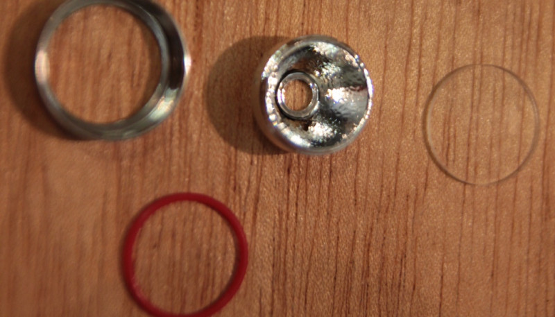

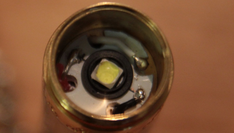

Reflector is expectably shallow, OP with XP-L V5 inside.
Machinery is perfect.

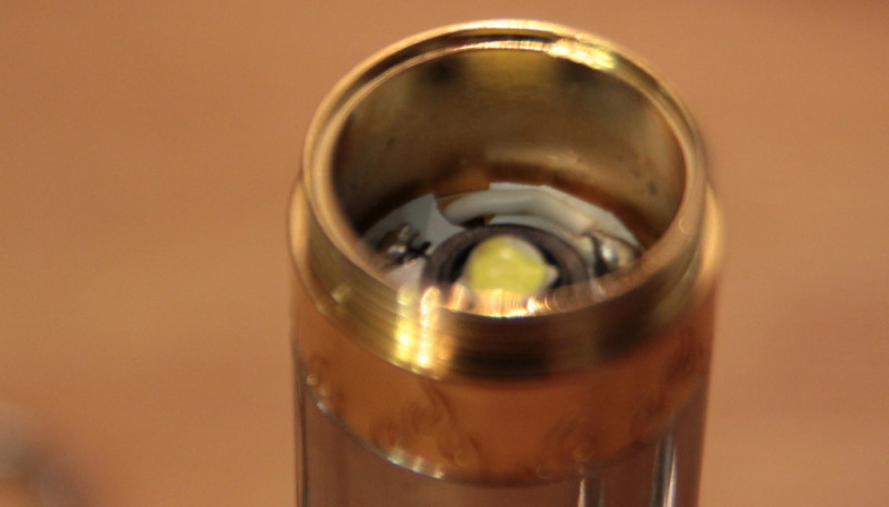

I couldn`t disassemble tail, but easily did this to head. Bow to the golden copper tube, folks. it shines,looks nice and dissipate heat.
